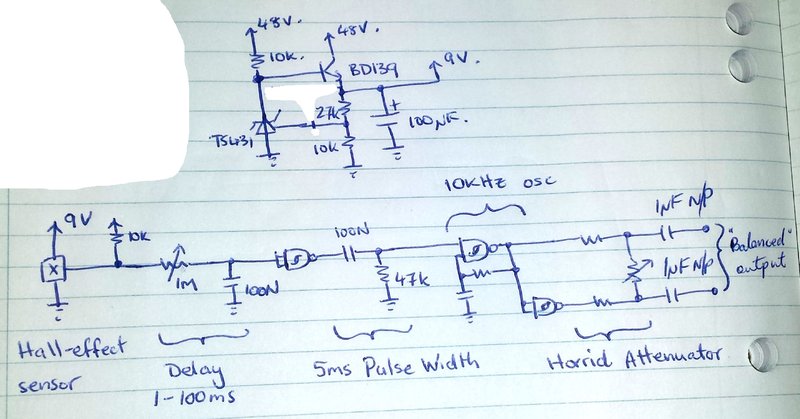

1V audio burst every OTHER pushbutton
also, this is for live sound, so unfortunately i won't have the luxury of the studio environment to go back and fix problems... gotta have a real-time solution, and something which is super easy to set up and calibrate because the occasion is ten grand pianos and i get very little sound check time!
i like this option because i don't have to burn another channel for each piano which already will have a low, a left, and a right channel. i actually built a mechanical prototype last night of what i need to accomplish, but it is very clunky and likely to fail. and electronic solution would be must easier i think...

ak, thats a great idea... i didn't realize that it was a square wave. do you mind redrawing the circuit for me the way you'd put that in there? i have no clue how to add such a thing to this circuit

that's the plan! now i have to figure out how to build a prototype of this circuit. i have no technical friends of your kind who could help me out in real life, so that's why i'm on here... would somebody be able to compile a list of parts i'd need to get? i think if i had the exact parts and a circuit drawing, i know someone who could at least help me assemble it. i really appreciate everybody's help so far!
OK new idea everyone! Is there a way I can use the 48V Phantom Power from the mixer board to power this thing? Instead of a battery? The mic i'm using is dynamic and doesn't care whether the phantom is on or off...

Yeah it needs to be combined with the incoming mic signal... I've got ten pianos to mic in this fashion, and I can't spare 10 extra channels just for the compressor key in. So I don't know which mic I'll be using, but let's say it's a Shure SM58 just for now. That mic ignores phantom power, and it is usually fine to Y together with other mics without too much loss in quality. So how best do I combine the SM58 and the burst signals, running the burst device from the Phantom Power, and assuring that the burst is at least 30dB louder than the max mic signal when the piano is being played loudly?
Let's assume the 5 Vpp (volts peak-to-peak) signal is a sine wave instead of a square wave. 30 dB below that is 5 / 31.6 = 158 mV. Divide by 2 for peak volts, and divide by root 2 for RMS, and you get a maximum microphone signal of 56 mVrms to meet your conditions. So, what is the SM58 output when a piano is being played loudly? This goes back to post #25 about filtering off the high freq harmonics and attenuating the squarewave amplitude. Maybe no attenuation needed. AG probably has this in his head...
Changing the 4093 to a 40106 gets you six inverters instead of 4, and you need a 5th one to create the opposite audio phase for summing into a balanced signal pair. Adding a signal diode takes care of gating the oscillator.

I don't know all the electrical parameters, but I do know that the max level i'll ever need from the burst is 1.4V rms. So i figure if i have a pot that goes from zero to 1.4V rms, i'll just play with it until it outputs what I need...?

Dougy, if it isn't too much trouble, would you mind re-sketching that diagram for me with the added 48V power usage, the low-pass filter necessary to sine-ify the tone, and the appropriate pinouts for summing into a balanced mic signal? Am I missing anything? I'd really appreciate it!!
Sure, it's not much trouble. I can draw you the circuit with balanced output, but I don't know how well this will add to your existing mic output (do you know its output impedance? Is it 600 ohms?). The output impedance of the circuit below changes with the volume setting (which may not be an issue at all).
Using cabled 48V may introduce hum. A 9V battery is better for this reason.
Note: my u and N might look similar. The caps are labelled with 100N, 100uF and 1uF

thanks!! so is that extra bit of sketching the 48V option? I literally know nothing about what you just drew out, but it seems that the circuit is built around a 9V input either way, so I can use a 9V battery or have the 48V option drop it down to 9V for the remainder of the circuit anyway? And what would the max RMS voltage of the output be with the pot all the way up? (I am no doubt showing my absolute ignorance here...)
