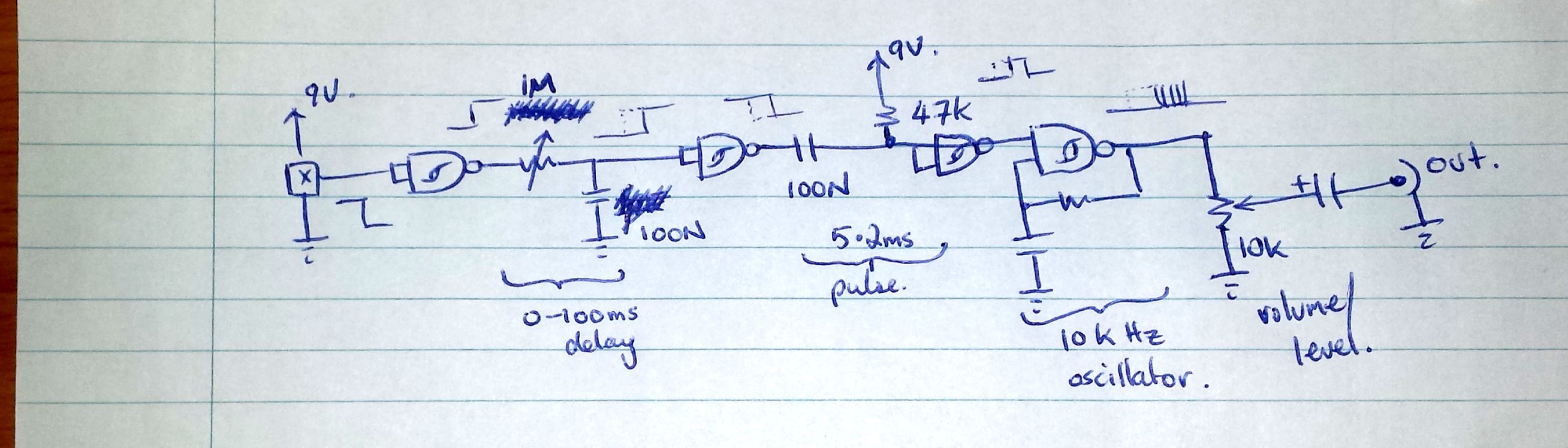

So basically, to sum it all up with some adjustments as I learn more about this on the fly,
I need to build a circuit which emits a 5ms 10kHz tone at an adjustable output voltage from 0-1.5V and has an adjustable delay from 0-100ms, triggered solely whenever a 9V battery input through a hall effect sensor drops from 9V (or any voltage?) to zero.
How does one go about designing such a thing??
Yes, it's simple. Here's a schematic. Hall-effect sensor is the rectangle with a cross on the left. The gates are from a single CD4093 logic IC.

thanks, i have zero clue what that means, but i will try to figure it out! i really appreciate you taking the time to draw that up for me.
A problem is that your compressor has an "attack time" from when it is given the 10kHz beep to when it actually cuts the 10kHz. So the 10kHz will be heard.
Another problem is that your lowpass filter is not perfect, it reduces the 10kHz and all other high frequency sounds from the piano, it does not stop it. So the 10kHz will be heard.
Therefore I think you should mute the thump with a mechanical, optical or magnetic switch.

EDIT: It might cause damage if you use a Y-cable which will inject the high level 10kHz into the microphone and overload the mic preamp. A separate input is needed on the mixer for the beep.
All valid concerns of course, so I tested this out already on my yamaha cl5 console and with an attack of zero on the compressor and a low-pass at 100Hz, the 10kHz tone can't be heard even when it is near clipping the mic pre.
