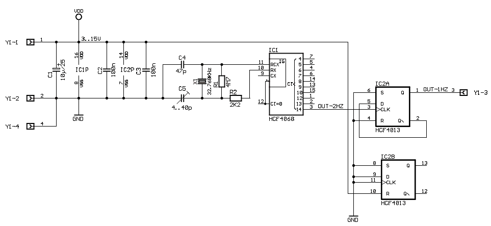

I am in the process of building a binary clock and realized that i need a good 1Hz signal that i just cannot get from the 555 IC I found this schematic and was wondering if it would work and be worth building I dont want to program any chips and i tried pulling the clock PCB out of a wall clock but that didnt work. this schematic seems easy enough to follow and was wanting some input on it.

Hi HillbillyxX,
a clock normally has nothing much to do much with military precision, which is waaaay off in many cases.
Here is a circuit providing an accurate 1Hz signal if the oscillator circuit is tuned precisely. The frequency of 32.768KHz is most commonly used in wrist watch circuits and is fairly accurate if the watch is worn day and night for least temperature changes - hence crystal frequency changes.

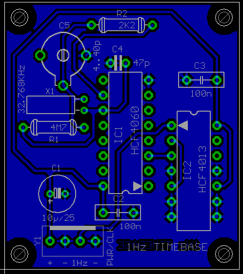

The PCB just requires 1.55X1.7625inches.
To maintain precision the circuit should be kept at constant temperature (e.g. arm pits
If you want to build the circuit as shown please PM me for the Eagle files - free of course. What else?

That circuit should do what you want.
Why do you suggest a circuit using one more IC than my suggested one?
There is not even a part allowing precise clock frequency adjustment.

Yes, Please PM me the eagle files! But will this trimmer cap work? and why do your resistors in the schematic and board say 4M7 and 2K2? is that a 4Mohm and a 2kohm or a 4,000,007 ohm and a 2002ohm? Cuz i read that as "two thousand two" and "four million seven". I may just be an idiot but i have not ever seen it like that before. sorry for all the questions.

PMing any files is impossible. You will have to inform me about your email address for the files, which can be attached to a mail in any format.
4M7 means 4.7MΩ = 4,700,000 Ohm, 2K2 means 2.2KΩ = 2,200 Ohm.
It would be kind of nonsense to have a resistor with a value of 4,000,007 Ohm. Even a 1% tolerance 4M7 resistor might have a value of 4,747,000 Ohm or 47KΩ below the nominal value.
The trimmer cap has enough capacitance to compensate for crystal inaccuracies.
