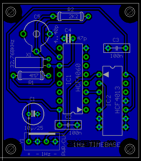

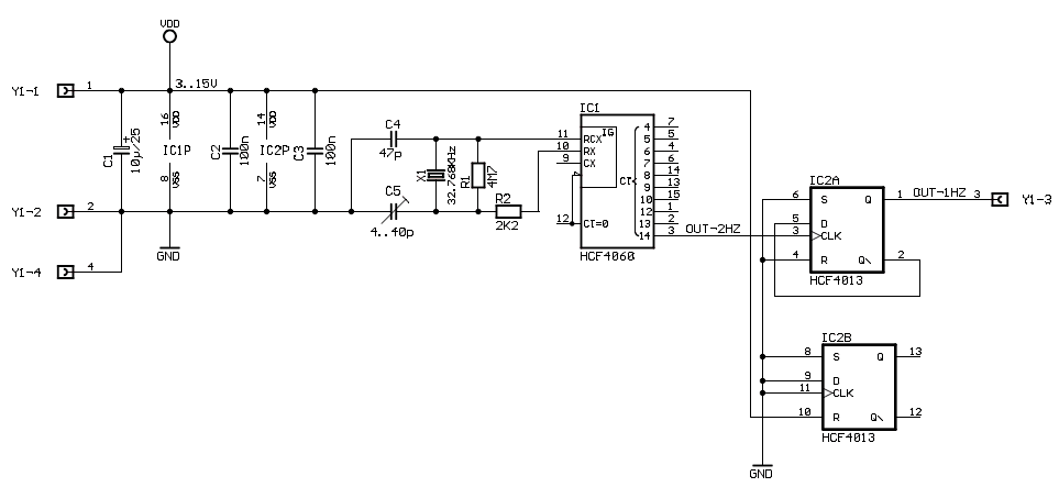

Here's a 1Hz time base.
Adjust it to exactly Hz output with the trim cap.
Boncuk

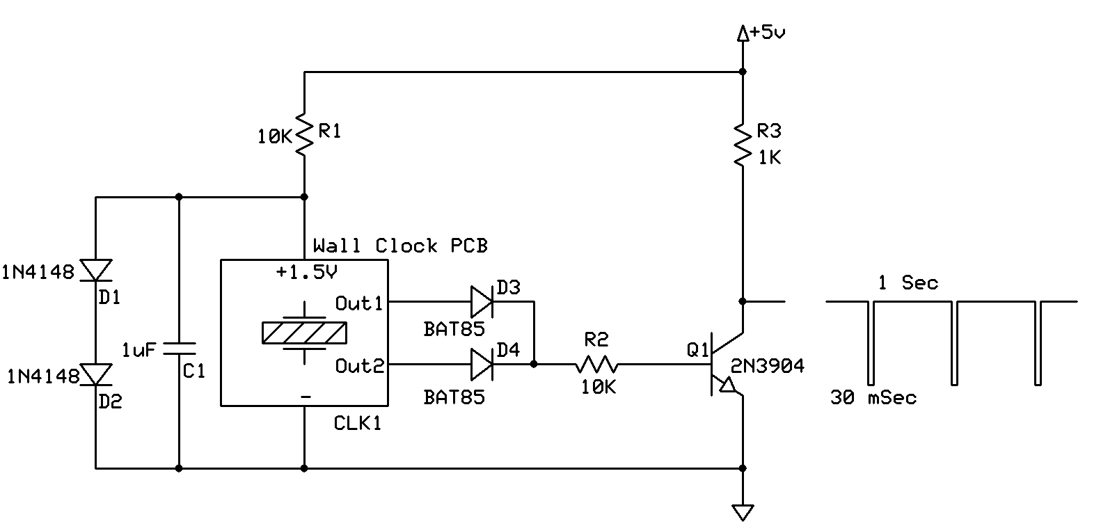

Can't see why you don't just gut a battery wall/desk clock module. Dirt cheap and accurate enough that I have only reset them for daylight saving times shifts and when the battery runs down. And we have a lot of them.
