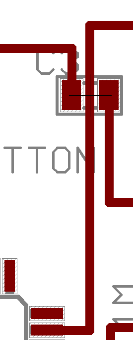

Hi all,
anyone know how to configure rc0 as a digital output?
I have tried everything i can think of, but it still wont work!

Port C,0 works fine. I have used it on the Unicorn to drive CS2 of a graphic LCD. Could the pin be shorted to ground? What do you read back from PORTC and LATC?

Hi mike,
Thanks very much, i just checked the board again with a meter and found a short. I had routed the rc0 trace through the tiny gap inbetween an 0805 resistor.
