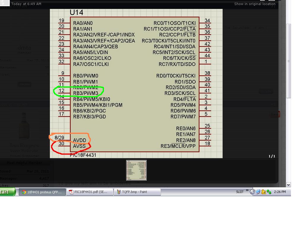

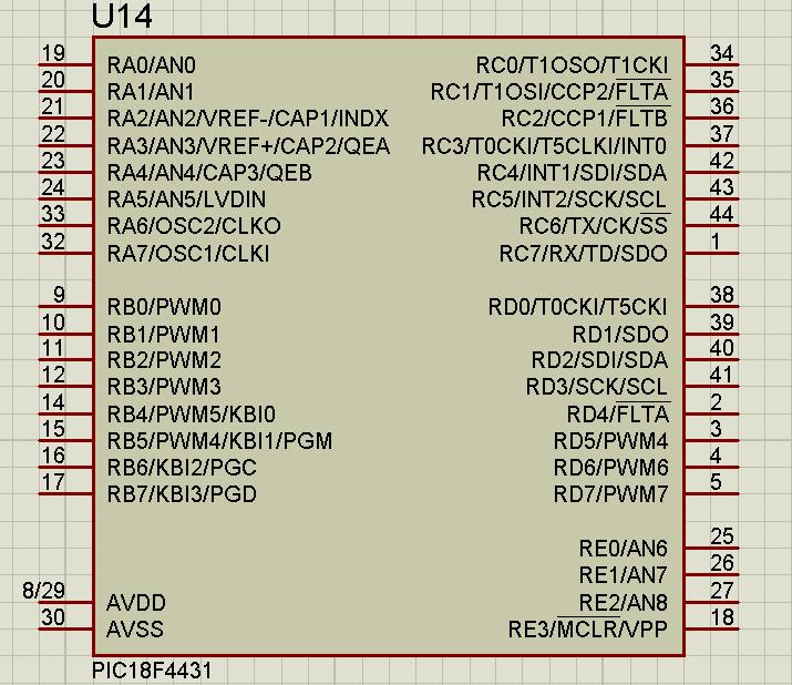

Hi all,
This is what I get for the 18F4431 QFP pic in proteus. These pinouts do not match the datasheet or am I missing something here ?? (pin8,12,30 etc)

Hi please take a look at this !!!!!!!!!

Are you comparing TQFP against QFN layouts.?
E
@ericgibbs
It looks like they have swapped QFN and TQFP packages !!!!!!!!!!!!!

If Labcenter have a Forum, it would be a good idea to post your findings.
