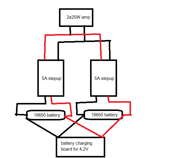

I am trying to simplify 1 of my speakers. Right now its 5S running a 20-25V amp. I am trying to now replace it with batteries in parallel and i need step-up that will convert that 4.2V to 20V. Usualy i find everything on ebay for decent price but now i cant find a nice step-up.

edit: if i dont find the right step-up, could i just use 2 step-ups of 5V instead ? I will charge all batteries with 1 charging usb board and i dont have trouble connecting to all the batteries. And i split the batteries into 2 groups, 1 group goes into each step-up. That way i only need 5A step-ups.
Would this work with 2 step-ups ?
You need 20 to 25V at 5A? That is 100 to 125 watts. That will require 23 to 30 amps from your poor little batteries.
"batteries in parallel" How many? Assume 2, you could series and get 8.4V which will boost better. (need 11 to 15A)

My bad, input will be 12.6A yes, output will only be 2.5A since i am powering a 50W amp. I want to avoid putting batteries in series, so i want step-up that can take as low as 2.8V as input voltage, it must handle 12.6A input and 2.5A output.
As for charging, i will charge with 1 or 2A yes, and it will take a while but its not a problem, i charge it usualy over night as for powerbank charging, it will spread through all batteries so it will be ok :)
Now you show two battery cells in parallel. The charger might overcharge one cell (kaBOOM!) and undercharge the second cell, because a battery is charged with current, not voltage.
The voltage step up circuits might not like their outputs to be in parallel.

I agree that the step-up circuits might not work well in parallel.
Well then the solution is only 1 step-up but i have to find the right one.
