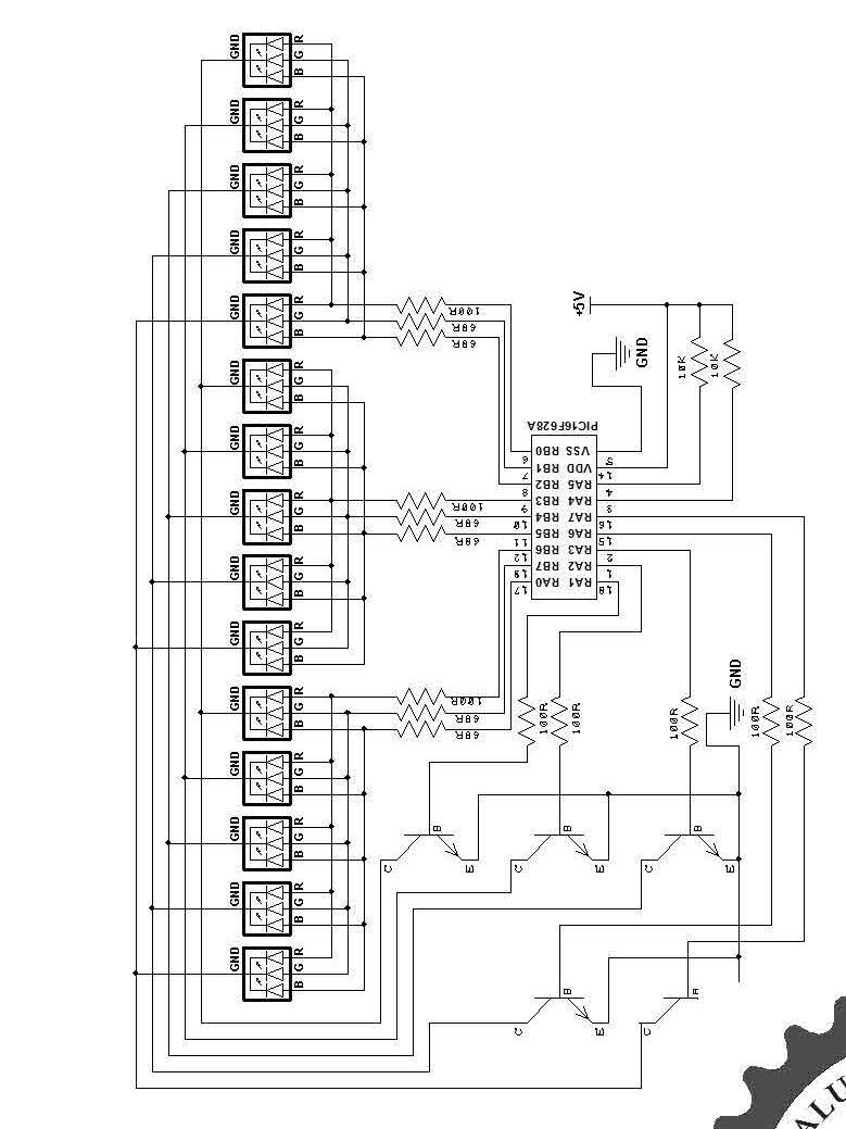

Here is an expansion of a recent design of 15 channel RGB color wave.
Use of all PIC16F628A outputs as a stand-alone system to drive 18 RGB LED's.

What are the results of your 15 RGB project, or your 12 RGB and 9 RGB projects for that matter? Are you simply showing us your schematic and board design capabilities?
In your 15 RGB project video, the large and abrupt color changes in the "wave" suggest you may only have a few bits color resolution per LED and/or a very low refresh rate. Do you have any meaningful software specifications to share for any of these projects?
What kind of results are you looking for Mike? Everything you need for 15 RGB is on the page. You have color mapping, source code mapping, you have resolution, PCB layout, and schematics. You already know it works. So all you have to do is build the circuit and write your code based on the model.

Source Code Layout Implementation
Although I will not post a code I will do my best to describe how the programming concept works. Attached please find schematic layout and programming code guide for the 15 RGB version to follow.
Program Setup Concept
1- Since there are 15 RGB's, the program uses only 15 colors. This allows colors to remain vivid.
2- To minimize the code lines to fit the chip I had to make a compromise on resolution (Again maximum colors needed are only 15). 3-Bit resolution format per primary color, repeated 15 times.
3- To prevent flickering I had to maintain the refresh rate constant (100)
4- To compensate for 20% duty cycle (compromising the brightness), LED's are slightly over driven for a very short time by reducing resistor values. Parallel to that software refreshes at an even higher rate and maintains the high state for a bit longer time.

Decoding the Program for 15 RGB
The program creates it's own PWM without use of internal PWM of the PIC.
There are 15 RGB or total of 45 bits that needs to be addressed at each pass thru.
A) PWM and color coding is sulmultaneously achieved by creating 15 "Groups" (15 main subroutines). Each "Group" creates one frame of motion picture. Each Group is looped 15 times for motion smoothness. With 15 Frames you can make the movie. Each Frame places one specific color set across all 15 RGB. Next frame moves the same color set over one RGB and so on until the 15th RGB on the 15th frame will have same color as the 1st RGB on the 1st Frame.
B) Each Group calls 5 "Sections" (multiplex 5 you see in schematics) to set the colors on 15 RGB. There are 15 x 5 = 75 Sections called in the program for the entire movie.
Eah section loops 100 times to refresh the color and to prevent flickering. Each section has 3 pair sets of color command. PortB1, PortA1...PortB2, PortA2,...PortB3, PortA3 (Resolution 3) setting and maintaining colors.
C) At the same time that colors are called (8 bits of PortB, plus bits A0 of PortA), bits of A1, A2, A3, A6, A7 are set one at a time to indicate which of 5 sections are addressed completing the multiplexing.
Section 1 sets colors for RGB1, RGB6, RGB11, Section 2 sets colors for RGB2, RGB7, RGB12.......and Section 5 sets the colors for RGB5, RGB10, RGB15.
D) After one entire frame is completed, 5 sections are called and 15 LED's have been addressed. Next frame will change the color code in PortB+A0 and calls 5 more sections and so on...
I did try the system with 4 bit resolution (Calling 4 pair sets of color commands) and I simply ran out code space. (Addtional 6 lines per section x 75 sections) But that does not make a difference as the resolution sets the color and not the transitions between frames.
If one wants to smooth out the transitions between frames, I suggest to fade each 15 "Group" calls. I believe there is enough programming space to make this happen. If I have time I will toy with it and post. Remember each group call produces a single frame.
Here is a heads up that demistifies RGB9, RGB12, RGB15. Once you figure out the programming logic you can easily and quickly expand from 9 to 15 RGB.
All of the above use 9 bits (All PortB plus A0 bit) as base color generation. The difference is number of multiplex bits used in hardware and number of sections called in software.
Example:
RGB9 uses A1, A2, A3 as multiplex bits with proper resistors and sinking transistors. 9 colors across 9 RGB moved 9 positions. Program calls 3x3x3 =27 sections. 33.3% duty cycle.
RGB12 uses A1,A2,A3,A6 as multiplex bits. 12 colors across 12 RGB moved 12 positions. Program calls 3x4x4 =48 sections. 25% duty cycle.
RGB15 uses A1,A2, A3, A6, A7 as multiplex bits, Program calls 3x5x5 =75 sections. 20% duty cycle.
RGB9,12,15 use max 3 bit resolution to achieve the colors.
As you can see by increasing the multiplexing bits by one, you increase number of RGB by 3, and number of line codes required increases exponentially.

You've done a nice job extending the hardware of Pete's original design (27 channel PWM on a 16F88). Keep up the good work. I'm sure someone will get something out of it.
Please let us know if you need help with software? I've got a BAM (bit angle modulation) demo (209 words) for Pete's original 3x9 project that provides ultra fine 2-usec duty cycle steps and 8-bit (256 level) resolution per LED with a 651-Hz refresh rate. You would only need to modify a few lines of code to drive a 4x9 (36 LED) matrix at 488-Hz or a 5x9 (45 LED) matrix at 390-Hz (8-MHz 16F88).
Regards, Mike
Hi Rom,
Thanks for the compliment.
I would be interested to know if you used a table lookup for data generation (like Pete did) or you used a direct programming approach. I am converting mine to a data table lookup so that I can create different affects running the same main program. I would eventually like to expand further to data transfer from an external EEPROM for contineous affects for a long period of time. (Hours)
