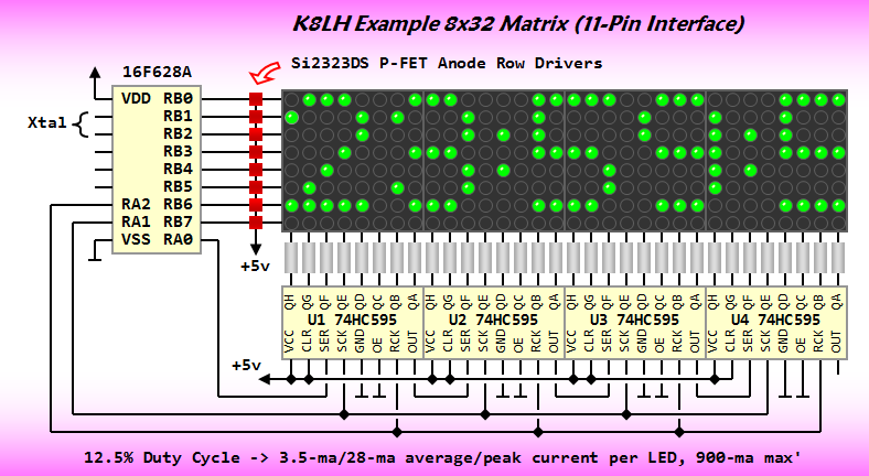

You could use discrete transistors (mosfets) and serial-to-parallel driver ICs, like TPIC6C595 or MIC5821, but it's a little bit more work for the microcprocessor.

With your design, could you use a '595 for the rows along with the transistors and reduce the pin count from 8 down to 1?
RA0, RA1, RA2 to the Columns (Ser, SCK, RCK)
RB0, RA1, RA2 to the Rows? (Ser1,SCK,RCK)
If so, then maybe it is possible to use two Max7219's in a similar configuration?
One driving the Rows with transistors
One driving the Columns.
(What program do you use to export your .png images from, is it a circuit simulator?)
