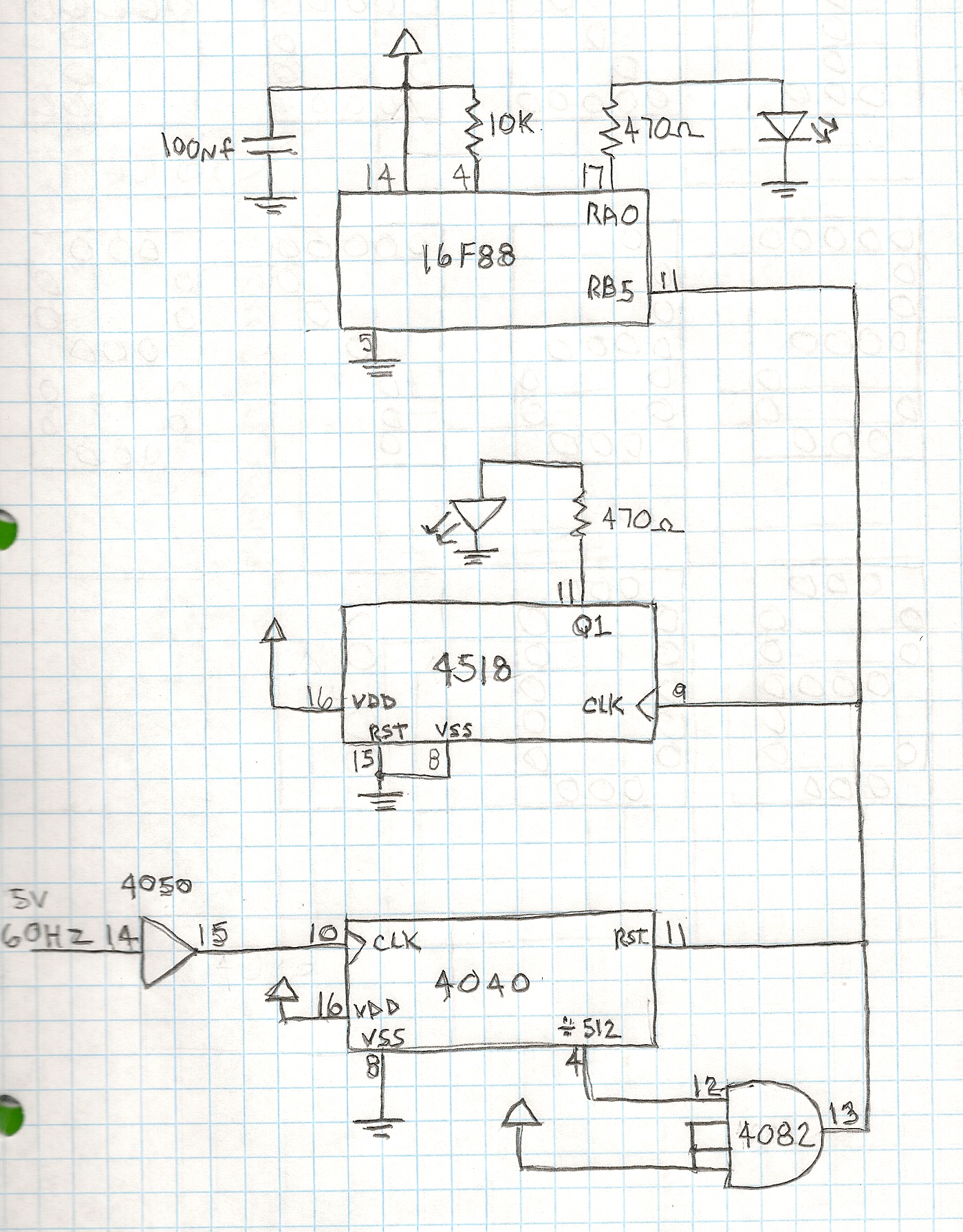

I can't figure out the problem with the attached circuit.
Sorry about the drawing I don't have a schematic program.
4050 is a buffer
4040 is a 12 bit ripple counter
4518 is a decade counter
16F88 is a pic
All the circuit does is divide the 60HZ by 512 and the reset
is used to clock the 4518 and Q1 blinks the led. This works
fine.
Then I use the reset as an external interrupt for the 16F88.
Doesn't work. BUT! if I just wire pin 11 of the 4518 to
the interrupt pin(RB5) the 16F88 diode blinks according to
my program.
I can't seem to trigger on this reset with my analog scope.
I tried wiring the reset through a buffer but it didn't help.

I'm guessing that the pulse is too short to trigger the interrupt. It could also depend on your code as by the time the interrupt is executed the pin will be back to zero. Why don't you feed the 60Hz straight into the pic and count internally?
Pommie,
Thanks for the reply.
Good question. I have done this on other circuits and it
works great even without the buffer because RB0 is Schmitt
trigger input.

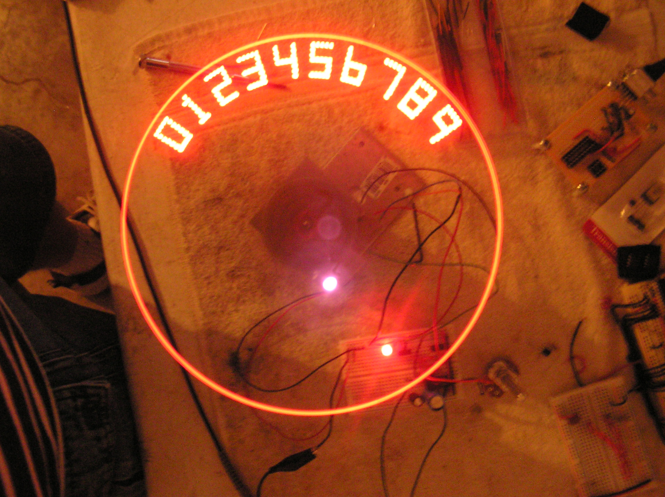

Here I'm using the 60HZ as a time base for a propellor clock
but I'm also using another interrupt from an IR receiver to
start the led display routine. When the display routine gets
interrupted by the 60HZ interrupt it looses it's place and the
digits jump around. My aim here was to only interrupt the
display routine once a minute and see if it looks better.
I've never made a propellor clock before so my approace may
be wrong.
jerryd

The display routine is started 50 ms after the IR
transition. The motor makes 1 rotatation every 100ms
or 600rpm. Four digits are displayed during 1 revolution.
Here's the code(basic) to display 1 digit:
'procedure to display one digit
sub procedure timeDisplay
for x = 0 to 4
PORTA = bits[n][x]
delay_us(50) 'leave LEDs on for 50us
PORTA = %00000000 'turn off the LEDs
delay_us(150) 'space between LED columns
next x
end sub
I call this 4 times with 450us between the first 2 digits
and 1ms between them and the next 2 digits. So the whole
routine takes about 5ms. Works OK except for the interrupt
problem.
Can you suggest a better way? The motor is voltage controlled
so I can change the speed.
jerryd

Since my project is a propellor clock the leds are only in
the correct place for a small part of the 10HZ rotation
speed of the motor. In the attached photo I happen to
be displaying all the digits.
If I don't update them all on every rotation won't I have
a persistance problem?
jerryd

upand_at_them,
Forgot to attach the photo.
Here it is.
