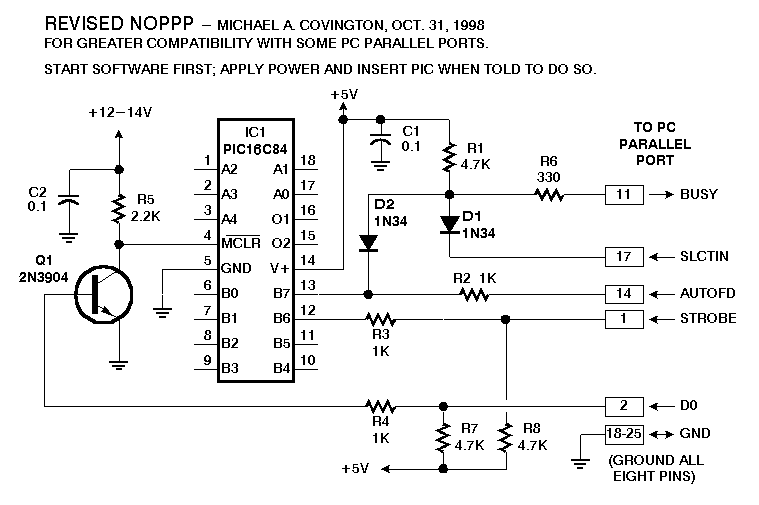

By the way i have attached the Noppp interface schematic (parallel port) that im using with 14V Adapter.
Nigel, yes i use the internal oscillator with all types of pics and never seems to give me problems except the 16f88. Im not sure if you guys are aware of winpic software, but Winpic relies on the Dev files from MBLAB IDE for correct configuration. I did not have it at the time using 16F88. Maybe this could of caused the problem and possibly enabled the code protection? Im out of 16F88 to give it another try, but next time will use dev files attached.
I know this interface is capable of flashing 16F88 as it did successfully with 3 of them the first time and only. Is there any modifications or tricks i can get around this.

What a dreadful looking programmer...I don't doubt though that it works, with a range of parallel ports, but probably not all. Not all parallel ports drive the same, especially when they are configured as ecp/epp. I have seen ports that output as little as 3.7V before, but because it would be a logic high, so the printer works ok with it, but little else will. I assume that you have tried setting the port as a standard parallel port on the PC ?
I would definately build a better programmer if I were you :)
That was it. Thank you so much Nigel. I did as you told me too "this requires either switching Vdd, or being able to ground MCLR to reset the device." grounding MCLR then read the 16f88 until read successfully which indicated its in programming mode. It may take few attempts. I owe it all too you Nigel.

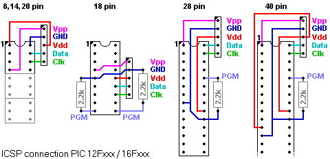

do I need to force this voltage into the vpp? what jumper settings must be made in order to use the power supply external for this willem crap 5.0c????
PLEASE, PLEASE AND PLEASE!

Some mods must be made manually on willem 5.0c hardware
I think I found the problem is that the crap willem does not provide all the links, some stuff must be wired manually, I found this:
