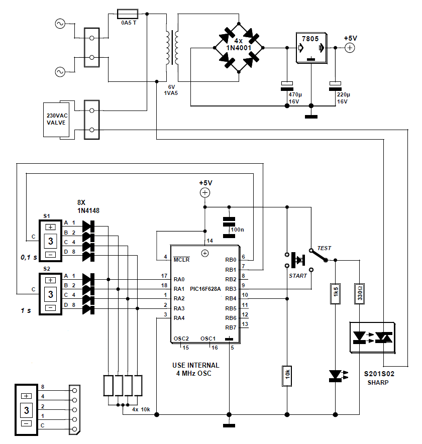

The whole circuit is imho not bad.
I will not use it as a darkroom timer but as a precision timer for inflating balloons for my wife. :)
She is into this business.
So the issue for the BCD switches in low light conditions does not apply to my actual needs.
@mvs sarma,
would it be to much to ask you for a version of the code for use with the internal osc? :eek:
PLEEEEAAAASE ???!!!??!! :)
As now Ericgibbs takes over, i shall relax, being a learner still. I will try for experience, but you are likely to get a cute software from the hands of Eric. The internal oscillator may be 8MHz and all the delays are to be re-tuned.
This is the final schematic i intend to use.

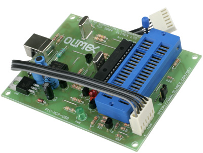

This is the beast:
Development and Prototype boards and tools for PIC AVR and MSP430
It has USB, latest FTDI drivers, set on Virtual COM Port 4, it is recognised by MPLAB but the final result doesn't match my expectations.:(:(:(:(:(
I don't know if it's me or the hardware....
Im not completly sure, but I think this 'Virtual Com Port 4' has been raised by other members.??????
I have the Olimex PIC-MCP-USB Programmer.
Made in 2007, newest software (V1.30)
@Eric , what exactly you mean by saying:
"...but I think this 'Virtual Com Port 4' has been raised by other members.??????" ????
Regards
Stamatis
Regards
Stamatis
As a problem with the settings within Windows.????
