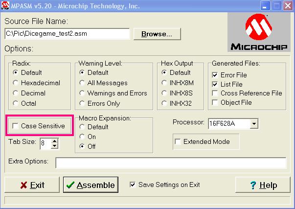

Forget my previous post. I have found the problem. counta should be countA. Just changed letters to upper case & that solved the problem of building the file. I will now try it to see if it works.

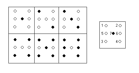

OK HouseOFwax here are the latest results of what we have accomplished. The dice game is now working almost perfectly. I have increased the delay time in the display section by replacing the movlw and call d_0 with call Delay255. I used the call Delay 255 six times and this allows the leds to go to sleep after a short period. I am sure there must be a more efficient way of doing this but I will have to read up and find out how. There is one slight problem though. Sometimes lets say for example #4 lights up. The leds are not necessarily in the 4 corners as they are in real dice. I am thinking this could have something to do with the internal timing. not a big deal though.

I don't think that the "The leds are not necessarily in the 4 corners as they are in real dice", is due to timing*.
That is probably an arrangement of your particular set up of the LEDs (not entirely sure).*

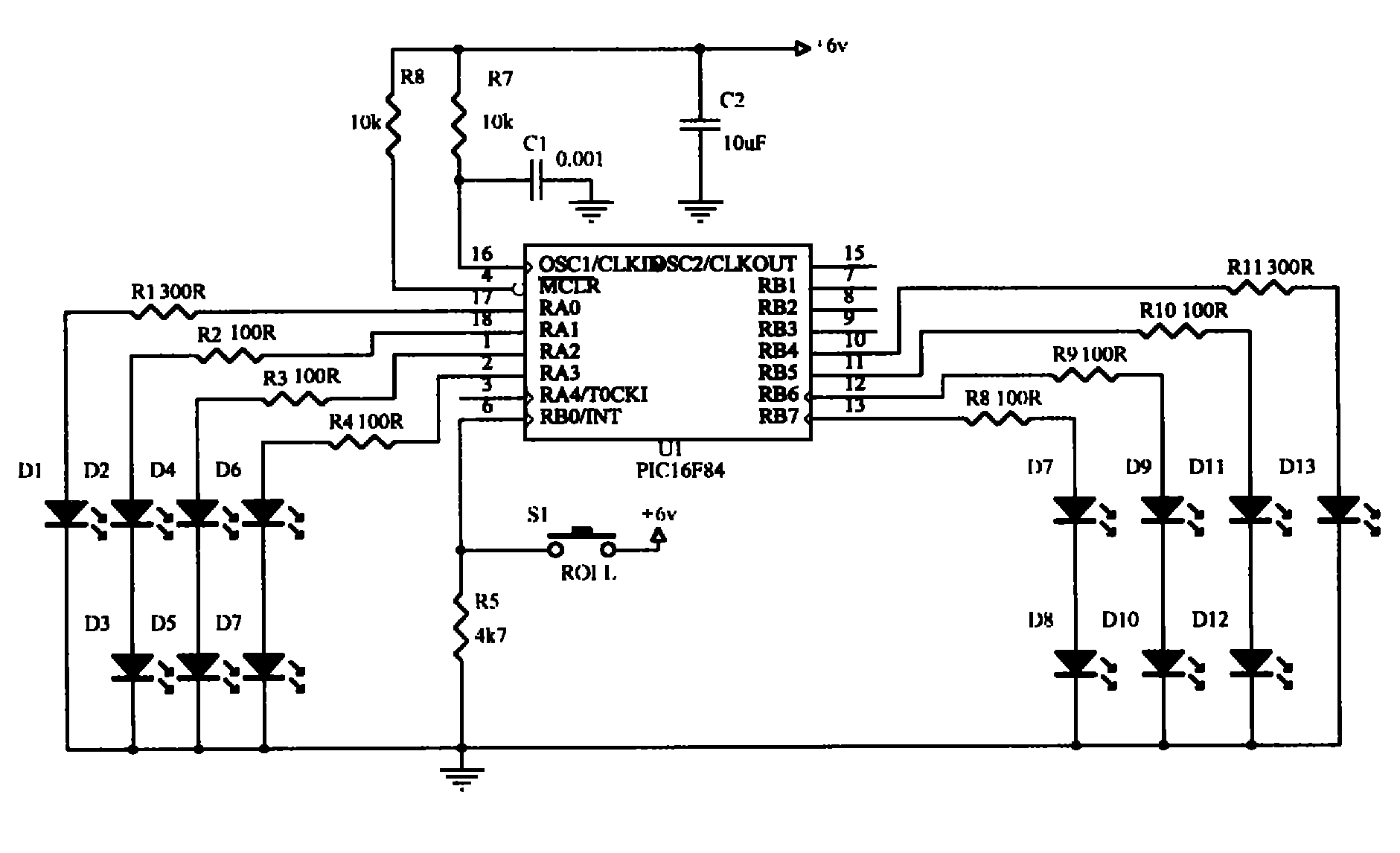

HouseOFwax, Found the problem. Now everything is working just as it should. Further checking of the code revealed that I had some of the pin connections wired wrong. When I first connected the leds I was not sure just exactly which pair of leds went to which pin. After studying the code under the hardware constants I realized my mistake. I also fooled with the code a bit to extend the display time and the roll time. This has been a great learning experience for me, but I still have an awful lot to learn.
Can u share the working code and the schematic showing which pins to which LED?
Thx

Here are the attachments
