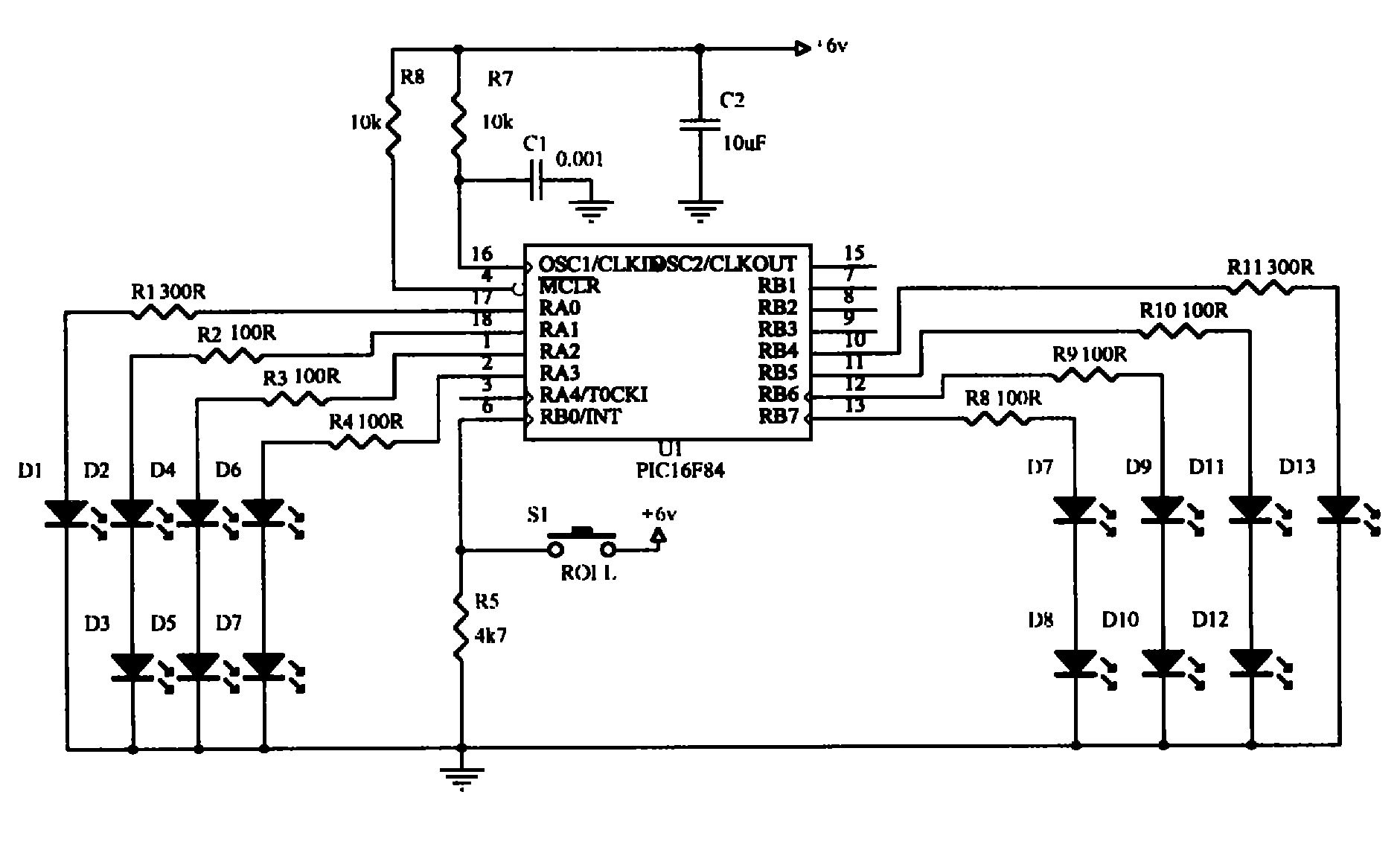

First of all let me say that this is just a hobby for me in my retirement years, that I enjoy very much. My knowledge of micro controllers is very limited, and I am learning, but after many hours of trying to get this thing to work I have decided that I need some help. The original code is assembly and uses a 16F84 pic. I want to convert the program to use a 16F628A pic. I have added the movlw 0x07 & movwf CMCON to just after the org
0000 instruction, to the original code. My question is, since the original code for the 16f84 uses an external RC osc. and I want to use the internal OSC. in the 16f628A. What changes do I need to make in the configuration settings? The schematic has a 10k pull up resistor to the MCLRE pin. Do I need to disable this using the 16f628A pic? I have tried many config settings that would quick build and load into the pic using a pickit2 programmer but would not work. I have attached a copy of the schematic. Thanks in advance for any help that I may receive.

It would help to post the code aswell as the diagram.
Have you constructed the circuit as shown?
I notice the diagram doesn't show the power and ground for the Pic.

What about the config fuse for activating the internal oscillator?
This is where I seem to be hung up. I have used Nigel's 0x3D18 but it did not work. All the leds would light up when the button switch was closed but would stay lit until the button was released. No sequencing takes place.
Ok use this:
3F30
That gives Power on reset, Mclre, and,Internal osc no clk out.
Exactly what I found, once I'd got it assembled by removing;
LEDTest		EQU	B'00001111'
But once I'd commented out 'Sleep'

HouseOfwax Things are looking up a bit. At least now when I apply power some leds light up. When I push the switch on all the leds light up. If I hold it on for 5 seconds or so, I will get a different combination of leds to light up. However they do not roll, they just change each time I push the switch,and not necessarily look like a dice. Another thing the leds seem to flicker all the time they are lit.
We both seem to have the exact same results. I was using Nigel's LED board design which is in no way the same as the diagram, though gives me an indication.
I can't say much more on the subject, as I didn't have the time to look too closely at the code. Though, I do have a 16F84 around which I may try with the original code tomorrow. Having said that, I couldn't compile the .ASM that you supplied without the removal of previously said line.
Though through a bit of Googling, I do note that many people have successfully built the project. . . :?
Thanks for staying with me on my little project. I would be interested to know how you make out using the 16f84. Anther concern that I have is, when the dice roll, are the leds supposed to flash in different sequences and then come to a stop or is the sequencing done internally only and show only when you release the switch?
RandomA is not changing in the following sub-routine:
Calculate_Result
        movfw    RandomA        ; get the random number
        andlw    7        ; get the lower 3 bits
        movwf    DieAVal        ; make them the dice value
        swapf    RandomA, 0
        andlw    7
        movwf    DieBVal
        return
Try adding:
Calculate_Result
        swapf    RandomA, 0
        swapf    RandomA, 1
        andlw    7
        movwf    DieBVal
        return
Having looked closer at the code, yes, they do flash in different sequences and then come to a stop. However, what I have discovered is the timing is far too fast to be able to see it.
I have lengthened the timings and they do change and then stop. I also got rid of the flashing by commenting out the clrf DieA / clrf DieB (which is not needed since we're not using the sleep command).

I'd suggest playing with the timing code and once things are slow enough to see what is going on, try Colin55's suggestion.
After a bit more messing about with the authors timing code, I ripped it out and replaced it with Nigel's.
It now seems much better, though as I said, I don't have a 'die' LED arrangement.
Have a look, see what you think.
