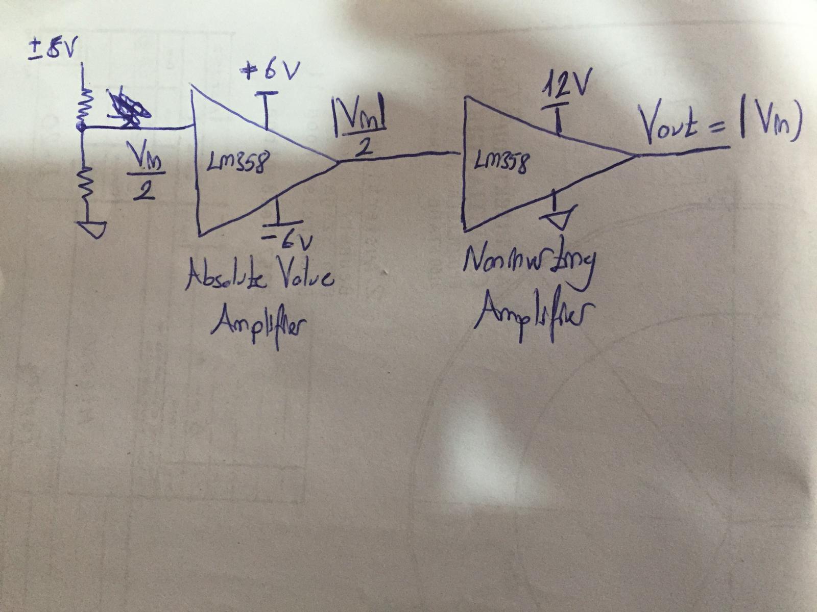

im a bit confused about virtual grounding for my future project so need to help.
My goal is generating easy rail -rail supply voltage for future projects.
Let me tell about my project...
My goal is to build a simple circuit that contains absolute value amplifier and non inverting amplifier. There will be +- 8V input and that voltage value's absolute will be on output. I can do that with just using absolute value amplifier but the problem is my positive supply voltage. As you know i need rail-to-rail voltage for absolute value amplifier circuit but i have only 12v supply for that project.Here is the circuit.

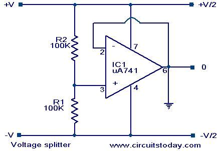

For +-6V i thought to make a virtual ground by using equal resistors and capacitor but then i realized that , i cant supply my non-inverting opamp with 12V anymore. I searched a bit on web , but all i found is just charge pumps or pump ic's or virtual ground buffer chips. But i dont want to use any of them. The first resistor diveder will divede by 2 for headroom of absolute value opamp. With noninverting opamp ,input value will get back to real input voltage by multipling 2.
So i must create a circuit which will give me +-6V by 12v and whenever i want , i can use 12V single supply too.
I tried to tell my problem as much as i can. Hope you guys help me ? If any missunderstand happens please tell me. Thanks.
Edited: I just saw i wrote lm358 on noninverting amplifier. It will be lm324sng which will work with single supply.
If I understand you correctly you want ±8V out from an amplifier system which has only a 12V (or +6V, -6V) supply?
That's not possible. The minimum supply would have to be 16V (for an ideal rail-to-rail output amplifier).

I think you missed input resistor diveder . It will divide for headroom of absolute value opamp , as you said.
Example:
If input signal voltage is -7V. By resistor diveder it will be -3.5V. And via absolute value amp, this will change to 3.5V. And after noninverting amp , output will be 7V again.
Thats all of operation. Thanks again

The Lm358 is meant for low voltage single rail battery powered systems, you were right creating a half rail virtual ground is a good way to go.
The i/p & o/p's of each amp would need to be capacitor isolated, and circuit ground wouldnt be power ground, but thats not usually a problem.
Some care needs to be taken in amp selection as some dont lend themselves to all single rail applications.

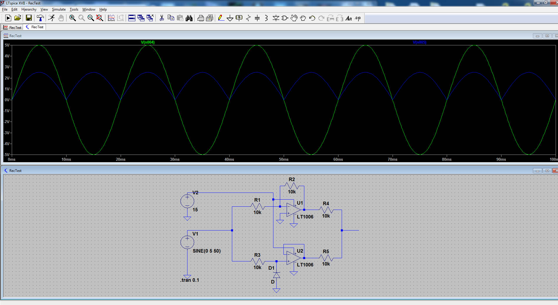

That circuit needs a negative supply to work.
How about an inverting unity gain opamp circuit for the negative half and a separate non-inverting buffer for the positive half, both with eg. 10K input from the signal source (and 10K feedback for the inverting one).
Each will give output on one half cycle and zero on the other.
Sum the two outputs with equal resistors and you should get a rectified version of the input, at half level?
Use a gain stage after that if needed.
Add a protection diode at the input of the non-inverting opamp to ground, to prevent that going negative.
Edit - just tried simulating that, it appears to work OK:

Many thanks. Simulated and it worked as expected.
But i didnt understand clearly aboud diode.Is that what you meaned?
Op Amp Input Over-Voltage Protection: Clamping vs. Integrated ...
I did not see you new post for some reason, when I came back to the thread last time.
I've added a sim showing the circuit I was thinking of & the diode location, in my previous post; just the lower diode in you circuit, from ground, to prevent the opamp input being pulled negative during the negative input cycle.
It can mess up the internal biassing and cause false outputs, or even damage in some types.
A schottky diode may be advisable, as that will conduct before any possible internal junction.

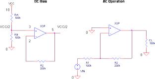

there are many ways to get bipolar rails from a single polarity supply... the easiest way with op amps is to first of all don't think of the -rail of the battery as ground. you want ground to be half of the supply voltage. back when i designed active electronics for guitars, i used an op amp as a "rail splitter" to operate op amps off of a 9V battery and provide a good low impedance ground and +/-4.5V rails like this:
usually i did this with a quad op amp using one of the four to create the ground(just about any common op amp will work). notice that the ground is "driven" by the op amp. if you want a lower impedance ground, you can add electrolytic caps between the ground and each rail.

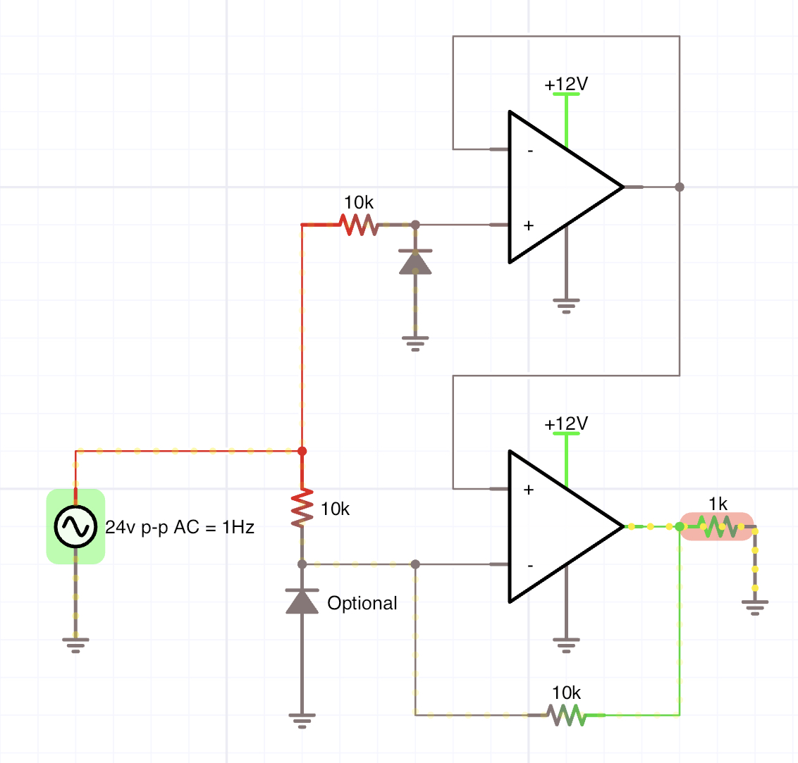

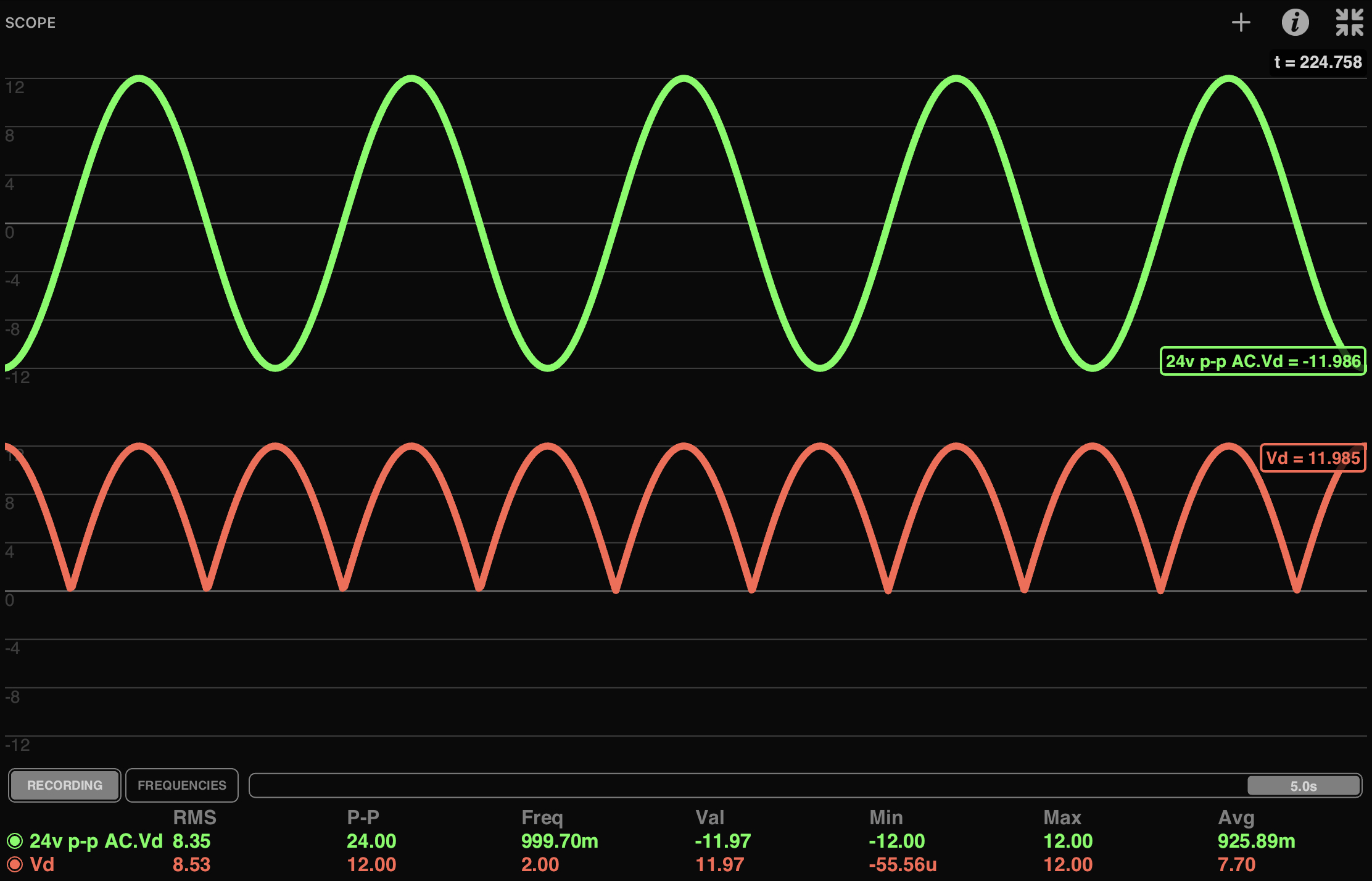

Super simple. The diodes only protect the op amp to keep input within allowable range. The diodes are not in the signal path - even though this is a precision rectifier circuit.
That is, the non-inverting amp needs the diode on the (+) input to keep input within 0.3V of negative rail (use schottky diode) during the bottom half cycle.
For the inverting amplifier, no diode is actually required if the op amps output can always properly drive the feedback resistor by reaching +12V when the AC source is at -12V (to achieve 0V at (-) input). Otherwise, the diode labelled "optional" should be used.
It's one dual op amp (rail to rail in/out) that can operate at 12VDC. Three resistors and a diode (second diode is optional).
I hope this works for you.

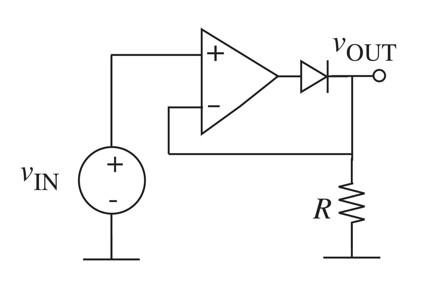

Apologies got busy last night, things fell apart.
Heres a schem I found, the diode keeps the op amp o/p a diode drop above ground so it always conducting, this circuit will only work reliably if the op amp i/p is kept above ground, some op amps dont like it if you try to drve the o/p below or above the rails, you could give this circuit gain by adding resistors.
