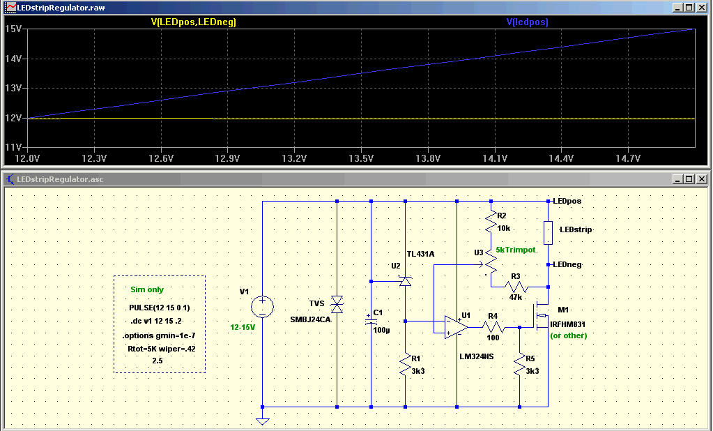

If you wanted to build your own low drop-out regulator you could try this. Note that the FET can dissipate up to 15W, so would need to be on a substantial heatsink (electrically insulated from the vehicle metalwork).
  • LEDstripRegulator.asc

The strip comes with a controller, that handles PWM for the fade, and creating different colors.. not sure how that would respond to an increase in voltage,as i havent opened it up. thats why i was thinking of a dc-dc regulator or some sort.
Alec, thanks for the schematic! ill def keep that in mind.. i already have most parts on hand
The voltage regulator circuit from Alec is perfect for the LED strip product in a vehicle.

Circuits like Alec's have major stability problems. You can add a resistor between the 431 and the minus input and connect a cap from output to minus in and hope for the best. I have frequently found that the cap value that is right for one load still allows oscillation at a different one. I don't like to admit it, but I usually give up with this circuit because I don't have the math skills anymore to solve the heavy duty equations needed to determine the optimum compensation scheme.
