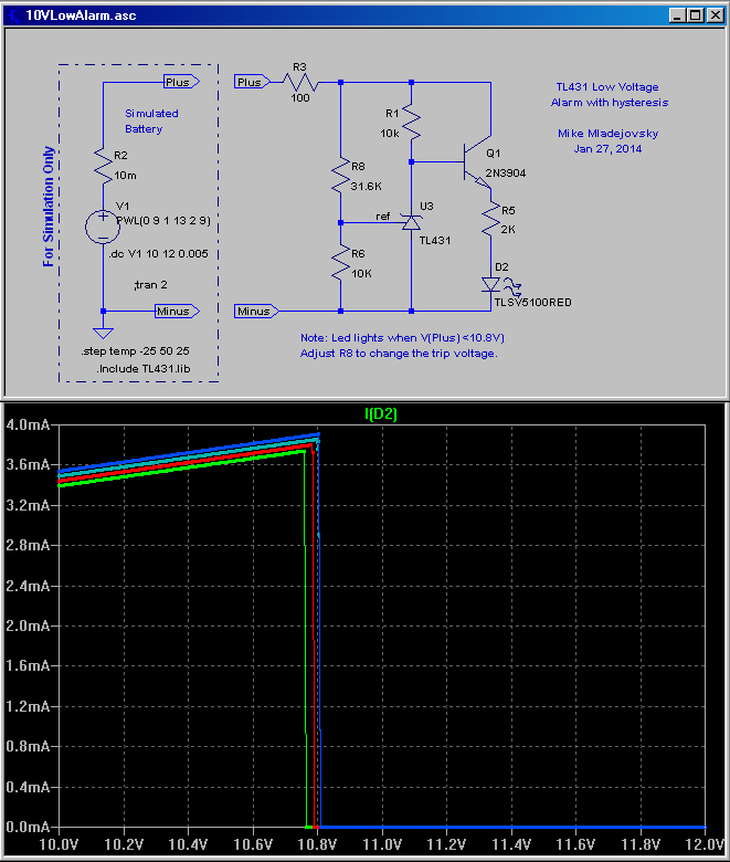

I made this circuit.
The problem is when it reaches the trigger point (0.65-0.7) the LED is flickering.
How to overcome this?

You built a better thermometer than a battery voltage monitor. To cure the flicker, you need some positive feedback to provide hysteresis.

Here is the behavior of your circuit. I varied temperature from -25degC to +50degC. Green is -25C, red is 0C, lt. blue is 25C and dk. blue is 50C. Note the slope after the LED begins to turn on. At this point, the circuit is very sensitive to slight variation of the battery voltage. I'm guessing that there is something varying the battery voltage (intermittent load?)

I added a 22uF cap across GND & the base of the 1st transistor.The jitter dropped much but has some more.I'm checking from my adjustable bench power supply by giving varying voltage.
Here is a much better circuit with about the same parts count. It has much better temperature (although not perfect) compensation, and has a much better rate of turn on. Compare the plots of LED current vs battery voltage as a function of temperature to your circuit.
Here is my favorite circuit for this task. Better gain with hysteresis, better temperature compensation, low parts count.
Here is a way of adding hysteresis to your circuit; the temperature compensation is still lousy.

Change Q1 into a TL431.
Change R3/R4 to divide down to 2.5 volts.
Change the collector resistor from 10k to 4.7k.
The TL431 is temperature stable and turns on at 2.5 volts.
