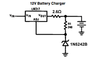

You're right, I'm sorry. You could replace Rs in the original circuit with a 2.2 ohm, 1w resistor to limit the maximum current to 500 ma so you could read it with your meter - but this is all getting very silly. You don't need a current regulator or a hobbled circuit, you need an $8 multimeter.
What was the equation you used to get to 2.2 ohms? I really appreciate your help. Part of the reason I want to use the meter I have now is that it fits perfectly into an old external zip drive enclosure and you can see it in the "window" on the drive case. If I can get this all working, it'll be a real slick little charger thats perfect for charging my motorcycle battery. Heck, at 500ma it'll even give me a rate of C/14 - C/24 depending on which battery I'm charging - which is exactly where I like it.

The one you posted on page one. Use 2.2Ω for Rs, and you get a source impedance of around 24Ω, with a completely flat battery (or shorted output)that will give you a maximum of about half an amp.
You understand that won't give you a constant 500 ma, that's just the maximum. It will quickly taper off.
But I just came up with a better idea. This will give you constant current with limited voltage. Replace R2 with a 1N5242B zener. Make Rs 2.6 ohms, or use this pot to make the current adjustable -
Digi-Key - CT2150-ND (CTS Corporation Electrocomponents - 026TB32R5AOB1A1)
When the output hits 1.25V + zener voltage the LM317 will shut off. It may be a half-volt lower than 13.75V, but I can tell you how to adjust it after you get it built.
So the schematic would look like this:

That zener idea sounds pretty good, would I be able to get 14.8v out of it though? From all my searching it seems thats going to be the best voltage to charge my specific batteries at.
Also, I liked your idea of using the voltmeter function to check the current by reading the voltage over the resistor. Wouldn't it be possible to use a transistor or op amp to raise the voltage from 0.3v to say...5v or something? I have a handful of 2n3904 laying around as well as an lm386 I could use.
It's not .3v anymore, now it's 1.3v. Use ohm's law.
You can get a higher voltage out of it by putting a higher voltage zener in it. 14.8v is higher than what I would use.
Wait, why is it 1.3v? Due to the zener in the circuit? If so, I was disregarding that as I don't have any zeners on hand right now.
Couldn't I put a 3-4w bulb before the lm317 in parallel with the circuit to use up a few ma, therefore lowering my overall maximum charging current? I was considering adding a light anyway. I was going to use a LED, but a regular bulb would work, and if it was dual purpose and helped the circuit do what I want it to, even better.
From what I was reading, it is important to pass the gassing voltage of a maintenance type wet cell to get a full charge. Gassing voltage at 50F for mine is 14.8v which is the coldest my basement gets where the battery would be charging.
Not the zener, just ohm's law, like I said. Rs is now 2.6Ω. At 500ma, that's 1.3V.
Yes, but if you run the current through Rs, it will read the same on the meter. If you bypass Rs, it will goof up the regulator. If you want a pilot light, just put it ahead of the regulator so it runs off the 18V supply, that way it won't affect anything.
