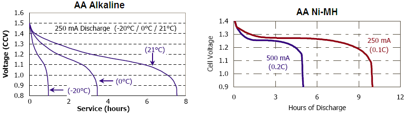

Papabravo said:
The reason is the the standard cell voltage of an NiMH cell is 1.2V not 1.5 as is typical with an alkaline cell. This small point confuses many people who expect a AA cell of any chemistry to be 1.5 Volts. Sorry friends, it just ain't happening.
NOPE!
An alkaline battery cell also isn't 1.5V over most of its life. The voltage of a "1.2V" Ni-MH cell is higher than the voltage of a "1.5V" alkaline cell over most of their lives. The voltage of the alkaline cell is 1.5V only for a moment before it is used.
audioguru said:
NOPE!
Ack! So then isn't a DC-DC converter what I want still? Regardless of the batteries' voltage, I would always get 12v out?
I know what you are saying... My 9-volt batteries drop fast too, but I definitly always want 9 volt output from them... I want regulated voltage, and batteries don't offer that, so I am wanting to improve that. I know a linear system is not what I want, and that a switched Boost converter sounds like what I need, but in a ready-to-use format. Any links for a product like that?
