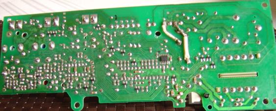

https://sep.yimg.com/ay/yhst-164166...674-20-garage-door-opener-circuit-board-5.gif
Can anyone familiar with garage door openers indicate what the purpose is for the two small relays I have marked 1 and 2?
The trace was burnt off leading to #2.
That's a Microchip Pic... It looks like a standard 28pin , crystal on pins 9 and 10.. Resistor on pin 1.. The pic16C77 comes to mind.. But it won't be readable..
The two relays will probably be for direction.. You need to show the track side as well..
It's one of the directional controls that's failing.

I've traced that lead back into that chip.
I pulled the relay and it is functioning properly.
When the contacts close it doesn't trip and stop, it just continues on in that direction.
Via one of those transistors I hope.... Pic will not power those relays...
BUT!! Those repairs are coming from the HV side...

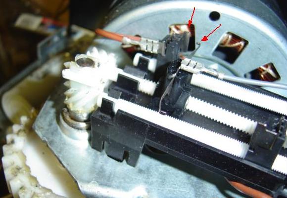

The center threaded nylon screw turns and moves the contacts forward and rearward.
It's the brown lead that fails to work when the contacts meet.
That brown lead can be traced back to the chip.

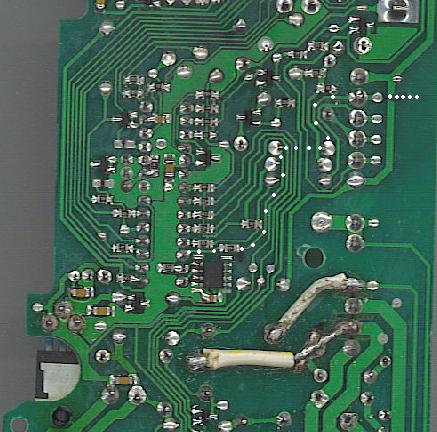

If you follow the white dots you can see the trace from the brown wire ends up in the chip via one resistor.
The resistor is fine Ian.
