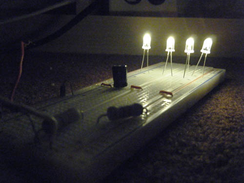

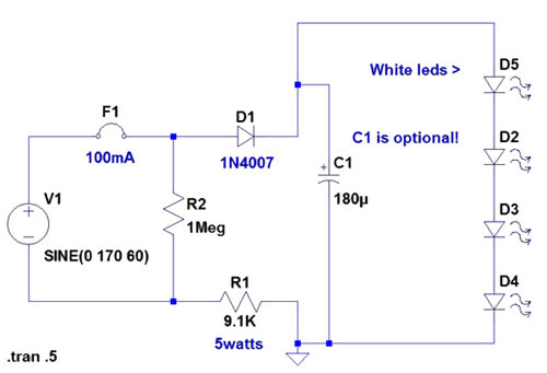

120v 4-LED Night Light - This circuit uses can be used as a night light. It uses a 120v Mains to power the circuit. Works li

I'm a bit confused as to what you ask, but a DC indicator lamp can be used on AC if it has a rectifier and/or filter capacitor, however, the DC voltage will be higher than the AC voltage. That is why an unloaded DC-out wall wart transformer will measure much higher than it is marked.
If the ac supply is 220 volts,then which resistir shoulr I replace and by which one??? PLZ help. I am not exprt.
220v is twice of 110v so doubles the value due to the voltage work, try to replace 9k1 with 22k-100k and capasitor voltage 160v
Not really useful to run off 220 because the resistor will have to be double the resistance, and it will dissipate double the power.

But anyone can tell me why they not use any capacitor after the 120V like other circuit
ex: 1uf or 2.2uf with 250v.
