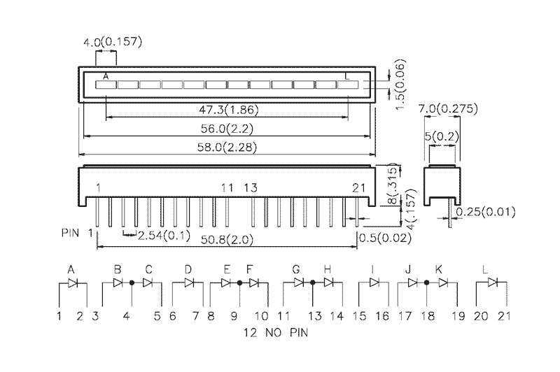

I have this nice looking 12 segment bar graph arrays but i just don't understand the pinout of some of the leds !
See attachment diagram gif, the leds are B, C, E, F, G, H, J and K.

I suspect its to limit the number pins on the LED, else it would require 24 pins.

You're right, that is a weird pinout.
You could drive it with a PIC easily enough. In order to get a consistent brightness, strobe the LEDs that share a pin alternately, and also strobe the unshared-pin LEDs at a 50% duty cycle. So you'd have 2 cycles:
Cycle 1: B,E,G,J are on.
Cycle 2: C,F,H,K are on.
For the individual LEDs, pick a cycle to light those up on. You could light all of them on cycle 1 for example, or put half of them on cycle 1 and half on cycle 2. So, for example:
Cycle 1: A,B,E,G,J,I are on.
Cycle 2: C,D,F,H,K,L are on.
Without strobing, you'd have to use a constant-current source to run the pairs of LEDs in series, or individual LEDs in the case where one needs to be lit and another unlit, to get a consistent brightness. The strobing method is much easier.
You'd think they would have just given all the LEDs a common cathode, or a common anode, thus only needing 13 pins for 12 LEDs. That arrangement is much easier to drive as well.

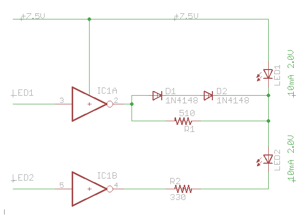

It's a lot of work, but the attached circuit could drive each LED on its own logic signal. Raise each input high to drive a given LED.
Unfortunately there are three problems:
1) the LEDs will have brightness changes when switching from LED1 to both to LED2.
2) the circuit has no tolerance for different LED forward voltages.
3) the logic and LED supply in this example is 7.5V. This probably means CMOS, like 4049.
