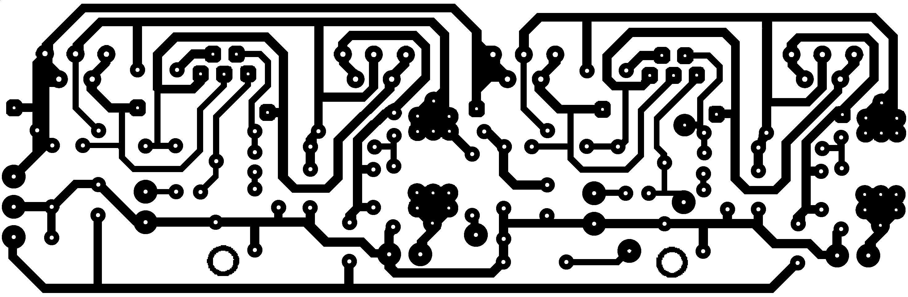

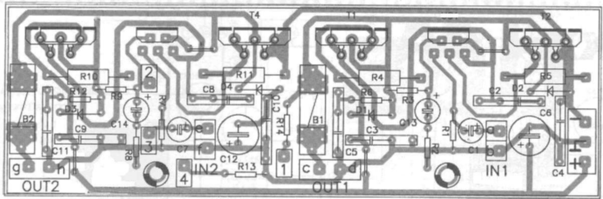

Did U ever think it can be posible?...
All U need now is a power sorce.
  • lista_de_piese.txt

:wink: power supply is 18v that schematic shows 2X50W at 8 Ohmi but in bridge 1X100W at 4 Ohmi

With a single ended output, and a 36V supply, assuming zero losses, you can only get a maximum of 20.26W into an 8 ohm load!. For a 4 ohm load this would double to 40.52W - but in practice it would be rather less. There's no way to get 50W into an 8 ohm load, from a single ended amplifier off a 36V supply (apart from output transformers).
A more likely spec is 50W into 2 ohms, which would translate into 100W into 4 ohms in bridge mode - the extra power transistors would give the extra power required for 2 ohm loads.
But it's a pretty poor design, more a toy than a practical design?. Far better using a decent supply rail and a 'proper' power amplifier to give 100W into 4 ohms.

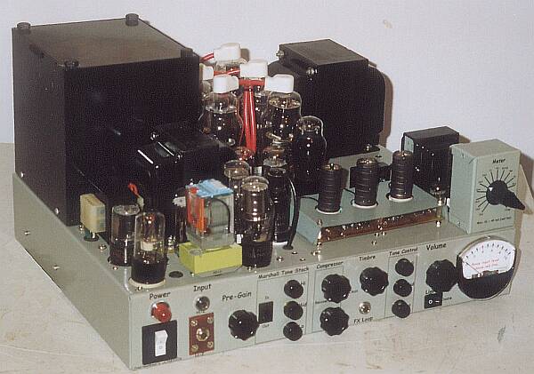

Ok,
if U all say that it`s not what it seames to be could anybody tell me how much a relly good amp cost if I whant to buy it let`s say from england + the expencises for the pachege?
Or better, witch one of U has an amp for sale but someting good with tubes over 200W...
Someting like this

Try having a look here https://www.ampslab.com/projects.htm, they look pretty impressive!.
What are you actually wanting an amp for?, and why do you have a wish for a valve one? - personally I don't like valve amps, only suitable for lead guitar amplifiers in rock bands, simply for the overdriven distortion sound they like.
Vacuum tooooooooobes? Valves are in engines, aren't they? (Those Brits!)
Did you hear about the guy who is making the world's most powerful audio amp with paralleled transmitter tubes (valves?). He has blown the main mains breaker in his office building and uses welded railroad tracks for a dummy load! 300W or more for each tube's heater!
The web is full of sites with guitar amps. Here is another one with big amps, still bigger and even tube amps. It shows a huge amp and its enormous crossover distortion. Hold your ears, here it is:

Schematic map number 4 so that the order of the numbers from one to four named what
Please speak in English then we know what you are talking about.
Maybe you are talking about the first schematic that shows a stereo amplifier that can be bridged by connecting the numbered and lettered terminals?
Its little transistors will probably blow up.
