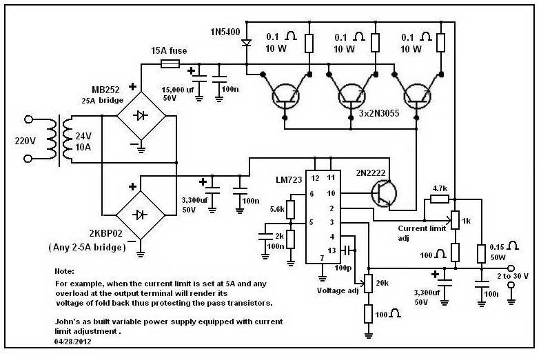

I'm looking to build another power supply,Ive put together a daisy chain of bits ,parts,assortments..

Messing around with the terminals and using a bridge rectifier,I can get 30v DC..I don't expect 10amp @ 30volt
Hence I'm aiming for a power supply that can deliver 15v at 10amp, the rest of the voltage upto 18v is mostly what I'll be using ,but being able Tu pull it down to 1.2volt would be an asset.
Continuously variable current and voltage.
The easy stuff like a few amps of 3.3,5,6,9,12 volt @ 1-3amp are easy to dream up.I have a few lm350's on hand also fixed regulators.
After trolling the net ,cant really find a circuit that fits the bill ,generally the circuits either don't have current limiting,are fixed ,offer only variable voltage or no short circuit protection..
I have various op amps,power transistors,
I kindly ask if anyone has seen or know off a particular circuit ,it would be appreciated if you could slip it by.
Looks OK and easy to build. If you don't need 30V then perhaps limit the input to 25V or so (18VAC in) to reduce the power dissipation of the 2N3055 's, you may be able to get by with three. Build the circuit and see how it performs it'll be fairly easy to tweak.

Looking over the schematic, I got to thinking Maybe I could use 2 TIP3055's (on a whole seperate heat sink) in a Darlington arrangement in place of Q1 to drive the TIP35C's.
This schematic looks promising as well....After messing with the other circuit I managed to blow the bottom out of the IC:p..I went back and forth,i goofed somewhere...it may have more to do with using my power supply instead of mocking up the whole circuit....
Which i'm doing now..
the only difference is the resistors..I have 0R5Ω @20W instead of 0R1Ω..I cant see a 0R4Ω difference being a huge problem...
now in regards to the to the 0R15 resistor..a 50Watt unit..I would need about a 100ft of #12ga wire,or 1ft of #14ga NiChrome....:eek:...what to do:confused:

The 0R5 resistor will dissipate 5 times as much power a a 0R1 resistor.

The LM723 current sense is the voltage drop across the the base/emitter of a NPN transistor. This being about 0.7V I used to use 0.68Ω resistors in parallel. 1 for each amp of current limiting. A long time ago I got a large quantity of them on EBAY. I probably have excess of 100 of them. I would be happy to ship a lot of them to anyone who needs or wants them. They are 5% wirewound by Dale. I just remembered I have a bench supply that is adjustable from 6-14V at close to 9A. It uses a lm723 and a darlington NPN transistor for the series pass and regulators.

In the mean time I mocked up the 2nd schematic..it actually works well..but it does not appear that I can turn it down to a few milliamps like 30 or so..it appears to hang around the 200 milliamp range..it well however max out my power supply a 3amp and limit everything in between... it might have to do with using that 0R5 resistor in lue of the 0R15 resistor...

Not with out its problems. I blew the 2N2222....again...and again.. system runs well only if there a slight short it blows, if the load like 3amp it blows..It may have to do with instead of a few 2n3055's i'm asking this transistor to drive 6- TIP35C.
Ive decided to replace it with a TIP29B..its a little higher capacity..

You are trying to drive three 2N3055's off of a single 2N2222 and are wondering why it keeps blowing up? :confused:
Good lord man do some math on the currents involved with the resective gain ratios for a typical 2N3055 transistor and see what you come up with for input currents needed at their base and what that relates in terms of current and wattages going through that tiny 2N2222! :eek:
No..Im trying to drive 6 -- Tip35c's
I did the math..it was wrong ,I also went by the schematic..
The 2N2222 will work as long as a guy dosent load the system..works great as long as your not trying to drive anything more than a computer fan..
I replaced it with a TIP29B works well now
