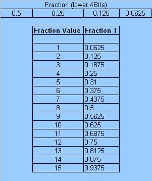

Hi Mike thanks for your examples.
Now my result temperature bytes are like DS 18B20 format.
I just calculated some possibility values to the fractional portion.
For a one decimal digit will a lookup table sufficient without going any multiplications & divisions?

That should work fine and then you don't really need to format the data as 12-bit DS18B20 data...

DS18S20 gives 0.5 in the LSB of the lower temperature register.
My full try is to make a one decimal digit with a least amount of math routines used.Because I'm showing the temperature on SSD's so no any latch functions.So have to do all the calculations within a unnoticeable time.
Just use the integer portion of the temperature in the low byte (get rid of the 1/2 degree bit by shifting it out). Then use the 'count_remain' byte value as a (reverse) index (0..15) into your fraction table...
Mike
Hi Mike thanks for that hint.Same as subtract from 16.
	movf	Count_R,W	;count remain from SP
	sublw	.16		;subtract from 16
	movwf	Index		;
	movf	Index,W		;get the index
	call	Table_Frac	;call the decimal digit
Just a thought you put 16 instead of count per C because of the fraction (count remain) never exceeds 4 bits?
Is this how you made your formula?

No. I meant that you might do something like this (data in table is reversed);
        call    absolute        ; make TempL positive
        clrc                    ; clear carry
        rrf     TempL,F         ; get rid of the half degree bit
        movf    count_remain,W  ; get "count remain"
        call    FracTbl         ; get fraction digit '0'..'9'
;  TempL = integer number
;  WREG = fractional digit '0'..'9'
;  NegFlag = '1' if negative (from Absolute sub')

Yep I have done that.The problem was with the reverse index.I can understand your code.
But with this line
"I meant that you might do something like this (data in table is reversed)"
means the table must arranged in reverse order? like starting from retlw 15(value) ,retlw14(value).......retlw 1(value).

My earlier code for reverse index if I arrange the table values in correct order.ex:retlw 00,retlw 1(value),retlw 3(value) etc...
