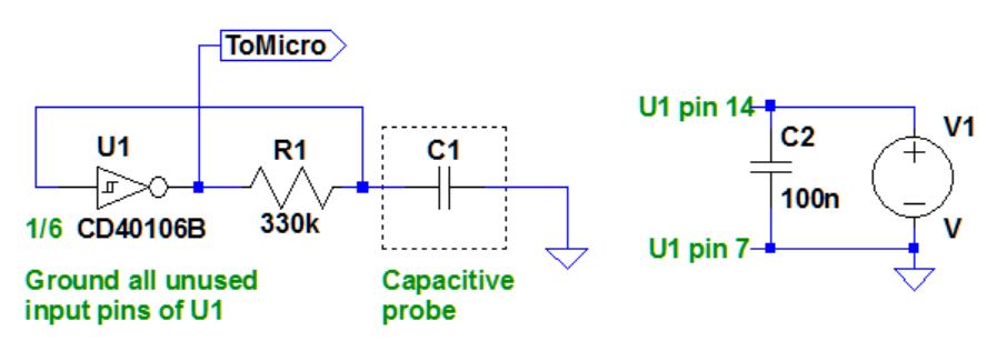

No worries. The capacitance is likely to be small. It can be made the frequency-determining component in a simple Schmitt-based oscillator. A MCU could readily sense the frequency and compute liquid level.

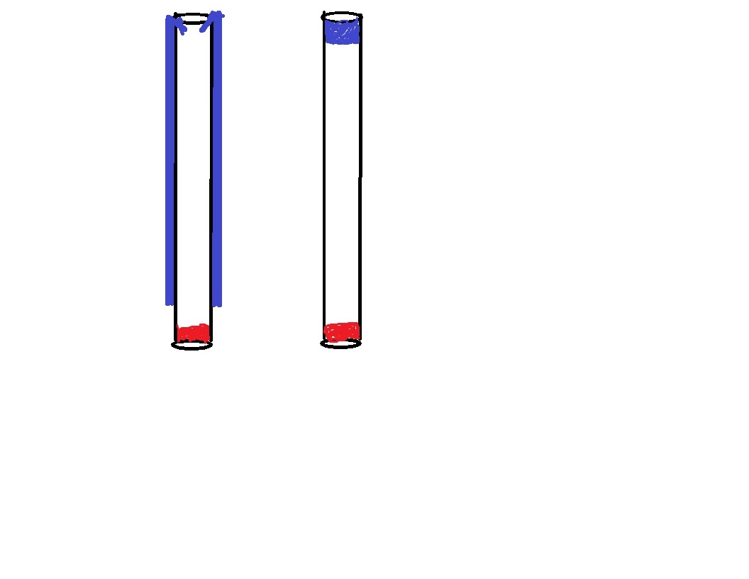

.... actually in my search i found this:
https://i.stack.imgur.com/oWIi9.png
with some pvc pipe i could coat the OD with anode tin foil & glue and then the ID with a small chunk of foil for cathode to supply electrons to the water level... that would make a good capacitor(even if water flows)?
.. and if water flow changes capacitance , could I exploit that to have a flow meter as well on another pipe?
also i have heard of leds that can act as touch photo sensors for fingers on a digital line if the output pin is reversed to input , something about capacitance in the LED there too.
if not then could you provide details of how Schmitt-based oscillator can be applied with micro controller?
good idea about capacitance Alec,
it really was as simple as some pvc pipe and foil, hooked directly to a digital I/O pin and ground, along with simple code:

I tried 2 configurations:
1) OD wrapped foil anode and foil ball for cathode
2) two foil balls at each end of pipe
I found the first one to work better, plus with the OD foil wrapped over to the ID it causes immediate drop to 0v in the event of overflow, the only thing i notice as a problem is that the discharge time varies when my hand gets too close to either of the nodes, I worry that other outdoor environment factors may cause similar problems
any way i can compensate for this, maybe something like another foil layer tied to ground to act as Faraday cage?
also/or maybe it will be better if i move ground wire of pipe to another digital pin so i can truly flip polarities?
Here you go :-
Worth a try. If you can connect one of the two electrodes to ground (as per my circuit) that should help, but body capacitance to ground might still affect results.
With your measurements, did you manage to get values for probe capacitance as a function of immersion depth?
yes, it worked surprisingly well, as water depth changed, discharge times changed, only problem was that when i would touch it, the discharge time would drop significantly
will try more tonite...!
lol, ya, i think that too, but if my fingers can cause such huge anomalies, maybe i need to worry about grasshoppers and rain too..?
Why is rain a problem? I thought this was a water sensor! Don't know how the dielectric constant of grasshoppers compares to that of water. That's an experiment for you to do :). Market this as a grasshopper sensor?
or a fly, or other outdoor things, it just seems very sensitive like it may respond if i even blow on it, which i'll try later too!
my fingers cause such huge anomalies, the average count output with the water is about 12000 - 22000 ticks, when i touch it count dropps to 6000, when water gets between contacts it dropps to 0. i just know it needs another protective layer...
