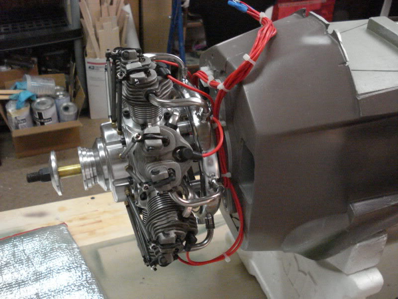

There are quite a few model buffs on ETO- any chance of a picture of your aircraft with an indication of size and weight. Would the size (18mm diameter by 65mm long) and weight (48 grams) of a LiIon 18650 cell be an OK payload for the Sopwith model?
From what you say, I understand that the glow plugs will be turned on and off by radio control. This will require a high current switching element, either relay or MOSFET, and the associated control electronics.
I assume that currently there is no built in wiring to the plugs and that to start the engine you clip individual leads to the glow plugs and once the engine has started you remove the leads.

The starting battery or on-board battery (whichever you prefer) should be a 1.2 V 6000–8000 mAh battery pack. We’ve had success building a pack of (6) 1300–1600 mAh NiCd (preferred) or NiMh (takes longer to cycle to full capacity) 1.2v battery cells wired in parallel so the total capacity is 7800–9600 mAh. The total draw on 7 glow plugs at 2.2–2.7 amps per plug is 15.4–18.9 amps. With a 7800–9600mAh battery pack, you can expect about 30 minutes of ‘on-time’. Once the engine is broken in, you will likely find that the engine idles and runs very well without an on-board battery.
Installing On-Board Glow Drivers Although Evolution Radial engines run just fine without constant glow heat applied, the use of on-board glow drivers allows for easier engine starting and can ensure adequate heat in the glow plugs at all times. This is particularly important on radial engines where oil collects in the lower cylinders. SonicTronics/McDaniel RC on-board glow systems work very well with Evolution radial engines. 7-cylinder applications: MCD477 9-cylinder applications: MCD479 We recommend installing the glow driver socket on the side of the cowl or fuselage and keeping the battery wires as short as possible. Longer wires between the battery pack and the glow drivers will reduce the amount of glow plug heat. Attach the ground wire to one of the engine backplate screws or the crankcase.

SonicTronics/McDaniel RC on-board glow systems work very well with Evolution radial engines. 7-cylinder applications: MCD477 9-cylinder applications: MCD479.
So there is an off the shelf solution. What is the size, weight, and cost?
