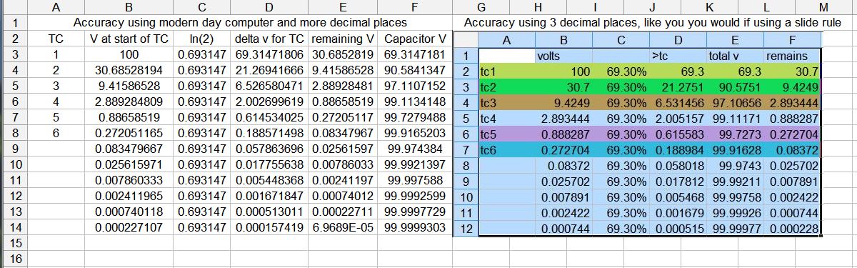

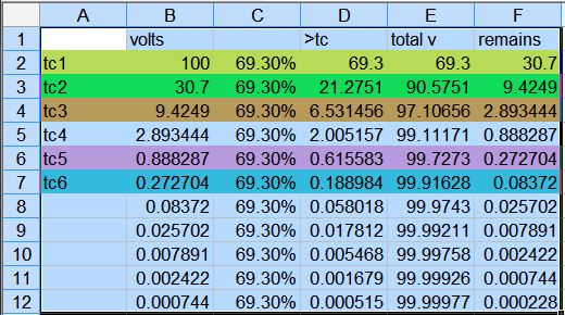

The OP did ask about .693 and Audioguru covered it with graphs, what I learned is that after 5 TC , the charge or discharge was considered done.
If you start a charge at 0 volt with 100 volts applied, after 1 TC1 the voltage is 69.3 volts,
during TC5, the capacitor charges 69.3% of remaining 0.888287 (0.615583) so now the voltage is 99.7273
during TC6, the capacitor charges 69.3% of remaining 0.272704 (0.188984) so now the voltage is 99.91628
The table carries the process out to TC11
Jeff
Your premise is false and your table is incorrect. Ln(2) =0.693147 is not involved in the energizing or de-energizing of a capacitor. The correct value for your example is 100(1-e^-1) = 63.2121 for the first time constant (TC) and 100(1-e^-5) = 99.3263 for 5 TC's.
Ratch
I just don't know, maybe electronics has change since I graduated, we only had slide rules back then and
It was close enough
It was close enough
I did 1/e on my old slide rule and got 0.368, accurate to 3 significant figures. Anyhow, '"good enough" depends on the application. The important point is that you do not think that the rise or decay of a RC circuit is logarithmic instead of exponential.
Ratch
It was close enough
Really? What course were you in where an 8th grade level math problem was allowed to have an error of almost 10%?
