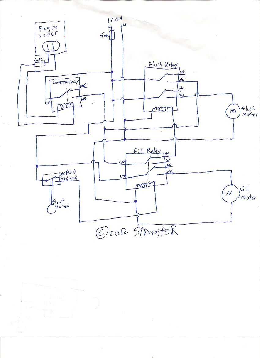

Fish tank flusher ladder diagram Vs. Fish tank flusher wiring diagram

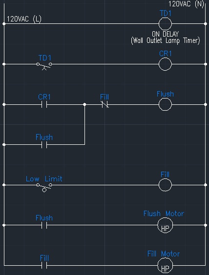

The next diagram will provide some general familiarization with ladder logic and with Timer relays:
70700d1360304053-8.jpg.html
I made this diagram for a member who wanted an automatic system to replace the water in his fish tank. He had a programmable lamp timer, 2 pumps, and a float switch. I will explain it:
. Starting out, the lamp timer (TD1) is plugged in, waiting for the preset time.
. Preset time elapses, TD1 energizes for only a few seconds and then deenergizes.
. During the few seconds that TD1 is energized, CR1 is energized, which energizes the "Flush" relay.
. The flush relay latches it'self through it's own contact, and stays energized even after TD1 deenergizes and subsequently CR1 deenergizes.
. (skip down to the second rung from the bottom) The "Flush" relay is energized, which energizes the "flush" pump motor. The motor is now pumping water out of the fish tank.
. (go one rung up) The flush pump continues to run until the low limit float switch is tripped, at which time the "Fill" relay energizes.
. When the fill relay energizes, (3rd rung from the top) it breaks the Flush relay's latching circuit, and the flush pump starts.
. (bottom rung) While the fill relay is energized, the fill pump motor is running, pumping water back into the tank.
. This type of float switch will not change positions until the tank is full - it is a "snap action" adjustable float switch. Once the tank is full, the fill motor stops.
. The circuit now lies in waiting for the next time that the lamp timer elapses. If at any point between now and then, the water level goes low enough, the float switch will trigger and fill the tank again (safety measure)
