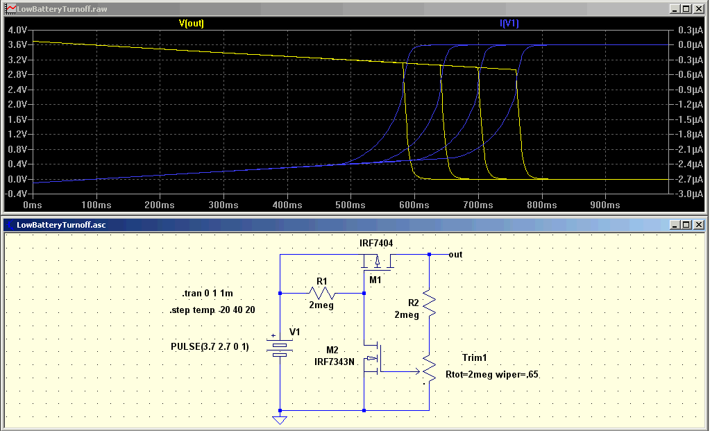

How about the following circuit? I haven't built it, but simulation shows it should provide a switch-off trip point varying by no more than 0.2V over a temperature range of -20C to +40C.
M2 should have a very low Vgs(th) (~1V); M1 should have a very low Rds(on) (milliOhms).
Battery drain is <3uA when 'on' and <5nA when 'off'.
It might need a small capacitor (or momentary switch) across M1 to 'kick start' it when first used.

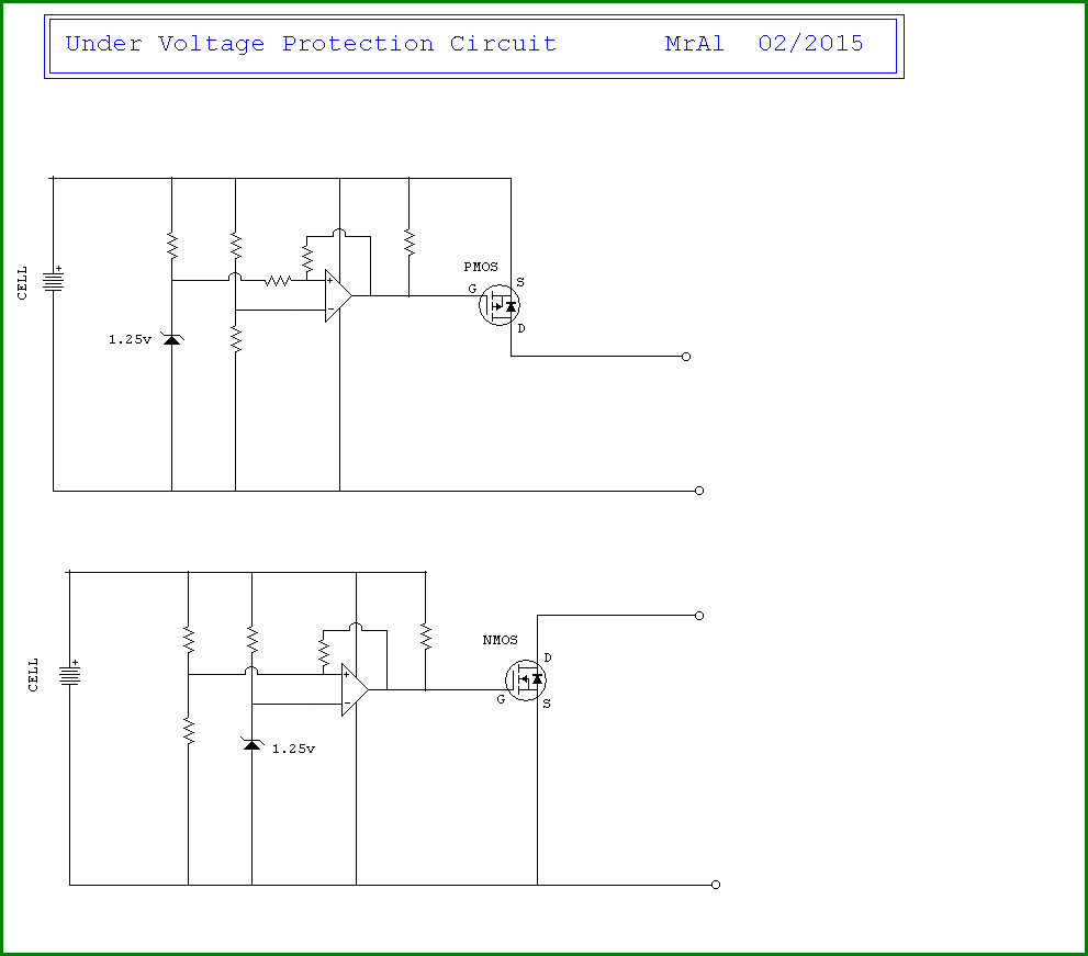

Do you have a schematic? We can tell how to do it with a schematic, but without one it is only guessing. Where is the voltage sense point on the circuit.

Your idea is good and it will work. Alternatively you can connect a PIN diode in series to the protection circuit. PIN diode forward voltage is only 0.4V + the 2.5V will give you 2.9V cut off. This way you don't wast current on voltage divider and it is more accurate. I guess that you realize that this change will also increase the max charge voltage cut off from 4.2V to 4.6V, over charge is dangerous too.
Here are two circuits that can be used. Note that the comparator has to be a micro power type, and all the resistor values have to be highish like 100k or greater, but not too much greater.
The run time from a full charge based on a 2000mAhr cell can be estimated from:
Years=Iua/228
where
Iua is the current in microamperes, and
Years is the run time in years.
So for example, if the circuit draws 228ua then the run time is 1 year. If the circuit draws half that or 114ua then the run time is 2 years. So the idea is to keep the run current down as low as possible. With a micro controller this is easy because we can put it to sleep and then wake up, check, then go back to sleep again. With a purely analog circuit we have to find a micropower comparator like the LT1017 or the LT6703 (the LT6703 would even simplify one of these circuits as it has built in voltage reference).
