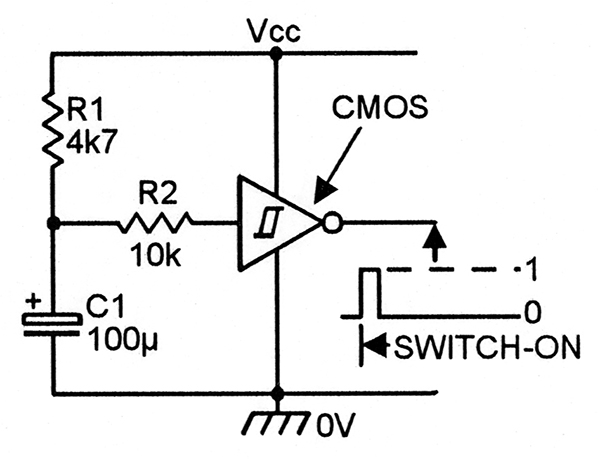

For a long time being unable to easily create a singular pulse, simulating something like a button press annoyed me. For example: I have two CD4017 chips in a sequencer. One of them is driving LEDs while other is used for logic signals. I did this because I did not want to bother with transistor buffers at each output. Both share same clock and reset inputs. But because we live an flawed World these chips are not in sync when the circuit is first powered on. LEDs and logic outputs don't match unless I give a positive reset signal at least for once. Even though this is not the end of the World it is very inconvenient. Yet I can't find a way to automate it.
Lets say I used the clock signal of the sequencer with a latch. Now I have a constant positive signal at latchs output. How will I make it a pulse though. Do I need another clock signal to pull the enable pin of the latch low, after that. Digially making this would require lots of work. In fact I already put more work into making two CD4017 work together inatead slapping some bjt buffers at the outputs already.
Or lets say I want a monolitic timer with NE555. But I want it to start as soon as when the circuit is powered on instead of connecting a button to trigger pin. There is no way of doing it as much as I know.

You are correct. The circuit in post #3 will not work with a CD4017.
To fix this, re-arrange the components. D1 and R1 go from the Reset input to GND, and C1 goes from the Reset input to Vcc. D1 remains pointed in the same direction - anode to GND, and cathode to the Reset input.
A problem with this circuit is that it works only if the 12 V source presents a relatively low impedance to GND when turned off. If not, such as the 12 V source is physically disconnected by a switch or circuit breaker, there is no low impedance path to discharge C1 so it is ready for the next power-on event.
One solution to fix this is to replace D1 with another resistor; we'll call it R2. Set R2 = 10 x R1. R2 provides a discharge path for C1 no matter what is happening on the 12 V rail. It also attenuates the amplitude of the Reset pulse by less than 10%, but this is well within the operating margins of a CMOS circuit running on 12 V.
For example, with:
C1 = 0.1 uF
R1 = 10 K
R2 = 100 K
the Reset pulse is approx. 1 ms, and the C1 discharge time is approx. 10 ms, plenty short enough to discharge C1 before the next power-on event. No opamps, gates, etc. needed. I don't know if this was stated before, but one R-C reset circuit can drive both 4017 Reset inputs directly.

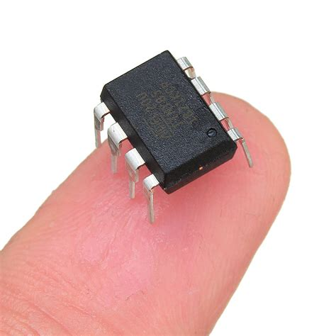

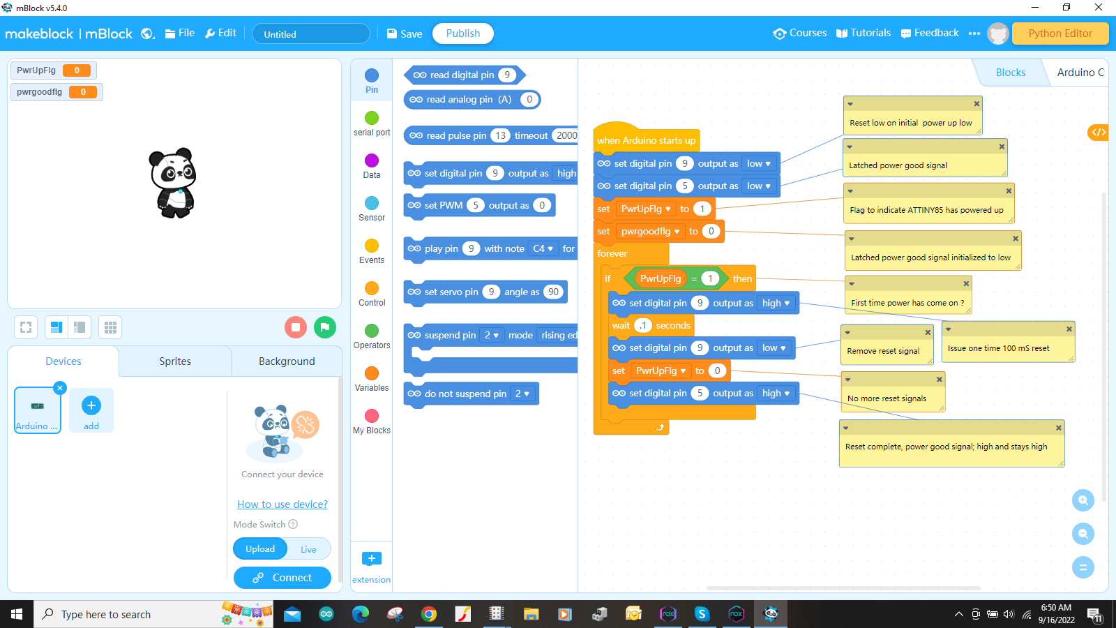

Back to your original post, can be done easily with a ATTINY85, here is code to
do it. Can add code to it to detect supply V and trip sequence of reset and power
good from that. This is mBlock, you program in blocks and mBlock then converts to
Arduino code. That is followed by using an Arduino board, like Nano, to program an
ATTINY85. Could even code turning on power to other circuits, eg. make a power
sequencer using it.
ATTINY85 -
Regards, Dana.

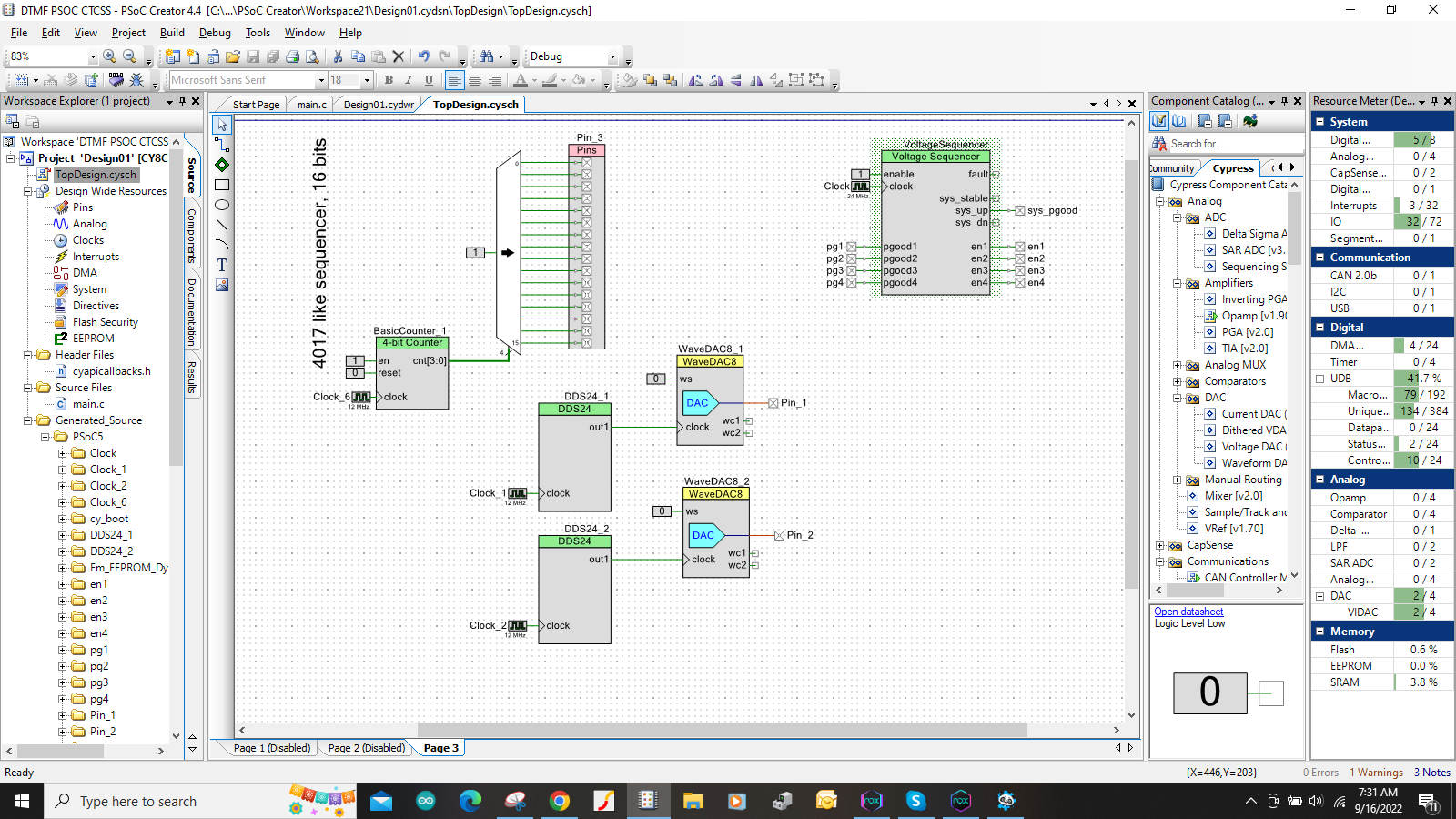

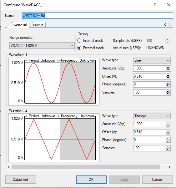

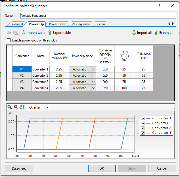

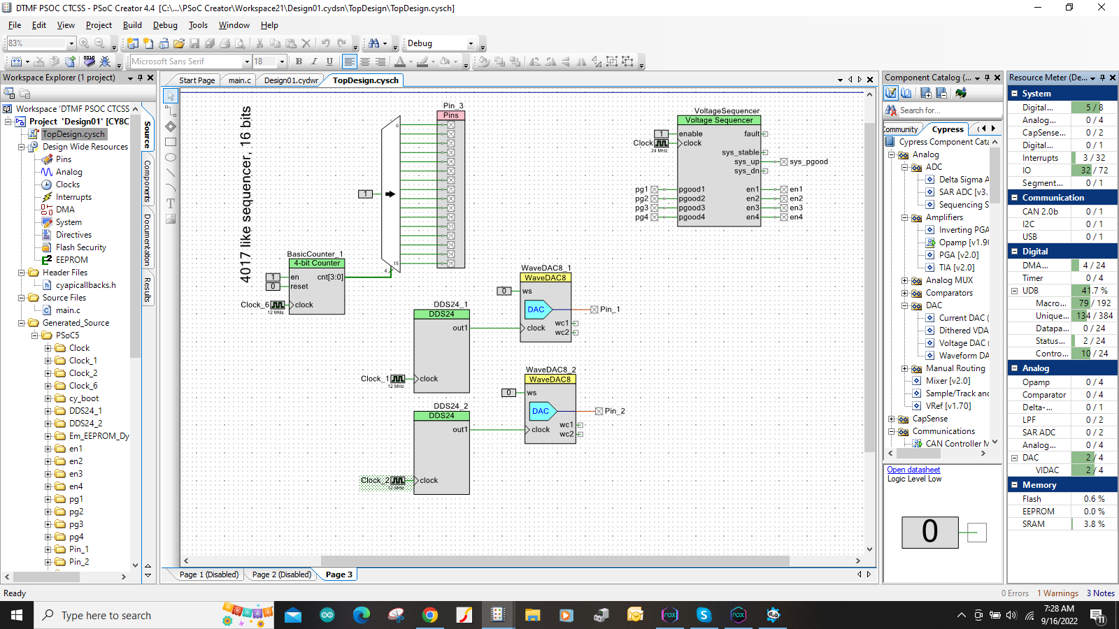

Then there is always do the power control and sequencer and wave generation on
one chip.....here two wavedacs shown, could have done 4. 16 bit sequencer, could
have done 32. Very little code for most of it required.
Note right hand window, top pic, lots of resources left for other uses.
Regards, Dana.

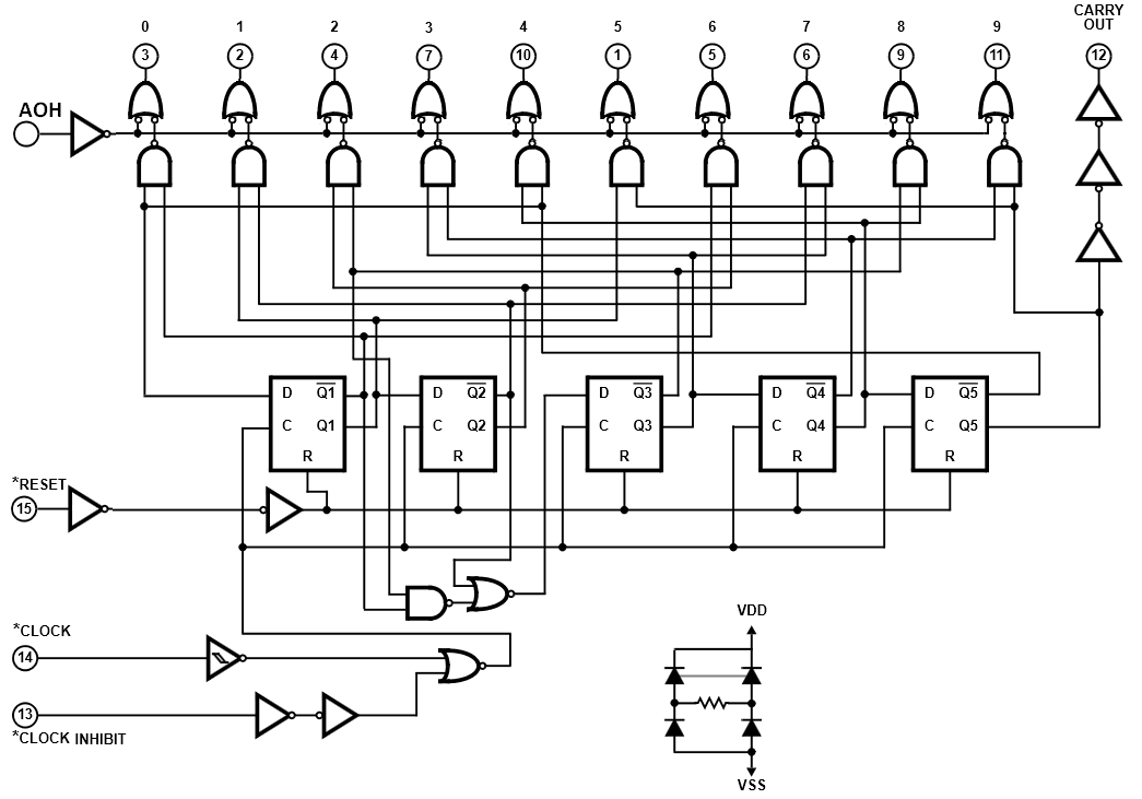

Do we know precisely what the internal logic looks like ?
Yes. All of the old 4000 series parts were documented down to the individual-transistor level back in the day.
What happens when we violate that ?
If by "violate", you mean a reset pulse narrower than the stated minimums, then the part might not reset correctly.
BUT - That is not the case here.
The Reset input signal comes from an R-C exponential ramp, so there is no contact bounce on the leading and no contact grinding noise on the trailing edge. The only possible issue is a noise burst at the output of the first inverting stage in the Reset signal chain. This is possible because a CMOS inverter is in fact a high-gain linear amplifier that spends most of its life with the output saturated either high or low. There is a very narrow part of the input signal range that puts the output within its linear range. Across a few millivolts of input transition, the first stage output can be a linear noise burst. This noise burst is amplified by the next inverter in the signal chain, and the output is full-amplitude squarewave noise. That noise will do nothing.
Nothing, because the Reset signal does not clock a toggle flipflop or counter. It drives the *asynchronous* reset inputs of a group of five flipflops. After the first transition, whether from a super-clean source or a noise burst, the flipflops are reset. They just sit there no matter how often you bang on them, wide pulses, narrow pulses, whatever, Reset is reset. This is true for both the leading and trailing edges of the input reset signal.
Noise on a clock line and noise on a reset line are very different things. As long as the clock and enable inputs are stable, no amount of noise on the reset line can cause the part to un-reset (go to a non-0 state).

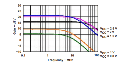

CMOS gate gain, transition region :
HC Logic above. Gain of 10, so transition region wider than you suggest...more than a few mV.
Note some parts do have steeper transitions higher Gm mainly the buffers
And then we have the transition region current rise dumping noise onto Vdd and Vss. Further
aggravating transition eg, self generated noise. Not counting external noise on supply rails.
Regards, Dana
1983 RCA book shows some parts down to the transistor level, others like the 4017 no public
transistor level drawing I could find.
