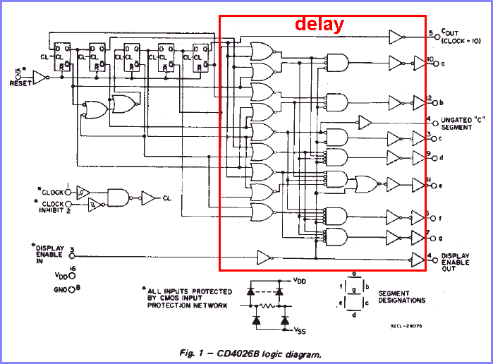

Is risky because the reset pulse is very short.
I do agree in general that if you decode the state by external gates at counter bistables output for most counters, it would be risky and a F/F is the proper way to do it.
But not for the case of 4026. It is done at the 7-segment decoded outputs and thus there is already some delay. After the external added decode logic picks this up and remove the reset pulse to the 4026, there is yet another delay. If one is still not satisfied, a 10nF capacitor on the reset pin would give yet more delay as pebe had mentioned.
From the data sheet, the reset pulse propagation to the 7-segment decoded output is typical 300nS and the worst case requirement on min. reset pulse width is only 120nS.

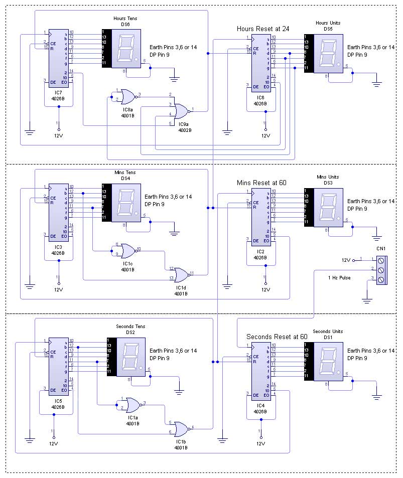

I am looking to build a digital clock using 7 seg LED diplays. I have built and tested the following on breadboard using 4026BE ICs.
All displays seem to reset OK.
The Hours reset at 24 and the mins and seconds at 60.
The only way I could see to reset at 24 was using a 2 input Nor and a 4 input Nor gate. Pin 5 of the 4 I/P Nor is connected to the 2 OP of the Tens digit (goes low when couinter >2) the other 3 are connected to the Units digit display OP.
I have searched the Net and cannot find an example cct showing this.
Is this the easiest way or does anyone know of a better way of doing this?
Brett.
