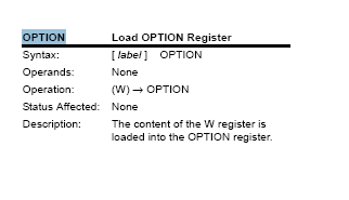

Sorry, I don't do Basic. Do you have bit<5> of the Option register set to 0? Notice it is set to 0 in my code.
Source = datasheet
5.3 TRIS Registers
The Output Driver Control register is loaded with the contents of the W register by executing the TRIS f instruction. A ‘1’ from a TRIS register bit puts the corresponding output driver in a High-Impedance mode. A ‘0’ puts the contents of the output data latch on the selected pins, enabling the output buffer. The exceptions are RB3/GP3, which is input only and the T0CKI pin, which may be controlled by the OPTION register. See Register 4-3 and Register 4-4.
John

Had a quick look and can impose ASM into the basic and have managed to get the OPTION register to change by writing the OPTION code "bits". I added the code like this -
ASM
movlw b'11000000' ; weak pull-ups disabled
option b'00000000'
movlw b'001000' ; sets all pins to output, except GPIO,3 (pin4)
tris GPIO
endasm
Works now ! Tomorrow will be spend tidying up and and labels.
Great result thanks very much again
Colin (now its definitely bedtime)
I am delighted it worked for you. Just one point, "Option" does not need an operand. It will load the Option register with what is in "w."
