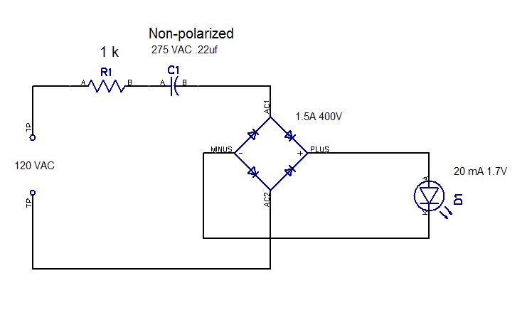

To run an LED from 120V or 240V AC, you can use a capacitive dropper. They use the AC impedance of a capacitor:
1 / (2 x PI x F x C)
in place of a high value, high power resistor
A 0.22uF capacitor has an impedance of around 12000 Ohm at 60 Hz.
That would give about 9mA at 110V, or 19mA at 230V
With a bridge rectifier that's the current the LED would get; with just a parallel reverse diode, it would average half of that.
You also add a relatively low value resistor to limit surge current for when the circuit is powered on.
It's a very common circuit principle, in things that can be totally insulated so there is no possibility of anyone touching the parts - they are live at lethal voltages!
The image below is an example I found on google, though I think they have calculated the current incorrectly.
You would need that twice, one for each LED.
Connect the resistor input to the live or neutral pin, and the lower connection to the ground pin.
Preferably use X or Y type capacitors, or one rated at least twice the maximum AC voltage, for reliability.
Personally I would avoid the use here of any LED colour other than red, yellow or orange. Green is often used to indicate a 'go' or 'safe' condition, such as an Earth potential, so in my view is dangerously ambiguous for indicating the hot terminal.

Thank you for your very detailed reply, it includes calculated values for each component and safety conditions, I appreciated it!
Thank you for the socket testers, I will look it up!
I thought about using a bridge rectifier actually, but the point is when using a bridge rectifier, the direction of the current is always determined. Even if reversing the direction of the plug, the current behind the bridge rectifier always has a fixed direction, so I cannot determine when the LED should be on and when it should be off depending on the direction of the current from the AC source.
So correct me if I am misunderstanding something!
Totally agreed! However, I think it's for public use. This LED-stuff is used to integrate into a small electrical box, it acts as a small tester or measuring device. No one has the right to touch it except me, and I also use it infrequently. Therefore, I think it is acceptable in terms of safety.
AC = Alternating current; the polarity reverses twice during each AC cycle.
Correct or incorrect wiring changes which pins socket pins the voltage is between, not the "direction" of current; eg. if L and N are reversed, the N to E light will be on instead of the L to E light.
If there is no ground, both will light up regardless of L <> N being correct or not, unless you test with a separate ground to the Earth point in your tester to
Thank you for your response!
Oh my bad! It's the direction of the plug, not the "direction" of the AC current. Thank you for your explanation, I see now :)
I forgot the important point in your post, the Earth pin. So I understand that there will need to be 2 separate circuits for the 2 LEDs, one will be L-E, and E-N for the other. Unfortunately, grounding is not always available in my place. Even in my house, the electrical system does not have a ground wire so I must use RCBOs for safety.
So in my understanding, this idea's not possible without using ground wire, right?

Exactly - but there's no real difference between live (hot) and neutral (cold) anyway, it's just that the neutral is normally earthed at the sub-station - which is why you can get a shock from live (hot) to ground.
I also wouldn't be that trusting of RCBO's if you don't have an earth on your electrical system,
