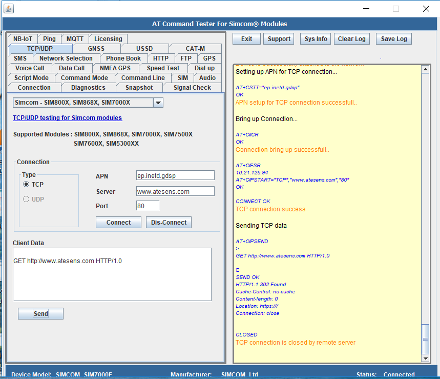

Hi, I'm using a TCP connection with a SIM7000 module, but I receive 302 response. So I suposse I need to use SSL over TCP. Any suggestions?
302 is a redirect message...
Yes, but it sends me the redirect message(302) when trying to communicate with www.atesens.com, which has https://. But when trying, for example, with httpbin.org which has http:// it works fine (response 200). So I thought maybe could be something related to SSL certificates.

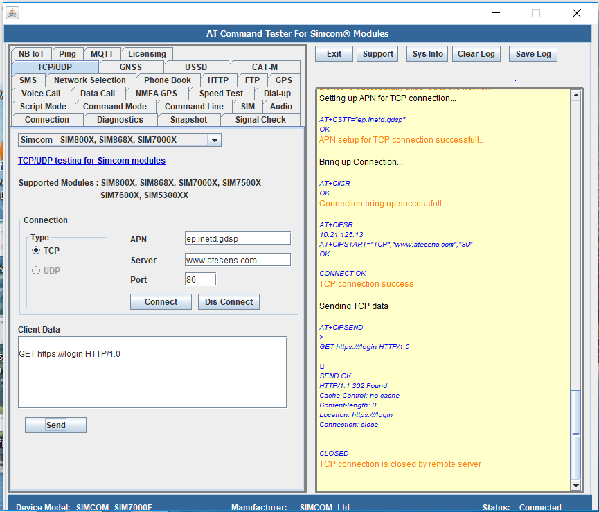

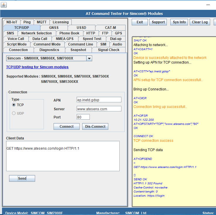

I've tried with https://www.atesens.com/login but also 302 response.
AT+CIPSEND
GET https://www.atesens.com/login HTTP/1.1
SEND OK
HTTP/1.1 302 Found
Cache-Control: no-cache
Content-length: 0
Location: https:///login
I've also tried to put http:// instead of https:// but the same error.

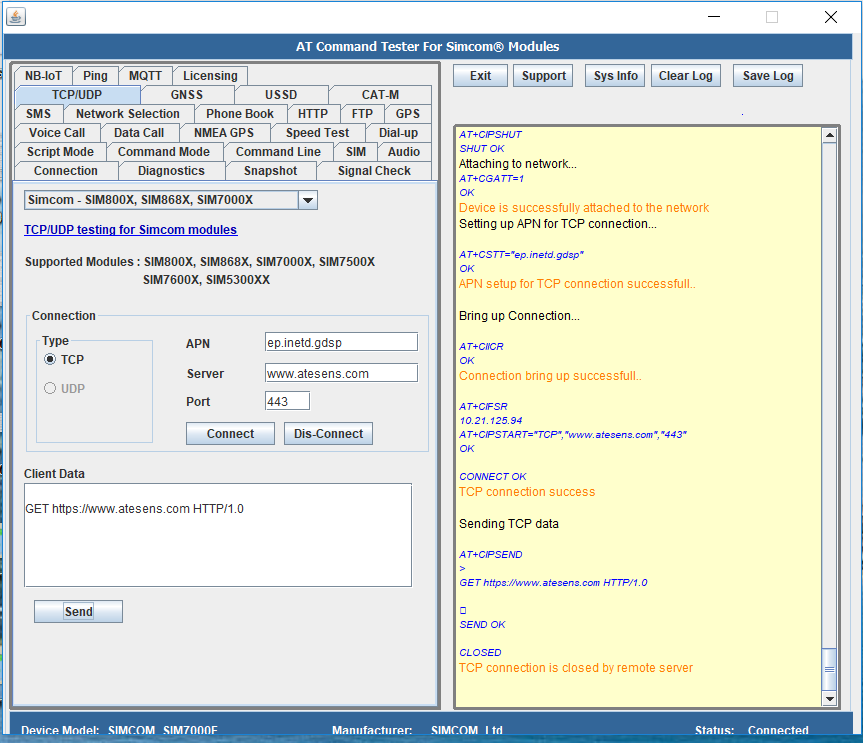

Also you may notice that the port I've selected is 80, that because when I select 443 this is the response I get (the other configuration being the same as in the image):
AT+CIPSEND
SEND OK
eTech I have tried diferent options, but also have tried connecting to port 80 and then attempting to communicate over por 80 (http://...).
And also have tried to connet to port 443 and then attempting to communicate over 443 (https://...).

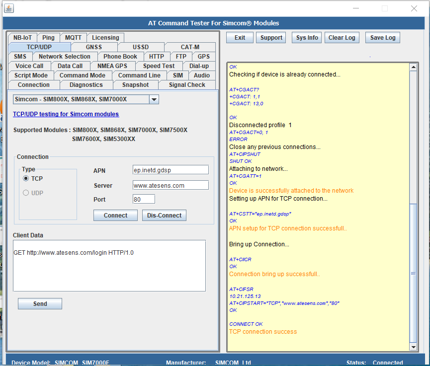

Try this:
Connect using port 80
Do Get using http login url
When response 302 is returned
Do Get using the url in “location” field of 302 response message.

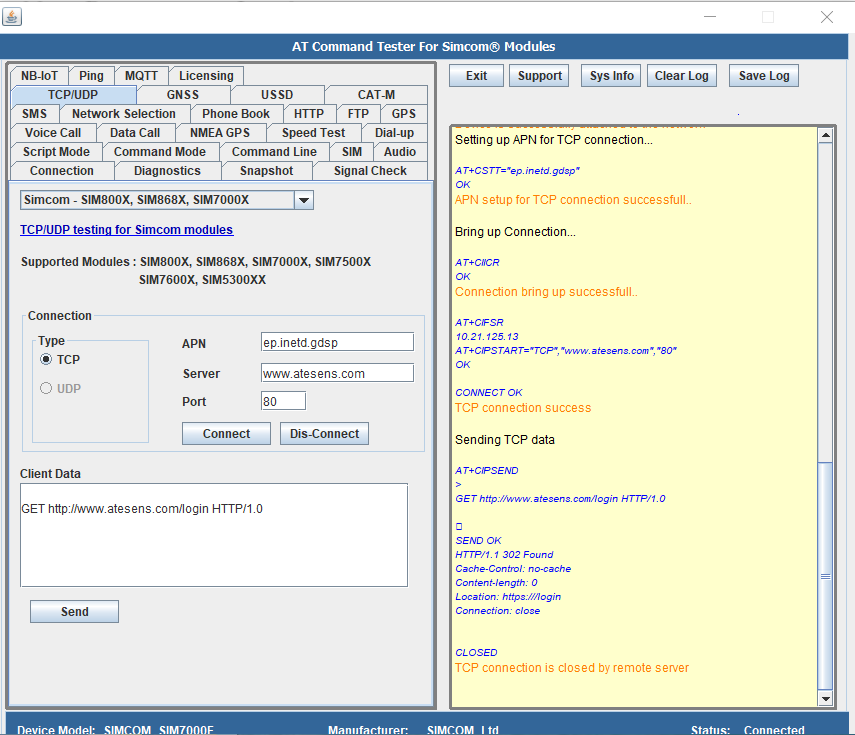

OK, this is what I get with the initial login:
And looking at "Location", I gues I have to put https:// , but I get the same response.
If I try the https:// with port 443 connection this is what I get, something, a character that can't be read:

take the "HTTP/1.0" off the end of the GET string
