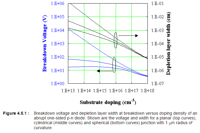

The transfer characteristics of zener and pn diode looks same in reverse bias, i have asked few why in many rectifier circuits zener is used.i got answer like, it wont burn up in high reverse current like pn diode . why zener is special than pn diode.
" Since the diodes will break down in the regions where the breakdown field is reached first, one has to take into account the radius of curvature of the metallurgical junction at the edges. Most doping processes including diffusion and ion implantation yield a radius of curvature on the order of the junction depth."
Zeners are made more rugged by the above methods. But in low current situations, I have used for example the Vce max as a zener for regulating the HV in a horizontal sweep in late 70's when our colour TV broke.
That worked.

In a Zener diode, the breakdown is the controlled parameter. Also remember that there is Zener and avalanche breakdown mechanisms. I believe at 5.1 V both are going on simultaneously. Breakdown isn't destructive if the current is limited.
