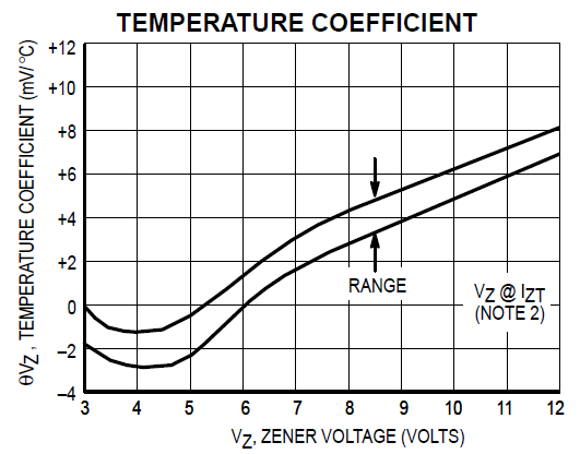

I buy and use zener diodes, I do not make them so I do not bother if they zener or if they avalanche.
If you look at the datasheet for a family of zener diodes you will see that a 5.6V one has close to zero temperature coefficient.
A smaller voltage zener diode has a negative and a higher voltage has a positive temperature coefficient.
A zener diode that is about 7V has the best voltage regulation.
I found this graph but it did not agree with datasheets so I fixed it so that 5.6V has a zero temperature coefficient.

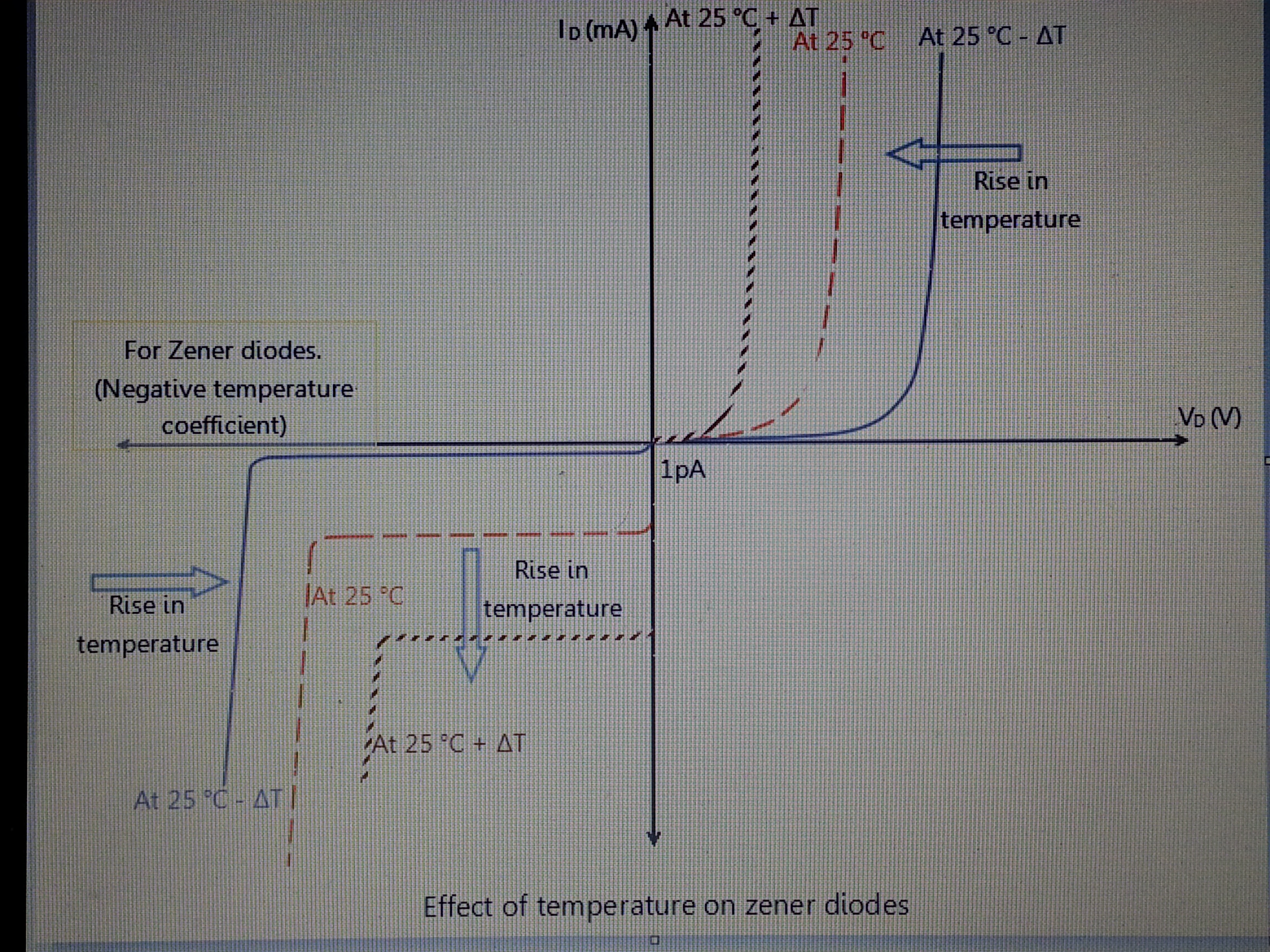

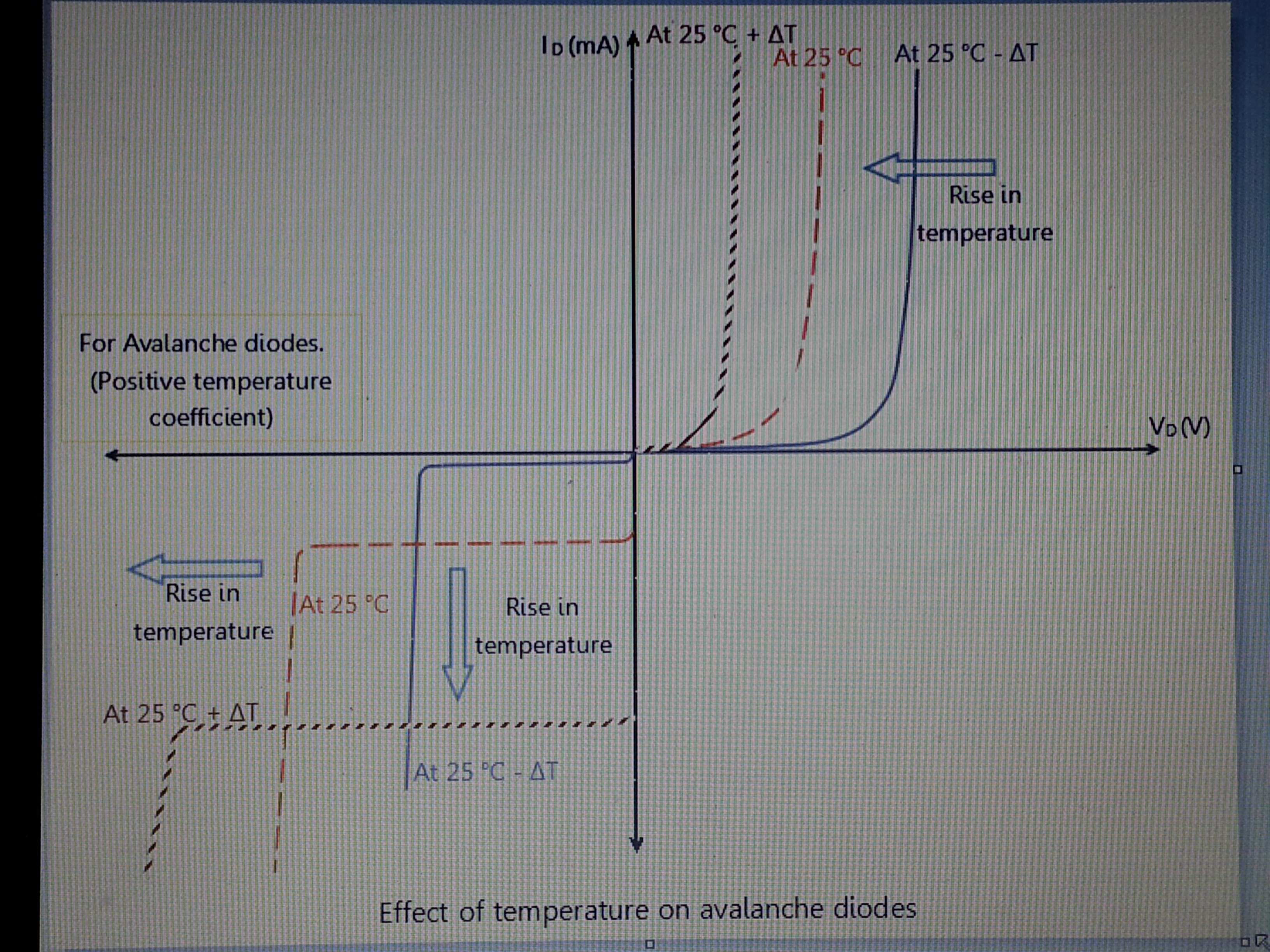

Hi audioguru
Thanks for the reply.
Actually i wanted to understand how the reverse breakdown voltage changes with temperature. As you said, it doesnt matter whether they are zener or avalanche when we use it. But just for the sake of theoretical knowledge, what is the difference.
I had two diagrams showin the difference. Although the curves are shown far apart, its just for illustrative purpose. Do u think the graph is correct. I am not sure about the authenticity of the graph

I do not know what you want to know and I do not know why.
Haa haa, My first reply was indeed confusing, I admit:).
Thanks crutschow for your valuable input.
Let me try to explain again what i want to know. There are two types of diodes-Avalanache and zener. I just want to know that does avalanche diodes have positive temperature coefficient and zeners have negative temperature coefficient?
Yes they do. Just don't ask me why. :rolleyes:

"Actually i wanted to understand how the reverse breakdown voltage changes with temperature. As you said, it doesnt matter whether they are zener or avalanche when we use it. But just for the sake of theoretical knowledge, what is the difference.
I had two diagrams showin the difference. Although the curves are shown far apart, its just for illustrative purpose. Do u think the graph is correct. I am not sure about the authenticity of the graph"
They both look good to me.

In my post #2 I showed a graph I found that shows that a low voltage zener diode has a negative temp coefficient, a 5.6V zener diode has zero coefficient and a higher voltage zener diode has a positive coefficient. But before I found the graph I saw the results printed in text on a datasheet of a family of zener diodes.
