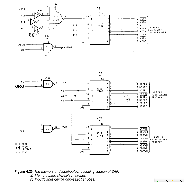

My problem is I'm also putting a Texas Instruments SN76489 PSG into the computer and I only have one chip enable line available, derived from A15 on the Z80/Z84.
I was thinking I could enable the sound chip at the same tine as RAM as it wouldn't play sound unless told to, even if enabled.
Is this an idea that would work?

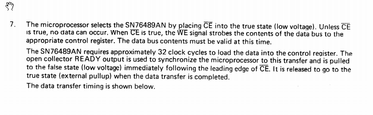

The SN76489 datasheet does not show any input latches, so you may need a 8bit wide latch on the input.
Which decoder for the address lines are you using.? eg: 74LS138 etc./
E
EDIT:
The text suggest that the registers may be latched.????

I was using the layout on page 111 of this book which is also online here books.google.co.uk/books?id=mVQnFgWzX0AC&pg=PA111&vq=111&output=html_text&source=gbs_search_r&cad=1 .
Additionally there are 3 8T97's on the address lines earlier in the book.
I now need address lines A0 through A14 for the larger RAM and ROM so was going to change this wiring completely.

The other thread basically just uses a NOT gate to select RAM if the ROM is not being read which is fine if only those two chips are present. I'm starting to think I could use a NAND gate to enable the PSG if both the RAM and the ROM are not enabled.
Have you considered using IORQ, with an address decode CS and setting the tone IC as a peripheral.?

The PSG would be on the Z80 PCB, as most IORQ devices are located.

I guess you have 32k ram and 32k rom, so you are using that A15 to switch between ram and rom, so that uses the whole 64k address space. But there is more space for I/O as Eric was saying. That's the normal way to work with i/o anyway, no matter what it is. Use a decoder and some gates to decode when an i/o operation is in progress and you can easily create 8 complete i/o ports for any use. The gating might be a little tricky but doable.

...there is more space for I/O as Eric was saying. That's the normal way to work with i/o anyway, no matter what it is. Use a decoder and some gates to decode when an i/o operation is in progress and you can easily create 8 complete i/o ports for any use. The gating might be a little tricky but doable.
The design in the book uses two 7442 IC's to create 8 I/O reads and 8 I/0 writes (I believe this is also the example in the 7442 datasheet) so, it looks like I have the start of your solution.
I have one write only parallel port, a serial keyboard port, and one RS232 serial port so, I have five write signals and six read signals free that I could use for the PSG.

Oh i didnt realize that you were not using the entire 64k address space. With 32k ram and only 2k rom, you have some of that address space available, unless of course you intend to increase the size of the rom, and then you should use i/o anyway. But if you can limit the rom to say 16k, then that gives you one address line that wont be used for addressing anything when the ram isnt selected with A15, so you can use that AND'ed with A15 to access 16k of something else, like your sound chip or similar. So you would AND an inverted A15 and non inverted A14 and that would be your enable for that missing 16k space. This means that you cant use that for addition ram in the future though too, unless you provide more gating and limit the ram to something smaller than 16k. Bank switching is always an option too though if you dont mind the extra complexity.

Is the attached schematic how your IO decoder looks like? Which are the IO lines being used and which are still free?
