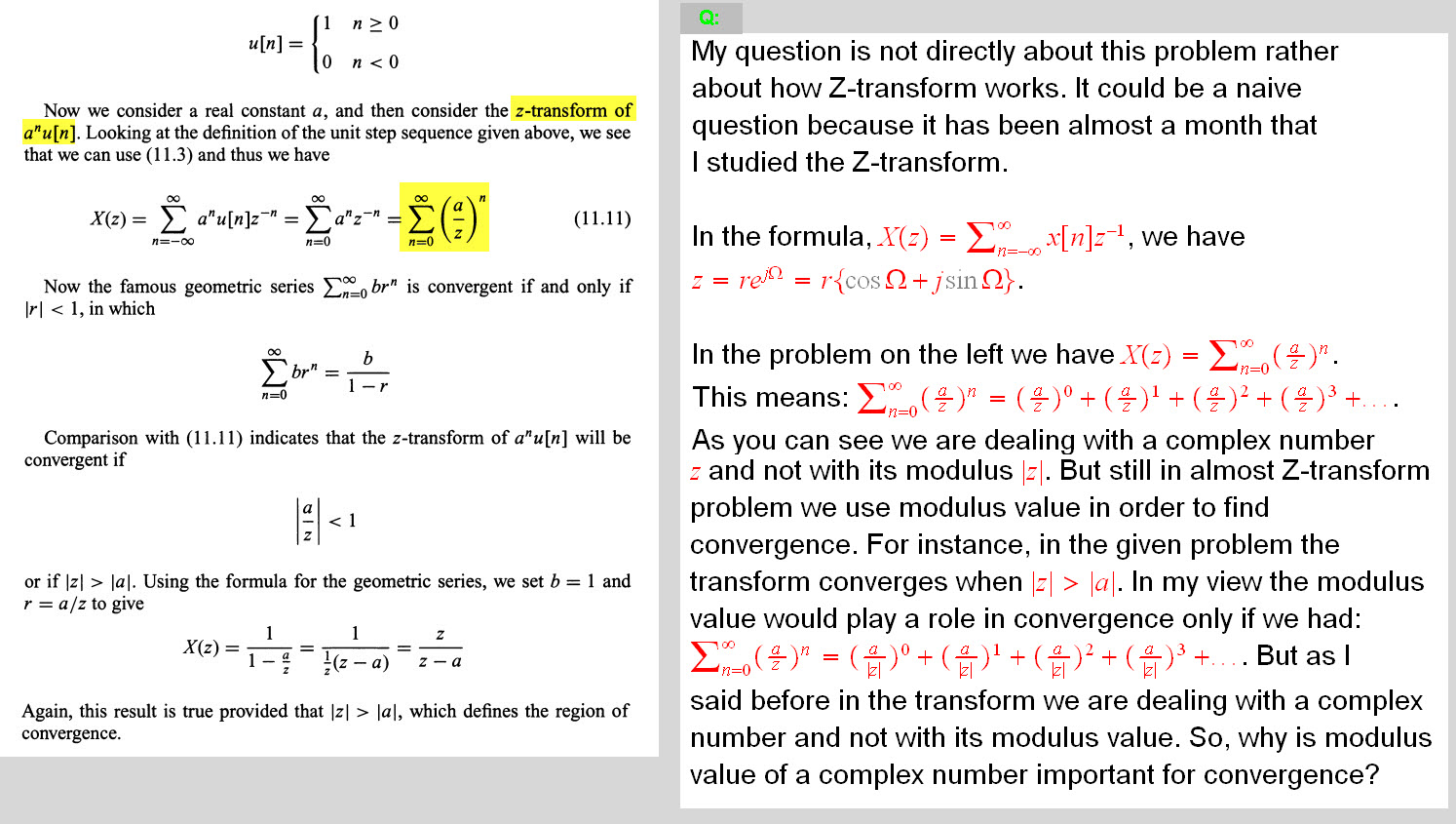

Hi
Could you please help me with this query? Thanks a lot.

Remember that z=|z|exp(jθ), and z^n=|z|^n exp(jnθ).
exp(jnθ) is just the phase term and always has magnitude equal to one. Hence, the phase part does not create an issue for convergence. However, the |z|^n part will diverge as n goes to infinity, unless |z|<1 .

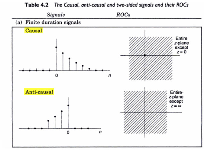

Hi
Q1: The mathematical definition of causality states that a system is causal if all output values, y[n0] , depend only on input values x[n] for n<=n0. Another way of saying this is the present output depends only on past and present input values. Then, it says that y[n]=x[n]+x[n-1]+y[n+1] is a non-causal system and also note that y[n+1] can be written in terms of x[n]. How can we write y[n+1] in terms of x[n]? I know it's a very basic questions but... sorry! Thanks.
Q2: I don't see how they say the right-sided sequence is causal and the left-sided is non-causal. In other words, I find the terminology 'causal' and 'non-causal' confusing in this context and as I see most texts simply refer to sequences as right-sides, left-sides, and two-sided. How can you say that right-sided sequence is a causal one? Thanks.

Q1 EDIT: I'll make it simpler than what I said before. You can use y[n+1]=x[n+1]+x[n]+y[n+2]. Then you can see that y[n+2] can be expressed with other samples of x[n] and y[n]. This leads to an infinite summation,
hence, [LATEX]y[n+1]=\sum^{\infty}_{k=n} x[k]+x[k+1]\ \ ,[/LATEX]
Q2 It's just terminology, so don't let it confuse you. If someone called them "Jim" and "Sally", would you worry that they are human? No, they are just labels. However, I believe that the origin of the labels comes from the fact that impulse responses of a causal system look like one type and impulse responses of a noncausal system look like the other type. So, the naming has a logical basis. So, your question should really be, "what is the origin of the terminology?". Hopefully, my answer about that is correct, or "correct enough".

I believe I should just understand that a right-sided sequence is called 'causal' and the left-sided sequence 'non-causal'.
OK, let me clarify what I was trying to say. It turns out that a causal system has an impulse response that is a right sided signal. It also happens that an anti-causal system has an impulse response that is a left sided signal. So, the systems are the things that can be causal, anti-causal or non-causal. The signals are not really best described that way, but somehow the terminology has been carried over.
Also, note that there is a difference between "anti-causal" and non-causal. An anti-causal system is analogous to the causal system in that it does not depend on past value. However, a non-causal system is just one that is not causal, which is not necessarily the same thing.

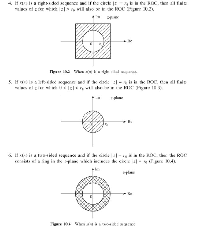

Hi
One of the properties of region of convergence for z-transform is that it contains unit circle. What does it really mean? I understand that at |z|=1, z-transform is equal to DTFT. Could you please comment on this?
Is this really true that z-transform deal with IIR systems and DTFT deals with FIR systems? I understand that z-transform is generalized form of DTFT. Thanks.

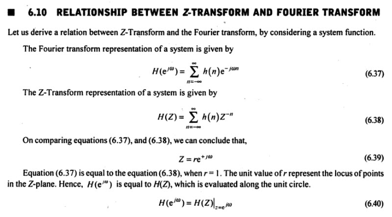

First, you can use the z-transform for either IIR or FIR systems. The z-transform is analogous to the Laplace transform in that it is a more general transform than the FT, and includes the FT as part of it.
For a continuous time system, the s=jw axis in the complex plane is the domain of the FT. Also, convergence depends on the function. System stability is determined by poles not being in the right half plane.
Mapping from continuous to discrete is determined by z=exp(sT) where T is the sample time. The s=jw axis in the s-plane then gets mapped to the unit circle in the z-plane. Also, the right half of the s-plane gets mapped to the outside of the circle and the left half of the s-plane gets mapped to the inside of the circle. So, poles must be inside the circle for stable systems.
To add just a little...
Anything in the 'z' plane consists of a real part and imag part just like with the 's' plane which could be written as a+bj just like any other complex number. Also, the entire left 's' plane maps to the 'z' plane by 'warping' the plane into a circle who's radius is 1. Thus any complex number that 'fits' inside the unit circle on the 'z' plane must exist in the left hand plane of the 's' plane.
Since the radius equals 1, and we know that converting a rectangular to polar means first finding the length, all this means really is that the length must be less than 1. To find the length we use L=sqrt(a^2+b^2) of course, and because we measure from the origin (0,0) outward if this length is less than 1 then the point must lie inside the unit circle.
Another quick way of looking at this is that the unit circuit can be generated by mapping all possible points that are a distance of exactly 1 unit from the origin, or by rotating the line that extends from (0,0) to (1,0) around the origin keeping the point (0,0) fixed at the origin while allowing the other point to move around, but keeping the length of the line equal to 1 at all times. This line then sweeps out all the possible solutions to what lies inside the unit circle.

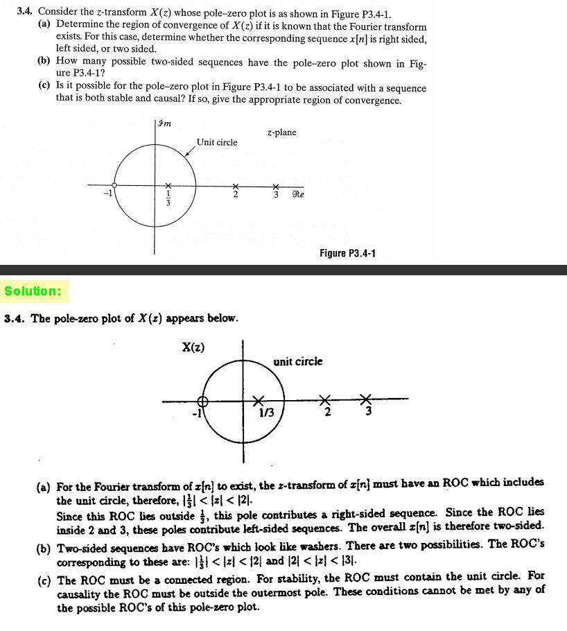

Q1:
The full question along with its solution is here.
Let's start with the first part.
(a): It says that DTFT for the given sequence exists. We understand that at |z|=1=|e^jw|, z-transform is equal to DTFT. So, the unit circle must be part of the solution. By the way, what would it imply if it wasn't given that DTFT exist? I think it would imply that ROC exists for |z|<|1/3| and it would also imply an anti-causal sequence.
I don't understand anything in the solution where it says, "Since this ROC lies outside 1/3, this pole contributes right-sided sequence. Since the ROC lies inside 2 and 3, these poles contribute left-sided sequences. The overall x[n] is therefore two-sided". If it were to me, I would simply say that since the ROC lies between poles 1/3 and 2 which gives ROC in form of a washer therefore the sequence x[n] is two-sided sequence.
I think these properties of z-transform are relevant here.
