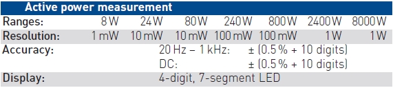

Hey,
I've found the following **broken link removed**(specification) which is for rent.
There is something I dont understand about its active power accuracy:
What does it mean -
Accuracy: ±(0.5% + 10digits) ?
Thank you.
Doesn't makes much sense to me, normally it is + or - 2 or 3 digits.
Whatever the reading is will have a ± 10 digits error in it, on top of the 0.5%
e.g. 800W range , resolution is 100 mW , is 0.1 Watt,
± 10 digits makes the error ± 1 Watt.
Thank you very much RODALCO.
Please let me see if I got it straight.
for 800W @ 100mW resolution:
±0.5% = ±4W (= ±0.5% * 800W)
±10 digits = ± 1W (= ±10 * 100mW)
Am I correct so far?
If so, does it mean that the max error at 800W range is ±5W?
Correct !
Bear in mind that it is the max. error.
Overall error will be less in most cases.
