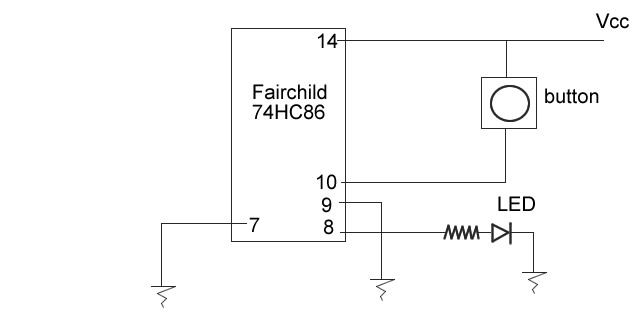

I'm quite a newbie at electronics. I bought a Fairchild 74HC86 quad XOR gate and built a circuit as seen in the picture.
For the power supply I use the same power supply as the standard PC kyb uses (I disassembled it and connected it to the computer) Vcc=4,78V.
The circuit doesn't seem to work though. I've tried several things, and if i connect Vcc to pins 9 ans 10 the LED shines up, but after I break disconnect pin 9 or 10 the LED shines for about 1/2 a second before going off.
Could there be a problem with the input current - from the KYB? It seems as if the chip is leaking???? :(

You have make the classic mistake that thousands had made.
74HC86 is a CMOS device and all its input pins are high impedance. That means you must "fix" the pin voltage at Vcc or ground and never to let them unconnected.
You can do that by directly connecting the pin to Vcc or ground or connect them using any 1K ~ 100K resistor.

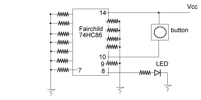

I did that, and it isn't any better. I measured the input current though. It's 66mA, and the datasheet says it should not exceed 20μA.
Is there a way to lover the input current?
Even pin-10 needs a resistor to ground...when the button is open it's floating. 10K would work. If that doesn't solve it...disconnect the LED and Button (leave grounding pin-10 resistor)...with all inputs grounded and all outputs open, if you still get high current, you've let the "magic smoke" out and it's dead. :(
Ken
The max input leakage current for 74HCxx Cmos is only 0.1uA when its supply voltage is at its max allowed voltage of 6V. The current is less at 5V.
The max allowed output is 25mA but an output will try to sink or source 66mA if you don't limit the current.
All unused inputs must be grounded or be connected to the power supply voltage so they don't float.
Thanks for the answeres. If I understand the whole thing should look like this (attached pisture)
All resistors (except tle LED one) are 10K

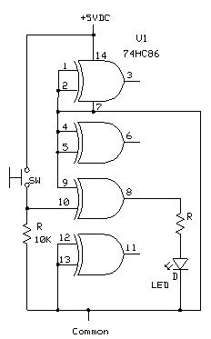

Volk,
Attached is a schematic of what you need to do.
All unused outputs (3,6,11) are left open.

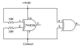

All unused inputs (1,2,4,5,9,12,13) must be tied to common or +5v, through resistors or directly (see examples in second schematic).
The button input (10) is tied to common through a resistor, so when the button is open it is pulled to common, and when the button is closed it is pulled to +5V.
The output (8) with the LED/resistor is OK.
If you are still getting high supply current with the LED off, the chip is toast.
Hope this helps.
Ken

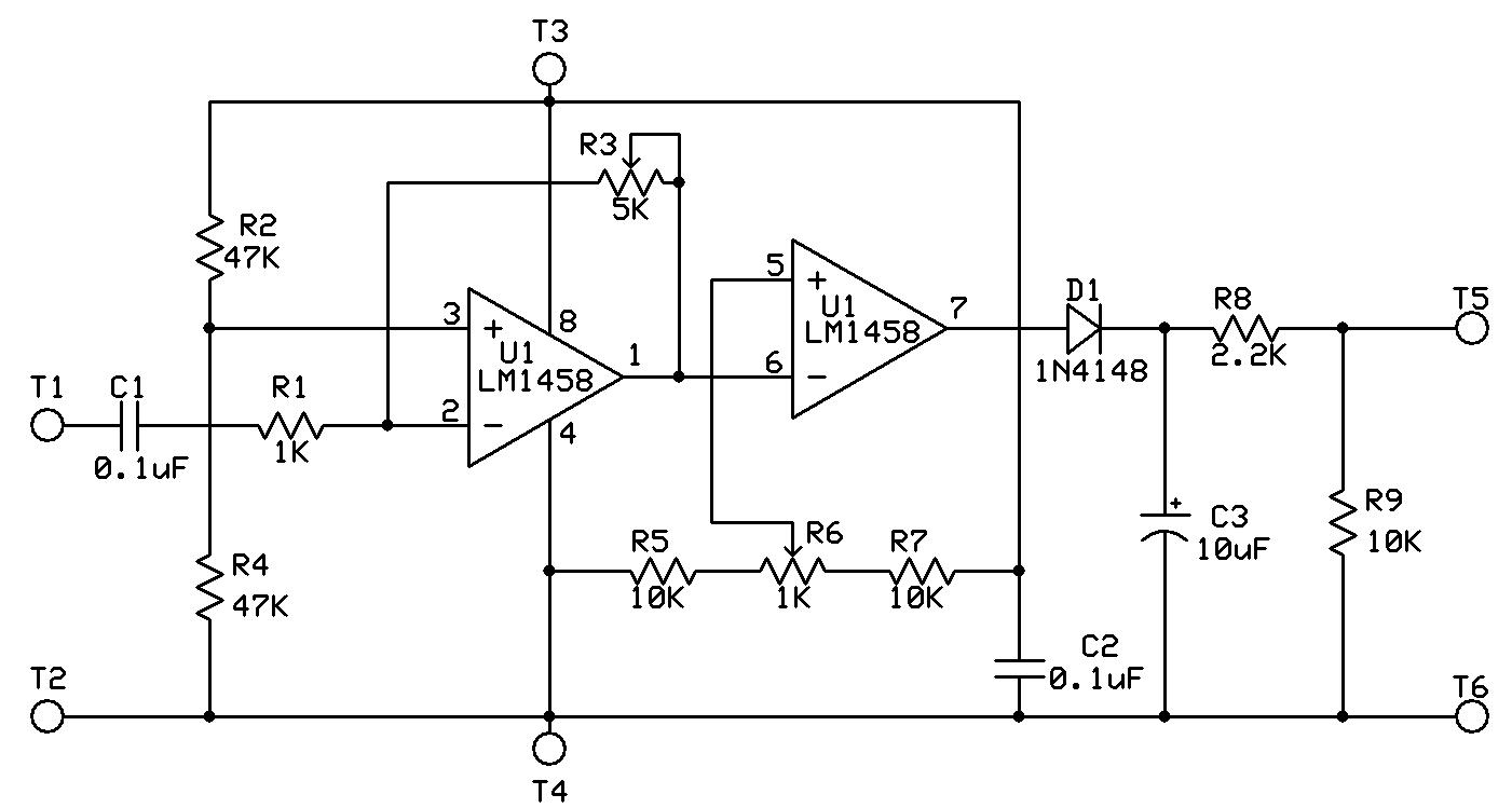

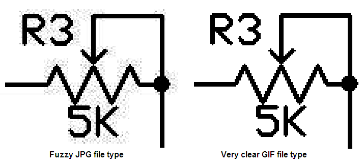

Hi Ken,
Your schematic looks pretty good even when it is a fuzzy JPG file type.
The JPG is lossy so it produces "fuzz" dots around every line.
GIF and PNG file types have no loss so are very clear.
I zoomed in and increased the contrast for this comparison:

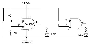

So if I want to control 2 LEDS, and the first one is connected to the first XOR gate and the second one to the second XOR, and I want that the first one on untill i press the button. when the button is pressed the scond one should light up.
I hope I got the scheme right this time.

Reverse the position of the 10k resistor and the pushbotton switch. resistor to +5 and switch to common from pin 2.
Look near the bottom for th truth table for XOR...1 = +5v and 0 = Common. This should help you figure it out in thefuture.

Ken, looks to me like he is right and you are wrong. Were you looking at the XNOR truth table?
EDIT: I am assuming the switch is normally open, as shown.
Volk...and Roff,
I owe you an apology. You were right and I was wrong. I've been sick for the last couple of days and for some strange reason yesterday morning I thought I was good enough to at least get online...and I defininatly wasn't. When they warn you about not to "operate heavy machinery", I never put a keyboard in that catagory. I woke up in the middle of the night, last night, wondering how I could have thought your circuit wrong? My wife now promises to hide the keyboard if I'm "under the influance" again.

Hi Ken,
I was wondering why your very clear GIF schematic had only 15.6KB file size but the PNG had 44KB.
It is because the GIF is Black + white but the PNG is True Color.
I converted the PNG to Black + White and its file size dropped to only 8.7KB and it looks the same as before.
