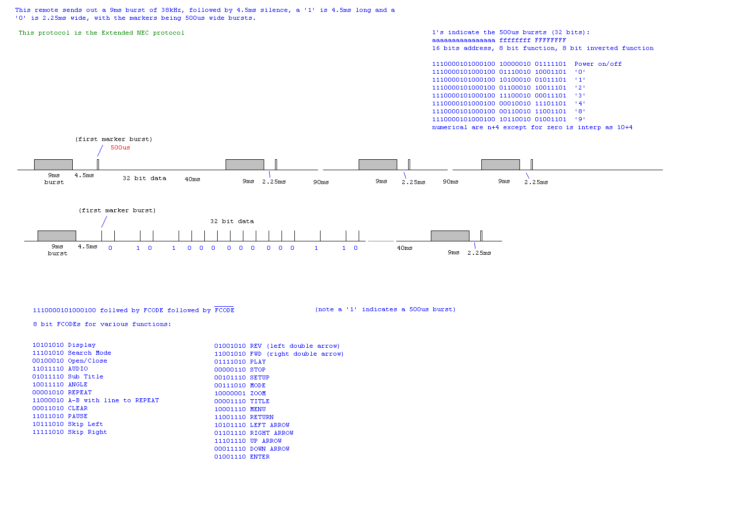

I’m looking to make an infrared protocol converter box for my DVR. Any input will do but I need to output XMP-R 62.16 (protocol used for many of the Comcast DTAs and STBs). I’m trying to find some information about the XMP-R (XMP1) protocol but I haven’t seen anything in my searches. Does anyone know if this goes by a different name? I’ve seen the remote codes provided in hex format for use with various IR blasters, but I don’t understand, without seeing the protocol, carrier frequency, and pulse lengths how to translate these values into a signal. If anyone knows where I could find some information on this IR protocol to get me started that would be very helpful. I’ve been searching for a couple of days but haven’t turned up anything conclusive yet.
Unfortunately I don’t own a PICkit2, I’ve tried tracing the signal with my analog oscilloscope, but I was not able to detect variations between some of the keys being pressed. I did hear that the XMP protocol does not use a header region so the carrier frequency may be more important, although I cannot confirm this yet. I’ll keep looking into it and maybe later I’ll try and record a few of the signals with my scope. Should at least get me started.
You really need a storage scope (or the cheaper PICKit2 option) - where are you connecting the scope? - you need to do it at the output of the IR receiver IC, where you get just the required data.
Well this is the initial results I came up with. I used a reversed biased diode as a receiver and filmed the patterns on my scope. I apologize for the abysmal image posted below but it does show that very slight variations in the pattern correspond to different values being sent. It looks like the gap between the pulses may be changing for some of the similar looking patterns. The first half of the pattern was the same for every signal sent. If anyone has any thoughts on this protocol let me know, there must be some documentation out there somewhere. I have heard that the pattern may contain some toggle bits to check for multiple key-presses, but I haven’t seen evidence of this yet either.
I'll have to see if i can get my hands on a receiver or an IR receiver IC. As this is rental property from Comcast I don't want to void the warenty on the DTA by opening it up. I've already paid them enough money for partially working cable and to render my DVR useless. If the carrier signal is the same, I might be able to pull a receiver module out of an old VCR. While looking around I found these HEX codes for the remote, but I have no idea how to translate these into a signal. I think these are used to program a JP1 remote.

I've used a cheaper scope to detect several types of IR transmissions and was able to decode every button code.
Using those scope pics, you can see that when the pulse is 'up' you can call that a logical '1' and when down a logical '0'.
As you can also see, the codes change when the different buttons are pressed. All you have to do is mimic the timing and you're all set.
Measure the time between pulses and the pulse duration and use that to generate your own pulses using a microcontroller. To start, you may want to just do the 'on/off' key or whatever, get that code transmitted and working, then simply program in the other codes after coming up with a more general algorithm.
It's definitely doable as i have done it in the past with at least four different remotes of varying carrier frequency. BTW, the carrier frequency does matter sometimes because many of the different detectors are tuned for certain carriers and work best that way, however if you get the pulse time right and the time between pulses right you will get the carrier right too.
There is usually a long pulse before the start of any of the codes, but i cant be sure this is true for every single device.
I've done what you are describing with an older remote control for my tv and it worked fine. With the previous remote, the timing for a low or a high were the same, it was just a matter of reading the sequence. With this protocol, it looks like minute changes in the timing between the pulses may be resulting in a different signal being sent. So a 1 or a mark isn't necessarily 60ms and a 0 or a gap isn't necessarily 120ms indicating consistent times for each state. from the picture, several of the signals look the same, but on the scope i can see small differences in the gaps between the pulses.

Pulses are never accurate on IR remotes (or wireless) it's why they use some kind of coding scheme, such as Manchester or SIRC's which ignores small variations.
Like I said, you need to examine the data AFTER demodulation, and compare different key presses.
I first copied a Sharp remote a LONG time ago, using a DOS laptop, which I wrote a simple program for to monitor a pin on the parallel port, and plot the signal as a graph on screen. If I remember correctly?, I used a 16C84, the ony EEPROM based PIC at the time - Windows was either not lanuched yet, or was only Win3.0 or so?.

I'll see what else I can turn up. I've put a pic of the remote i'm working with (bottom left) and the fancier one they sent out as well (bottom right) but from what i've seen comcast is using the same protocol for the following box's. It looks like the remotes are universal and the receivers are setting the protocol. I know the Pace DC50X, Thomson DCI1011, and DCI105 and the cisco RNG110 & RNG200 are all using this protocol. I have the Pace the DCI105 and the RNG110 all of which can be controlled with the same remote. Well i pulled apart a VCR so i'll try to turn my sound card into a scope to see if that reveals any more info. might get lucky if the carrier frequencies match.
**broken link removed****broken link removed**
Alright, so to get a better idea of what was going on, I set up a sound card oscilloscope. From what I can see, the difference between the patterns is a small variation in the spacing between the highs. In addition, there also seems to be a toggle bit, the third bit out of the second set of 9 pulses shifts after an initial period of time. The first image below shows the full pattern being send for the 1 button. The red pattern is the initial pattern sent, the green pattern is the stable pattern after the third bit shifts. The direction of the shift may not be the same for each button from what i've seen.
This picture shows just the last nine pulses for buttons 1 through 4. Again the red pattern is the initial pattern, the green is the pattern after the shift. The variation is much more obvious is the pattern of 1 and 4 are compared.
