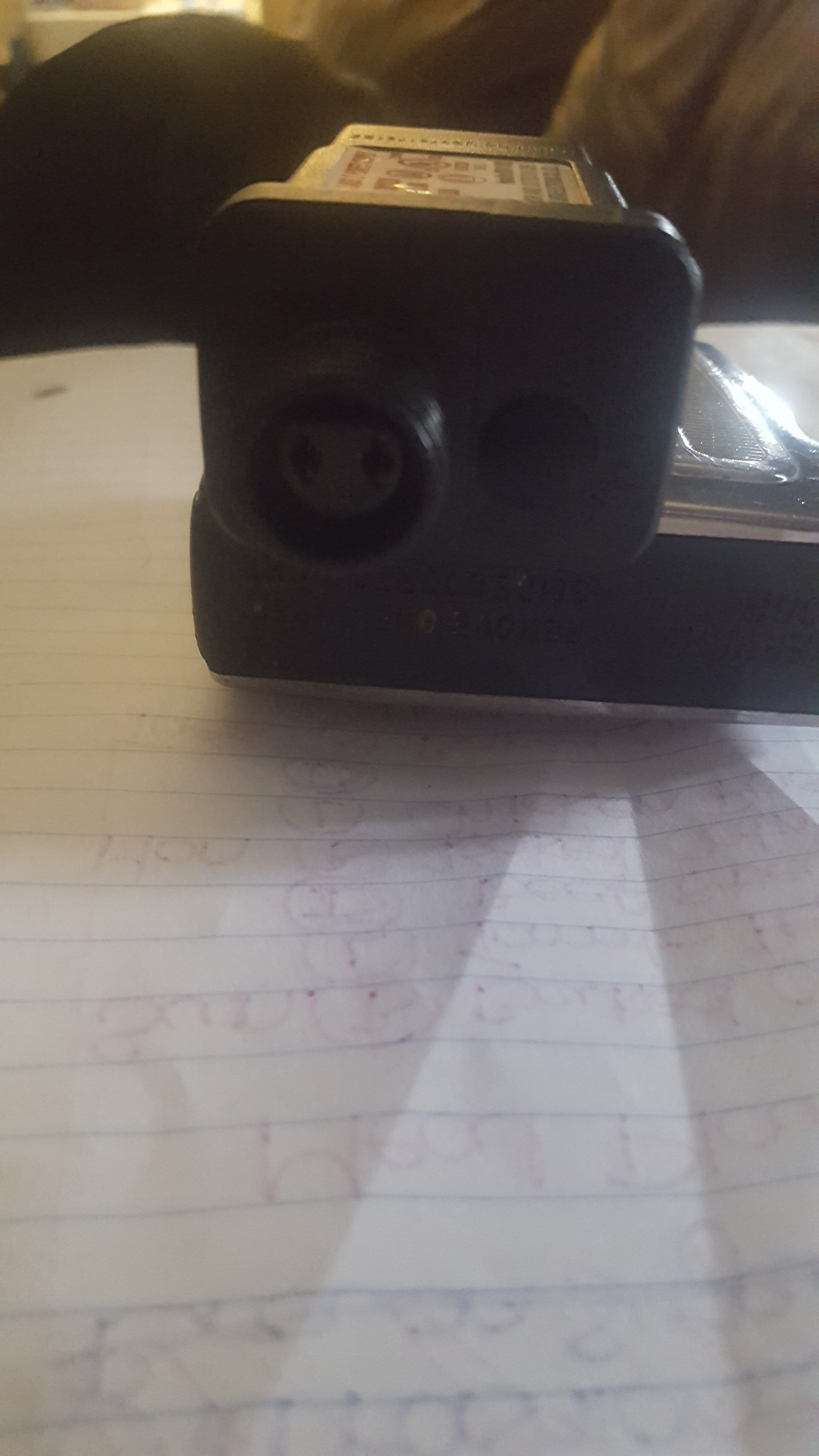

well I got this controller for my xmas lights that has 5 twinkle settings, I enjoy the solid color settings to light my kitchen, but recently it has been switching modes on its own, i am suspecting a faulty button or capacitor, but i cant get it open. I peeled all the stickers off but no screws, I have tried melting around the seal to loosen it up but not getting it to budge either. My next plan is to go at it with hammer and screwdriver but worried that i will damage the circuits so plan b is cutting open with dremmel.
Is there anything else i can try before this last resort?

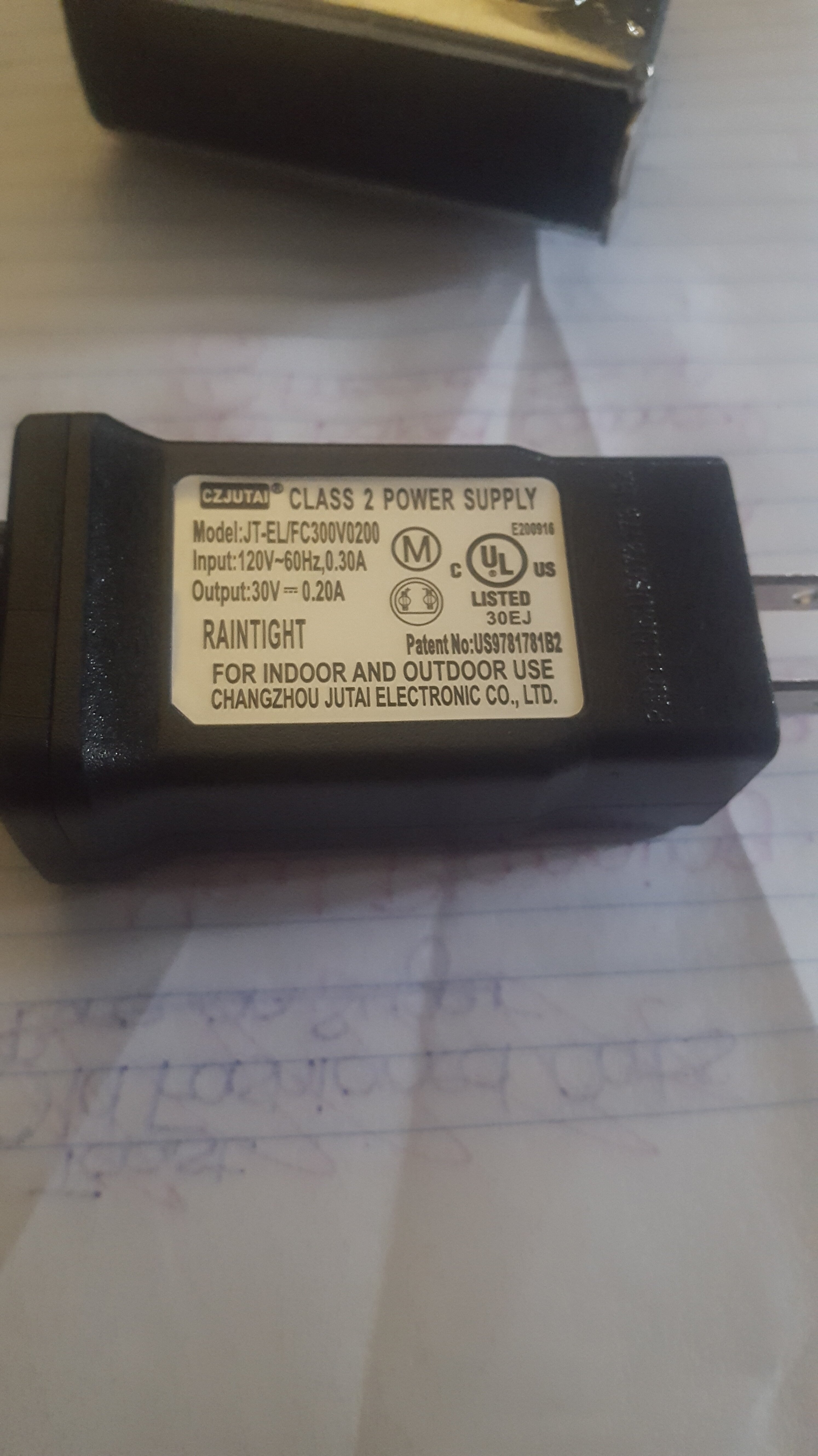

I'd replace if i could but there are 2 pins on output which reveals it is using 30v ac transients to drive the 2 separate strings of lights.
any ideas? since a fail here will cost me 100$ for new lights.
My normal method for opening such things is a normal cutlery knife (as in knife and fork), that has a smooth and not particularly sharp edge.
Put the edge in the joint and tap the back of the blade with eg. a screwdriver handle.
Keep working around the joint and progressively increasing the force until something gives...
Often, the seam will start to split apart at the original joint; otherwise the plastic can crack - but if you have no other option, it's worth a try!

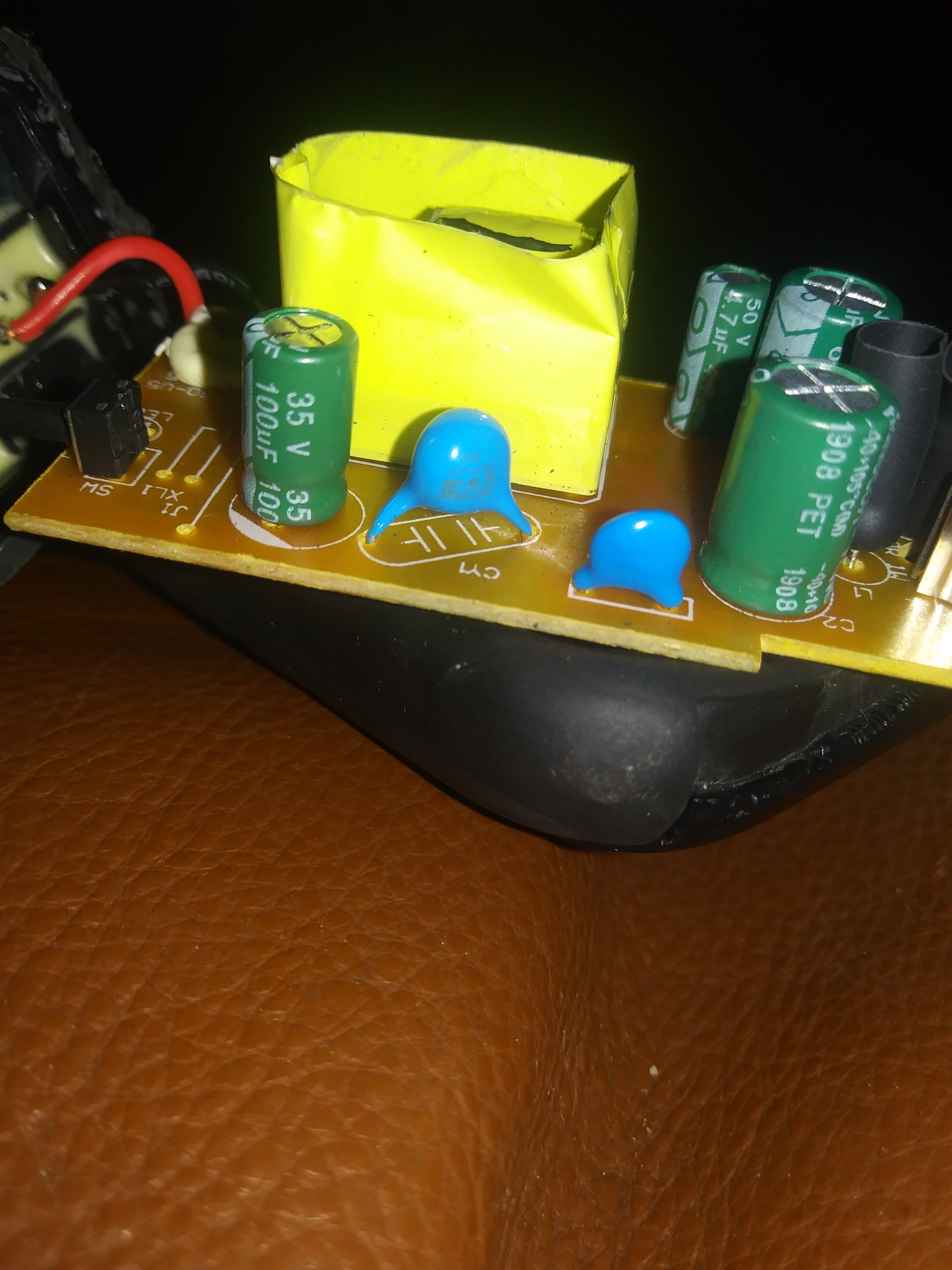

ya, the glue was just too strong , so its been sawed off, and sadly its not the button, based on the issue ima assume that the caps on the right are the power circuits, so im going to replace the first 3 starting from the left,
but both the blue ones say 102, i forget the details but doesnt 102 mean 1000pf? I am skeptical since cy1 is significantly thicker than the other. so i thought i should double check this.?
The bigger one is labelled CY1 - I'd think that means it is a "Class Y" safety-rated suppression capacitor, rather than a conventional cap like the other blue one. The double capacitor symbol also implies it's something out of the ordinary.
That is unlikely to be a cause of any problem, so probably best left in place.
Yes, the blue capacitors are almost certainly not the problem - if they do ever fail they would be visibly damaged, either cracked or burnt up. The electrolytics don't 'look' to be faulty either - although they could still be faulty with no visible signs, that's what ESR meters are for :D
As for splitting the case apart - I've done hundreds over many, many years - as they are glued together, I've found the best way is to gently saw round the join with a junior hacksaw. You could use a Dremel and cutting wheel, but you've got more chance of going too deep and damaging something. Epoxy the case back together afterwards.
