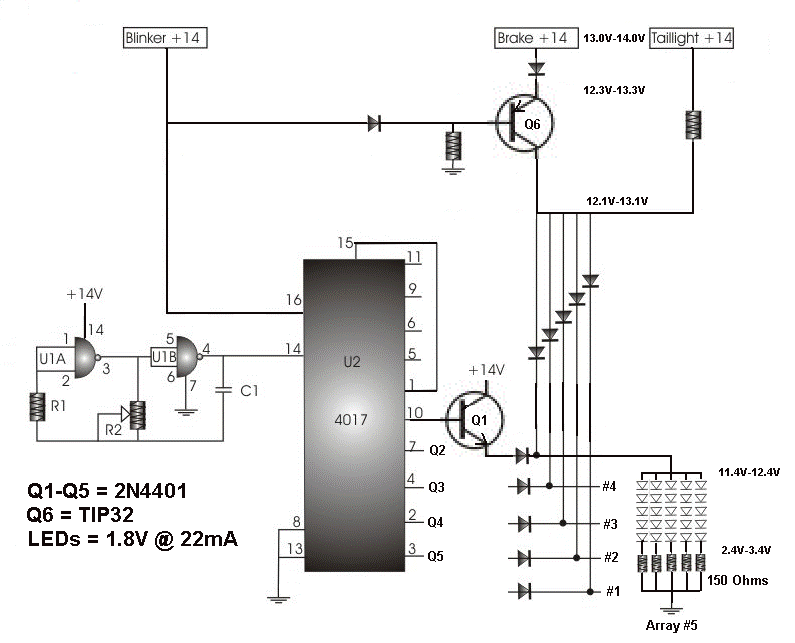

Tryinig to make a custom LED array for my taillights that will function as Taillights, Brakes, and Sequence Turn signal
This may not be the best way to accomplish something, but I'm trying to create a circuit with my limited knowledge of components. I started off with this circuit as a base point https://www.aaroncake.net/circuits/chaser.htm and modified it to this circuit.
My LED arrays aren't 100% decided on at this moment, but most likely each one will contain about 25 LEDs (3.2v~3.6v 20mA)
as for the "red question mark" is there a way to make a transistor or maybe a "NOT" gate that will turn off when it is supplied with voltage?
That's all the info I can think of at the moment. Please help, I could use the learninig experience, and suggestions.
Thanks,
Hi Justin,
The 4017 has a small output current, 10mA if you're lucky. Since each of its outputs is driving strings of LEDs that must share the current, each LED will get only a couple of mA or less without having transistors to boost the current for each output.
When power is applied to a 4017 that isn't reset, it might start counting on outputs you aren't using, causing a delay. You can make a "power-up reset" with a couple of diodes and a resistor and capacitor. Then it will start its sequence on the 1st LEDs every time.
A PNP transistor can be used to switch the Brake line. Power to the blinker circuit will turn it off.
Is it legal to sequence all the lights for one side without also having a separate brake light there?
When the tail lights are turned on at night, the sequencing turn signals won't work. You will need another PNP transistor to switch off the tail lights when the blinker is on, like the Brake line above.
When the tail lights are on, the brake lights will be brighter since they are fed more current. Maybe the brake lights should also switch off the transistor for the tail lights.
You need more diodes to make complete "OR" gates. The way it is now, you are feeding power to the outputs of the 4017 when it is on or off.
LEDs shouldn't be paralleled. Each string should have its own current-limiting resistor. Because each LED will have a different voltage than the others and if paralleled, the lower voltage LED will hog the current.
sweet, this is the kind of feedback i'm looking for. as per your question about legality, that is the way the factory brake/blinker is setup, if you are braking and turning at the same time only the blinker shows on the side you are turning, the opposite side and 3rd brake light stay on at all times however. This diagram would be for only one side, there would be an identical circuit on the other blinker.
Does this diagram look like it can be made to work for my purpose?
Do you see an eaiser way?
What would you suggest for the given LED specifications and assuming there are 25 per array?

i've changed he diagram a little how's this look? also which type of PNP transistor? I assume B would connect to the "blinker" E would connect to the Output, and C would connect to the Brake? but that would be on when the blinker is on right?

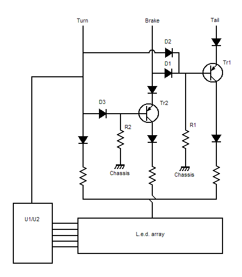

Hi Justin
This should do what you want. It takes audioguru's observations into account, i.e. you can adjust the intensity of each function, turn, brake and tail independently, braking inhibits the "tail" current, turn inhibits both "brake"" and tail" functions.
When only the "tail" supply is on Tr1 turns on through R1 and supplies current to the l.e.ds.
When the "brake" supply is on Tr1 is prevented from turning on (through D1). Tr2 turns on through R2 and supplies the l.e.d. current.
When the "turn" supply is present both the tail and brake currents are inhibited through D2 and D3.
The tranistors should have an Ic max significantly higher than the maximum l.e.d. array current (in the interests of longevity.)
The base resistors .... 1k should be ok.
Hi Justin,
Here's the way I would do it. You can add a PNP transistor to the tail-lights if you want them to shut-off during blinking.
sweet thanks again for all your help guys, I'm waiting on my LED's to come in from mail order. I'll need to go pickup the 4017's and 4011's somewhere also. Hey audio, what is the resistor for in the path between the diode coming from the blinker signal and the transistor?
Hi Justin,
That resistor turns-on the transistor. Use 470 ohms 1 Watt.
The taillight resistor must be determined by how bright you want it. I would use about 36 ohms but it could be anything from 15 ohms 2W for bright to 68 ohms 1/2W for dim.

What? Oh, sorry. I got distracted. 1N4001 or 1N4002 diodes are good in this circuit.
