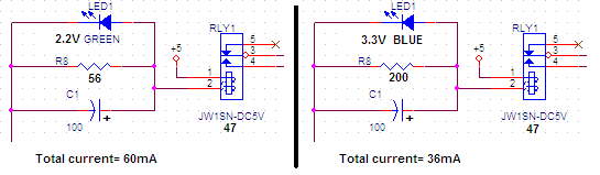

Would anyone mind simulating this simple circuit for me?
I don't have a circuit simulator program and my analog design skills are lax. If anyone would mind running this very simple circuit through a simulator I'm looking for values for R & C so that 20ma flows through the LED when the relay is energised. The circuit is pulled to ground via a ULN2803 darlington array.

I think your circuit is incorrect. You want the resistor to be in series with the LED. You dont need the capacitor. It doesnt even need to be simulated.
Assume the UN2003 saturates at ~ 100mV when "ON", give the relay contact about 50milli-Ohms of resistance.. both of these are unimportant to calculating the LED current. LED might have about a 1.5V drop at 20mA (check datasheet - its based on color) so resistor ~ 175.. so 200 Ohms resistor is fine..

I think the point of the capacitor is to allow enough of a current kick to actually switch the relay, and then when it charges up after a short time the current is reduced to just enough to keep it on. thus the whole energy-saving idea.
Do it like this:

Actually the circuit is from a small article in Elektor magazine. Although the LED will show when the relay is energized it also acts as part of the circuit. It's a power saving circuit, the cap should act like a short till it takes a charge then the LED and resistor limit the current to 20ma to the relay.
I'll find the article and post it. I do recall he mentioned GREEN LED, 20ma, 10 to 1K ohms and 100 to 400 uf for the Cap @ 6.3v
Claims to reduce the power draw to approx 50% or so without using a PWM.
JW1SN family has 5VDC member as shown in his circuit.

I'll take that back. Circuit and shown values do make sense but we won't know
for sure without actual test. I checked datasheet and it does show pickup and
drop out voltages (at least the max values). Coil current is some 100mA, and
this is why resistor was in parallel with LED. With coil resistance of 47 Ohm and
that current of 100mA, voltage drop would be 4.7V. LED will require some
1.7-2.2V to operate and can take 20mA (that's about 100 ohm).
With 120 Ohm in parallel and coil in series, whole circuit would draw some
50mA which could be enough to hold relay. Capacitor size is not critical
(doesn't affect current saving or circuit consumption) and can be increased
if required until relay can pickup reliably.

Don't worry about the 5V relay not working. It is guaranteed to pull-in at 3.5V and drop-out at only 0.5V.
In your circuit, with the 2.2V LED in series with the low resistance (5V, 47 ohms) relay coil then the LED and 220 ohm resistor's current is 60mA. The 220 ohm resistor will conduct 10mA leaving 50mA through the LED, but its absolute max current is only 30mA.
If your green LED's forward voltage is exactly 2.2V then the resistor could be 56 ohms and the LED's current will be a safe 21mA.
You could use a 3.3V blue LED and increase the resistor's value to 200 ohms to reduce the total current even more to 36mA.

In the first moment after the circuit switches on, the capacitor has 0V across it so the full 5V is across the relay's coil, activating it. After a short time when the capacitor is charged then it doesn't draw any current and the resistor in series with the relay coil reduces its current.
