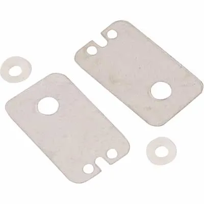

I was taught the quartz clear looking layered stuff formed on rocks at our lake was called mica.
quora.com (Is Quartz a conductor of electricity?):
Quantum mechanics proved that any material that is transparent is an insulator. Furthermore, any material made of a perfect crystal is an insulator, for example: diamonds.
WIKI:
Formica Laminate is a laminated composite material invented at the Westinghouse Electric Corporation in the United States in 1912. Originally used to replace mica in electrical applications, it has since been manufactured for a variety of applications. Today, the product is produced by New Zealand–based Formica Group, and has been since 2007. The word Formica refers to the company's classic product: a heat-resistant, wipe-clean laminate of paper or textile with melamine resin.
Search words :
mica insulator TO-220 <---(transistor case style)
Mica is used as an insulator as pic above.
Formica by wiki explanation sounds like insulation properties.
