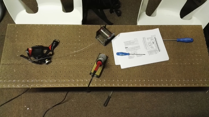

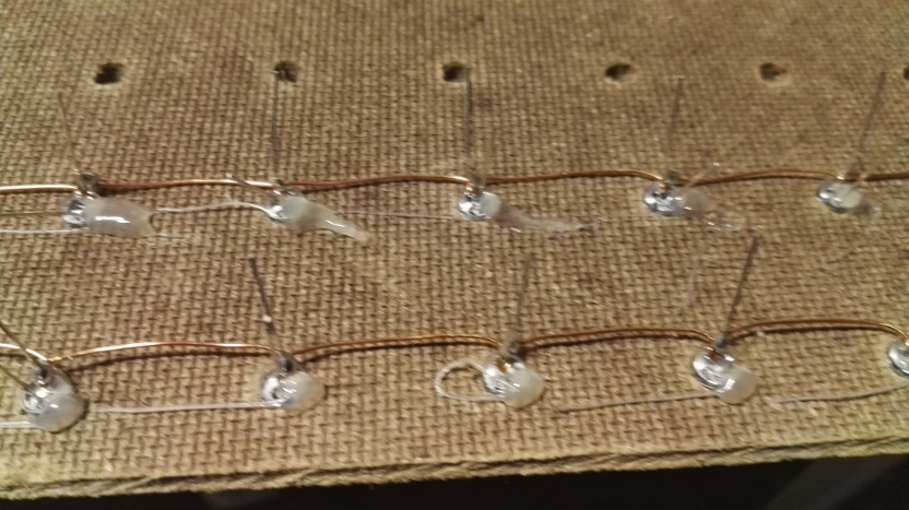

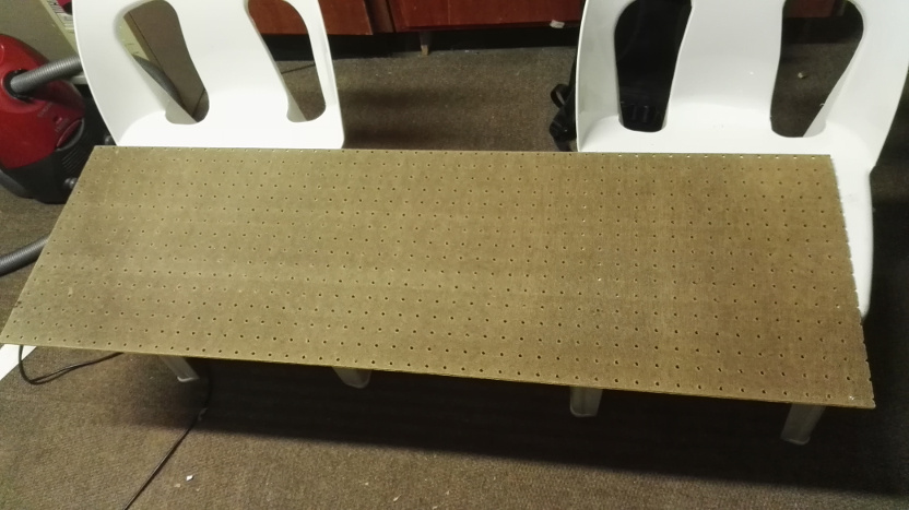

Here is some pictures of HALF the display.
The PegBoard:
The 2 Rows of LEDs populated:
The close up of enamel wire common anode:

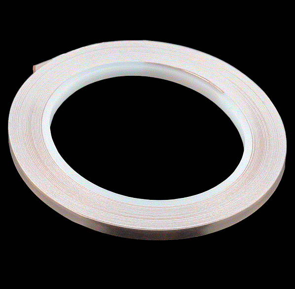

You can also consider using copper tape to "make" connections. You can create the trace needed.
Of course soldering is very easy. Once you have everything solder, then you can paint the copper tape.
