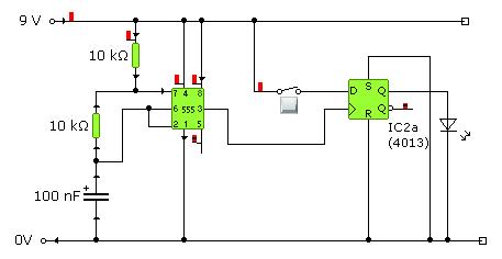

No luck with wiring the timer up. If I hook an LED up to the 555 output I can see the flashing light. If I then put this into the clock input on the 4013, then ground S and R, it really doesn't matter what I put in D, output Q just follows the clock pulse, ie Q is high when Clock is high, and low when it is low, and I get nothing out Qbar. Can someone maybe scribble me a diagram of how to wire this 4013 with a switch controlling input to D and a 555 inputting to clk, with resistors and all, as this has really stopped me in my tracks.

If you connect the D input of a CD4013 to its Q-bar output then it should divide the clock frequency by 2. Then the Q output can drive an LED.
Using a wire as the clock input is not good. The wire can "bounce" and make many contacts and the counter might count them all.
You show your circuit with its resistors and all for us to help fix it.
EDIT: Q-bar connects to the D input for the CD4013 to divide the clock frequency by 2.

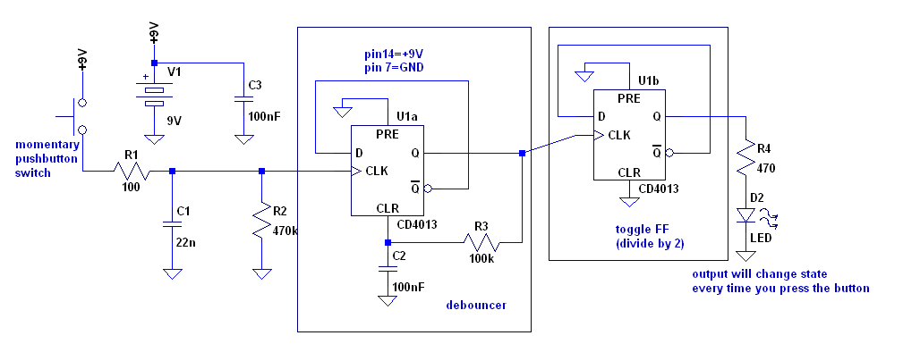

Get yourself a pushbutton momentary contact switch. Build the circuit below.
The capacitor C1 debounces Switch. The first flipflop generates a single short pulse every time you push the switch. The second flipflop changes state every time it sees the pulse on the clock input.
To make the LED brighter, eliminate the resistor in series with the LED (replace it with a piece of wire).

ok, here is the circuit I built. Initially the light is off, then if I push the button the light goes on - I release the swith and the light stays on ...
Bouncing is to do with the signal from the switch bouncing, right? Which wouldn't cause the above effect, or not?

Thank you for your diagram Roff. The problem is I don't understand why you put the resistors and capacitors where they are. I am a complete noob at this, so I need a little pointing in the right direction. Can you explain briefly why you are putting the capacitors and resistors where they are? And why do you have a separate circuit at the top? What does that do?

Roff corrected my mistake before.
With the D input high all the time then clocking the CD4013 makes the Q output high. So it will always be high.
Connect the D input to the Q-bar output for the LED to alternately turn on and off with each clock pulse.
Roff's circuit uses one part of the CD4013 as a switch debounce circuit.
Never leave a Cmos input floating like you show with the D input and the switch open. It must be high or low. Use a resistor for one and the switch for the other.
Sorry, I dont want to see the light flashing on and off. I want to see it on when D and Clock are high and off when D is low and clock is high. At the moment i push the switch and Q goes high .... I release the switch and Q remains high and never goes to low. Is it because 0v in D is not the same as low voltage, and therefore it doesnt revert Q to low? How should I wire the switch to have D low when switch is off? On my diagram should I add a resistor to the 9v railand connect to D?
A resistor to ground at the D input will make it low when the switch is opened. Then the LED will turn off the next time the clock goes high.
