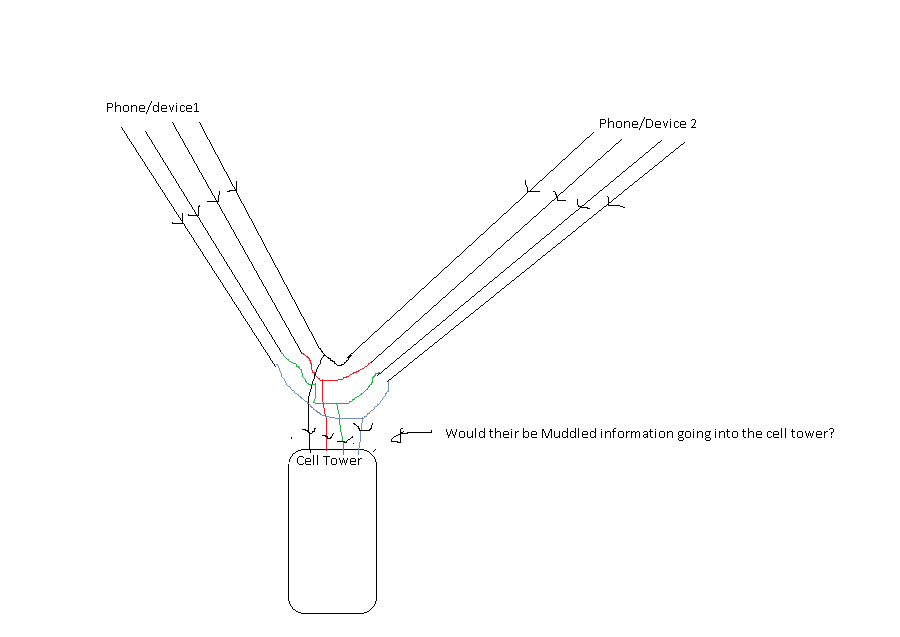

Interfere was the word not cancel sorry! To put it in simple terms, Im a little puzzled to the fact that if two or more devices are transmitting at the same time on the same frequency bandwidth with spread spetrum than how does the receiver sort it out or not get confused?
I've uploaded an image to explain the above post better.
In a perfect SS system that uses only orthogonal codes with perfect synchronization (for the orthogonal codes to be aligned properly to sum up to zero) and perfect balance of arrival power in the signal (the so-called near-far problem). It does not get confused however just because everything is mixed together. Remember about the correlation that it ran? That's how. Correlation very crudely is kind of like what your ears do really lots of signal sources share the same acoustic frequency band to reach your ear, yet you can still separate them out. Correlation lets you pick out the presence of a specific (or similar) signal you are looking for in statistical terms. The fact that the codes are chosen to be orthogonal is to support correlation. Another example of correlation is if you were assigned to someone in a photo and given a giant book of mugshots to help you. YOU go through the mugshots one by one judging the similarity of the mugshot with the photo- that's correlations. Or if you were a stupid computer and had to find a certain object in a photo using a small sample photo. You'd basically take the small sample photo and overlap at every possible location in the larger main photo and judge the similarity. With waveforms, you take the sample waveform and compare it with the incoming signal at every possible single point in time (you basically slide it through the incoming signal in time) and see how much it compares. Correlation measures the similarity between a piece of signal and a sample waveform. If the same signal is hidden in there it matches perfectly. But it doesn't have to be the same signal to have a reading of similarity, that's why we want orthogonal codes to ensure that if it's not what we are looking for, it reads as near zero.
In reality, they can and do interferre. In a spread spectrum system, the greatest cause of interference and noise is other users. This is due to the use of codes that aren't perfectly orthogonal and also to the fact that the arrival of all signals of interest to a particular receiver (tower or handset) must arrive at approximately the same power level. It's much more of a problem for towers since all signals arriving at a tower are signals of interest while only one or two signals arriving at a handset are signals of interest. They also interferre because of frequency reuse in adjacent cells in the cellular phone system but this happens with all transmission methods, not jsut CDMA. There's also the synchronization issue too because codes that sum up to zero no matter how they are aligned with each other are much much rarer than codes that sum up to zero when aligned.
