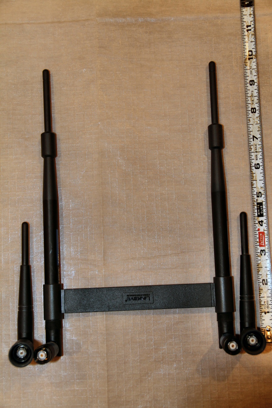

Nope, there is no external power. However, since they say a picture is worth a bunch of words attached is a picture. :)
The original antennas are outboard with the 7 dbi inboard. They are a pair as the router uses a pair rather than a single. The router is an old Lynksys 54G series router. The antennas, like most of the junk piled up around here were given to me several years ago.
The house is an older wood frame construction with no shortage of plaster in the walls. The aluminum siding was replaced years ago with vinyl siding. So what's the difference? With the old antennas the router covered the house well, the router being located on one extreme side in the center of the house. Including the upstairs I had good usable signal. However, outside in the back yard I could not stray far. With the new antennas I can wander anywhere on my property and have really pretty good signal.
I can also sit on my neighbors (across the street) front porch and have signal, not bad. That would not happen with the OEM antennas. I set up the same neighbors WiFi but his router is in the basement (concrete pit). The same router I have and he is OK pretty much in his house but the signal isn't that great, When he uses his laptop it works well in the room directly above the router. Oh his front porch I can hardly get his router. Mine across the street has a much better stronger usable signal.
So go figure? Maybe the longer antennas are rubbed with snake oil? :)

the longer antenna is actually two antennas with a phasing coil between them. it's known as a Colinear antenna. the antenna is made up of two λ/4 radiators, and the phasing coil insures that the signal across the radiating elements are in-phase. i've seen wi-fi antennas using several colinear sections that have up to 18db of gain perpendicular to the axis tof the antenna. the signal pattern is almost pancake shaped compared to the donut shape of a dipole or a λ/4 element.

Thank you unclejed for the informative post. This was something that seemed to work well and I never questioned the "how". :)
I also now am aware that there was no snake oil involved so thanks again for the clarification.
